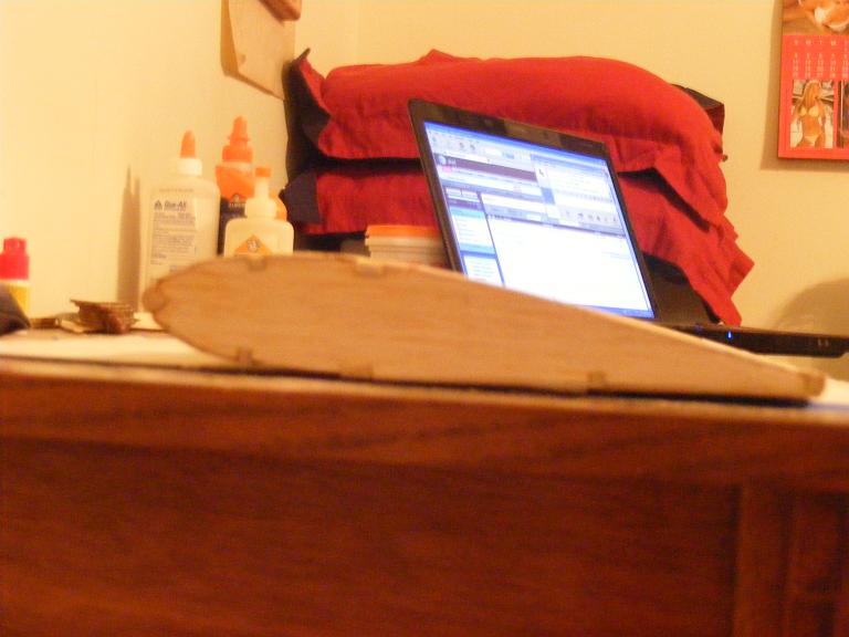

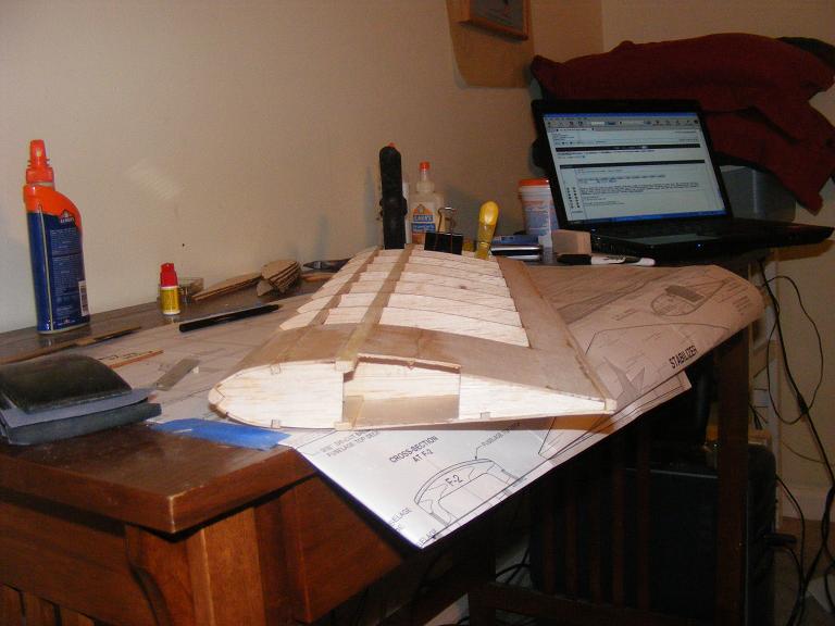

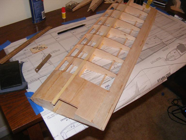

Alrigh! after about an HOUR of pure sanding and getting all the angles and edges right,
Heres the outcome!
I guess all I have left to do on this wing panel is to put on the wing tip and cut out the place for the aileron servo...
Hows it looking!? Im VERY pleased with this wing as it is the first thing i've ever build!
Also in the third picture you can see my question..
there was a little bit of over hang on the trailing edge bottom sheeting.. should I just trim this off?
Heres the outcome!
I guess all I have left to do on this wing panel is to put on the wing tip and cut out the place for the aileron servo...Hows it looking!? Im VERY pleased with this wing as it is the first thing i've ever build!

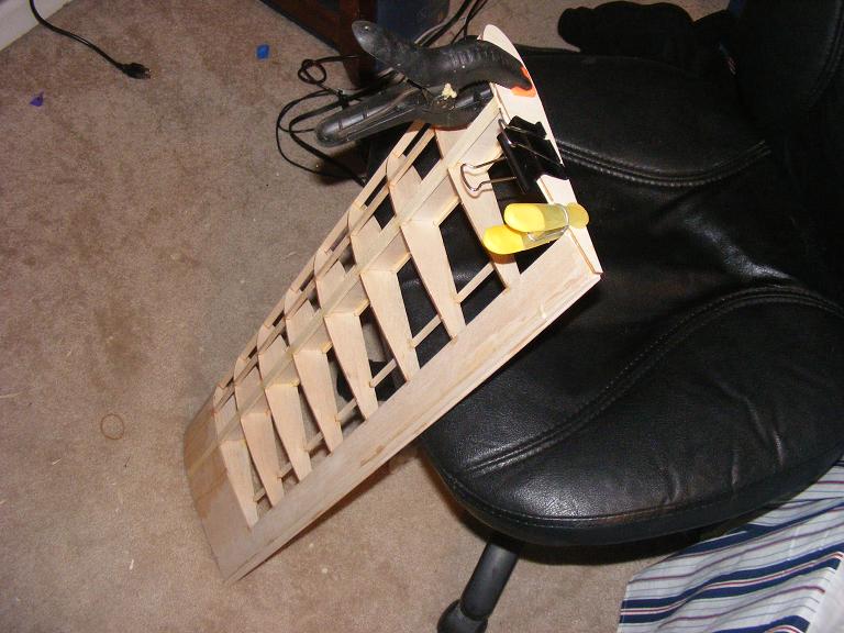

heres the wingtip clamped and drying..
as you can see I only have 1 real clamp
and I know in building, this is probably the most useful tool
Im gonna go out today sometime and buy a pack of them!

Yes-trim it off. If you have a bar sander, lightly go over the edge until true-take your time on this. Carefull on how much you sand, not much material to work with and you don't want to distort anything like Ribs. Fun isn't it?

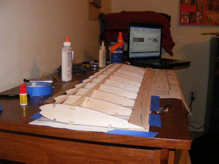

Im enjoying this build so much, I now have all the ribs glued to the trailing edge bottom sheeting,
Much more simple then the first wing, as it's just a repeat and I know more of what Im doing now!
Pictures soon once I get all the ribs and spars in place

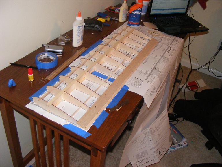

Just to make sure, you did start your second wing panel , over the left wing diagram on the plans ? Common mistake is to forget and end up with 2 right wings half .[

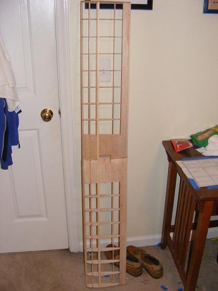

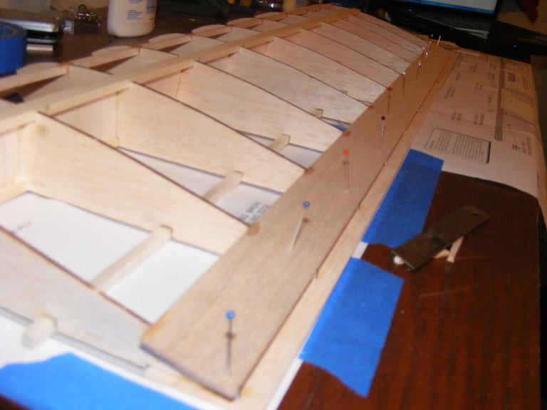

well heres the Left wing panel with all the ribs and spars glued in place
This panels going together EASY!
hows this one lookin?
I'm working with an old sanding block I just found ( working great ) and one clamp, some needles my mom had, razor blade, and of course the GLUE and CA
and yea insanemoon Im doing it on the LEFT WING PANEL plan! that would suck if I didn't!

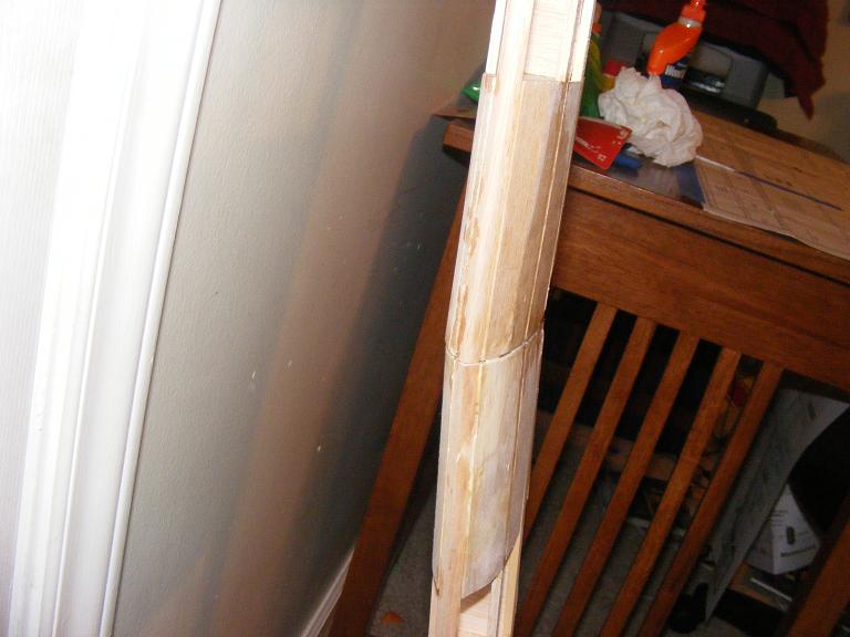

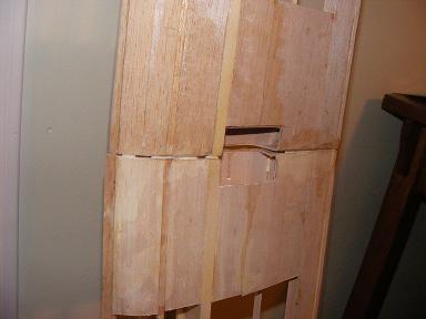

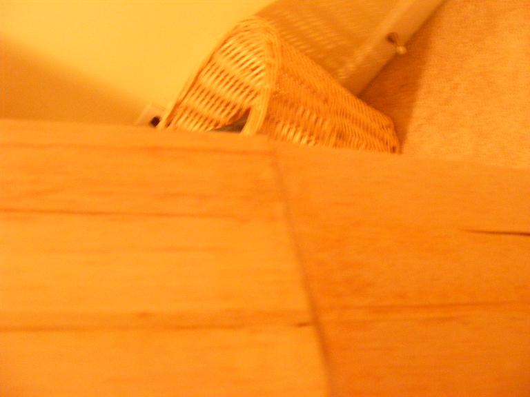

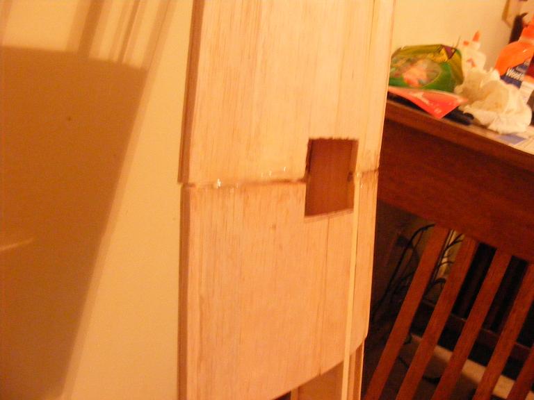

Hey everyone,
got the wings attatched together... had some problems with that
I got everything on the inside edges sanded as even as I possible could but for some reason it just did not want to fit together right, there is a bunch of little open spaces where the wood just didn't meet up
I used 5 minute epoxy and then when I saw all the holes I coated it w/ more epoxy and over the surface with the wood glue, do you think some wood filler or spackling will help me out here after its all dried? its drying now and I felt it and its a pretty strong hold but I KNOW it should be flush...
please help me out yall heres the pictures
I used 5 minute epoxy and then when I saw all the holes I coated it w/ more epoxy and over the surface with the wood glue, do you think some wood filler or spackling will help me out here after its all dried? its drying now and I felt it and its a pretty strong hold but I KNOW it should be flush... please help me out yall heres the pictures

Something isn't right-their should be no gap. Also you should use 30 minute epoxy. Fill the gaps with more epoxy at this point. You will have to use fiberglass on both sides. should try to clamp or tape it tight while drying.

Alright I just put some more epoxy on, I think its gonna be alright
( do yall think it will?)
heres some pictures of the wing drying right now
( do yall think it will?)heres some pictures of the wing drying right now

Put a little at a time in the gap, wipe off excess so its flush with the top of the wing, this way you don't have to sand the stuff and the fiberglass tape will set down smooth and strenghten the joint.
