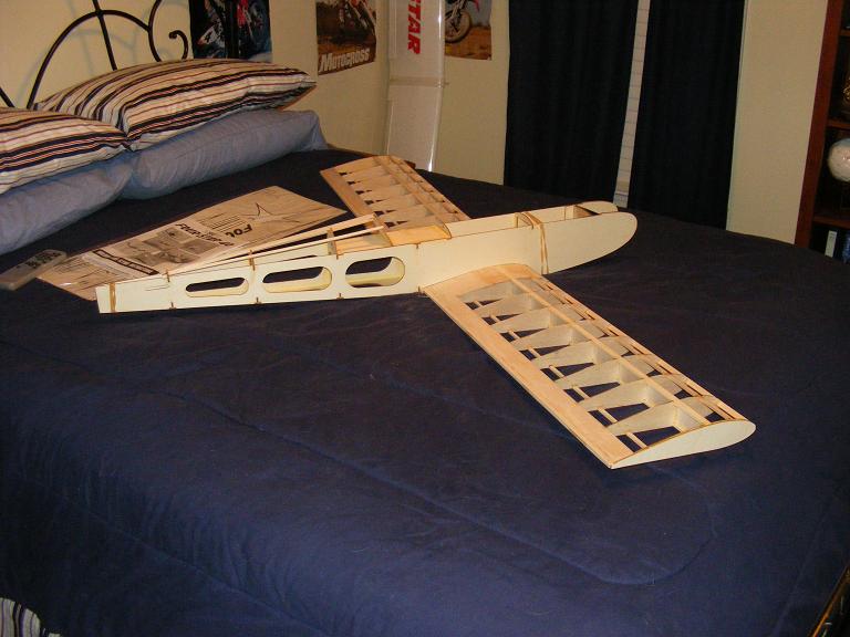

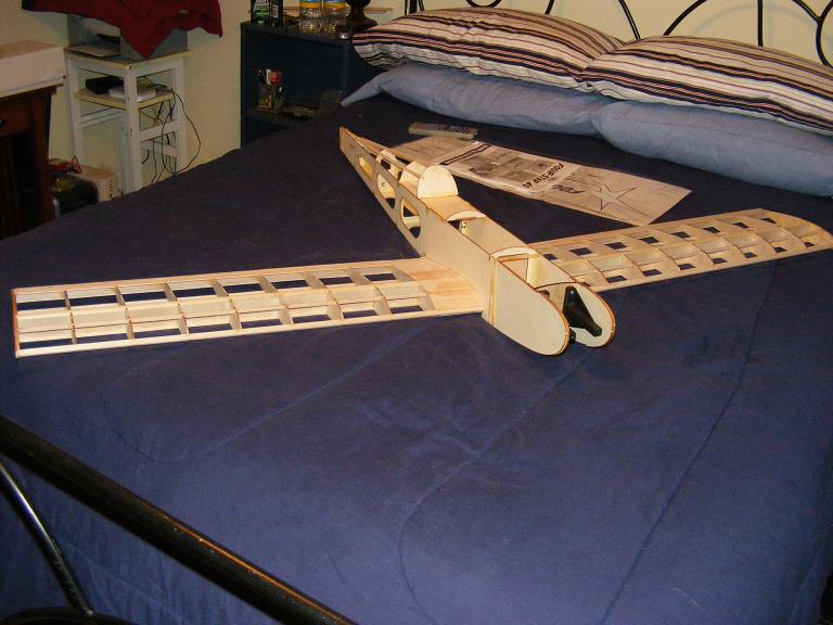

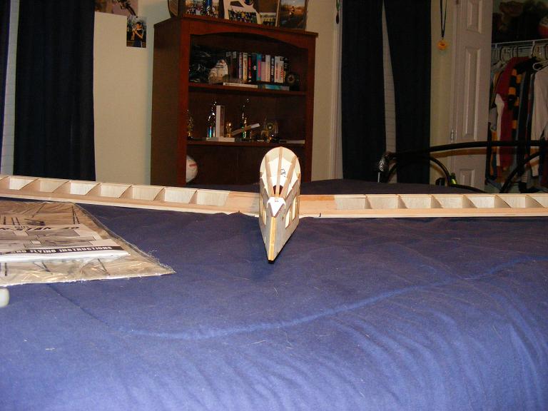

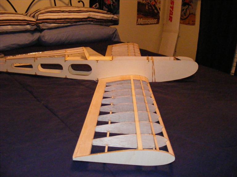

Hey again everyone!
got some pictures of the wing mounted to the fuselage...
Everything seems to have dried very strong
as well as everything looks very straight and true
The wing has fit into the fuselage snug and absolutely perfect

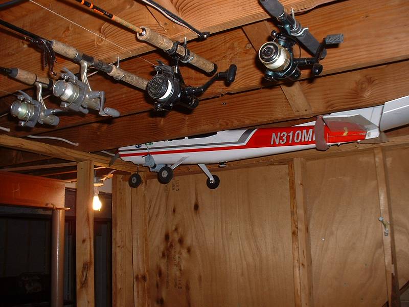

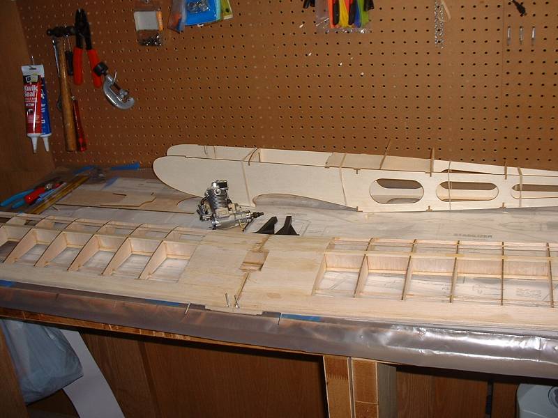

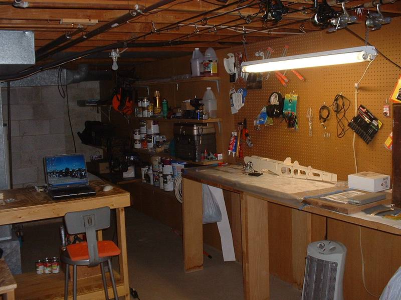

Hey Guys,
I attached a few photos of my work room and SIG project. I recently hung my Nexstar using some chains (from a work light) and a zip-tied rag for protection. Previously that plane was eating up all my work space.
We moved into this house in August and the guy left behind two benches he build. The bench I built is the one with the computer on it.
Last night I mounted the engine mounts but will need to put the 1/4" reliefs in the mounts because the blind nuts did indeed protrude through the F1 assembly.
I also tacked the fuselage joints with thin CA. Tonight I will recheck the alignment and apply medium CA.
Dave
(hopefully the pictures are on this post!)
