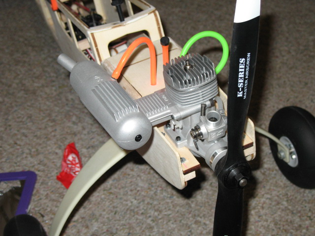

well i thought i should talk about what ive done since my last post. i had a change in thoughts and changed the engine to one i know a bit about im not useing an os .61 fx .ive sheeted the elivator and horizontal stabalizer and soon will do the vertical fin. other then that i havnt done much to it since thoughs pic, ill post pics of the progress as soon as i have them. ive also came up with a nose art for the plane but no sure paint schem.

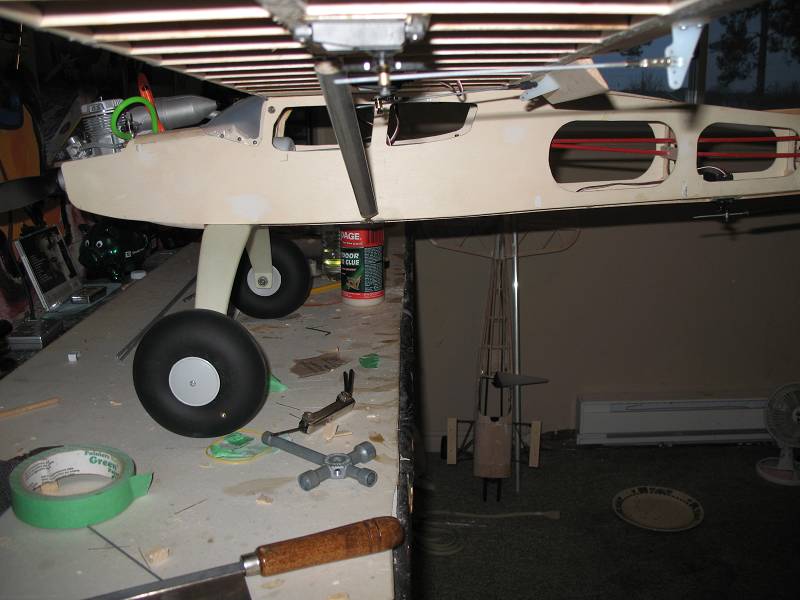

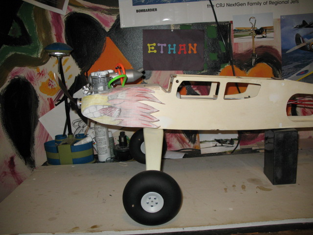

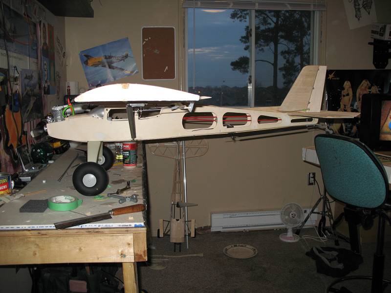

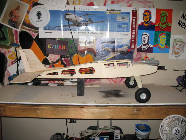

hey gang long time no talk soo i have some more pics sadly im still not covered but i just keep finding things i feel need tweeked. ive sheeted the tail serfeces with thisn balsa but im not trying to get major strength. on the belly of the plane i added 1/16 balsa by the tail wheel servo to make it easer to cover. i have used an os engin i just feel that its a better engin i know some dissagree this is just my personal prefrence, its a .61 fx and it looks a beast. im still waiting on a bomb ralese and sig white silk and stik it witch i ordered from my local hobbie shop.there is also a pic of the nose art i drew up and of my old eagles art any one have i deas on coulor seeing the nose art. well that what i have for know any more pics id love to see modified or stock.

cartoon?

nice nose art.

yee a cartoon i thought the nose looked like a beek and since it was an eagle 2 why not make and angry bird on the front i think im going to name the plane angry cock i was thinking basic silver and d day sripes mabie an odd colored tail and wing tips all is going to be auto paint.

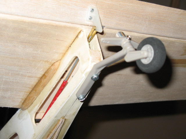

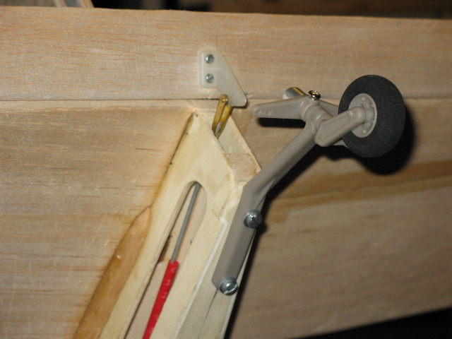

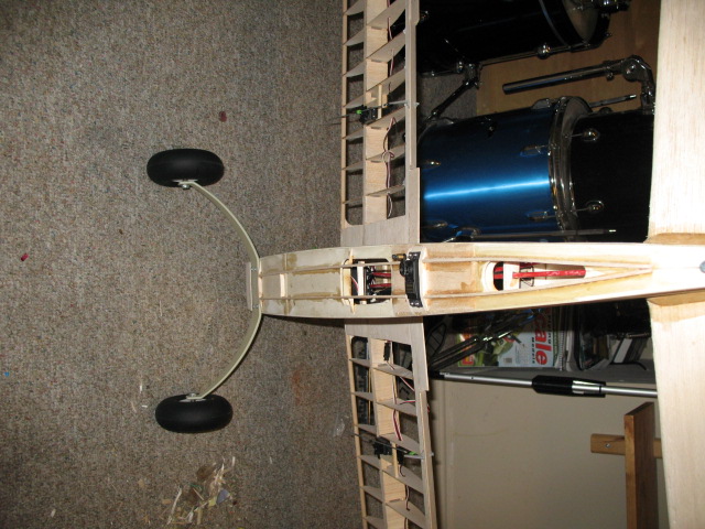

can anyone help me get some more travle out of my flaps i have included some pics. right now its a rounder aleron with pin hingest dead centerand a 3/4 inch long control horn . now how can i increse my travle??????

a longer horn on your servo

Use the robart hinge pins and do the same as a topflite P-47 flap, just download the instructions and follow that, it will allow about 60 degrees of defection, the robart hinges are externally mounted and in a v setup on the bottom of the wing and flap.

i was looking into useing the robert door hinge as a flap hinge. but that might work the only problem i have is the alerons used as flaps are realy thin and i doubt id have anuf room for glueing.

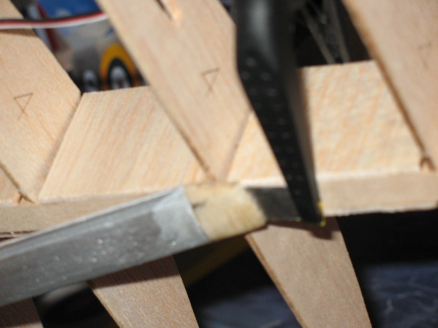

what do you all think of adding 1/32 balsa on the tings leading edge??? im not trying to grab to much strength i just want to pull off a tight rool or loop with out the wings sheering off from stress. oh any one have pics or diagrams of how i can atach struts to my plane??? any help guys and galls......

This is just my 2 cents worth. I may be wrong.
If the wing shears, it will fold near the center, not on the outer wing panel.
By adding weight with the sheeting, you are creating more stress on the center of the wing.
This would increase the chances of the wing folding.
This kit has been around for a long time. I would go with the designers plans.
I had one and it lasted for years. It can take a beating.
If you want to put functional struts on it, go ahead and try sheeting.
Ron

im sure your right but id like to beef it up so it dosnt shift or stress out the spars.

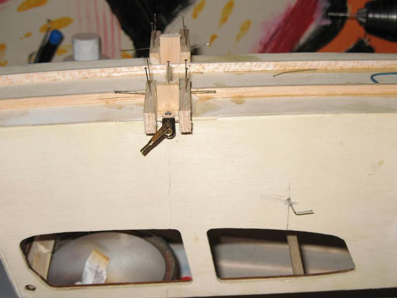

ok ive finished one wing strut but its easy for now on till i have to cover.i went to the local hobby shop and was told how to make the struts stiff and it was easy going. well i cant realy explane how i did it all but here are pics.

well there bplth finished now and it added a substanchal amount of srength but at the tip where i expect to strike the wing once or twice soo i think ill sheet it with 1/32 or 1/16 sheet balsa. i think im going to build one of thoughs sights that acrobatic planes have on the wing tips just for something to do. oh yeah my plane is getting close to 9 pounds will this effect my flight i do have all the extra power and the wings should have efficient lift. oh anyone have drawings for woden skis i wana build a pair for the eagle though it wont see this winters flight? and thanks for following and for the advice

Let us know if the wing struts tend to vibrate or flap as the wind goes over and under them. I'm curious to the affect that the attachments may have. Ron

im courius can you elaborate on what you mean buy over and under ????

The strut might act as an airfoil and air flow goes over the top and bottom. Maybe it will cause a type of flutter.
Toss it around with some of your flying pals. It probably isn't anything to be concerned about.
I liked the way your installation looks. If it doesn't cause problems I may copy the idea from you.
