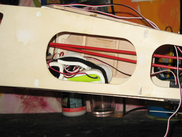

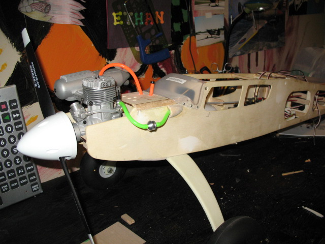

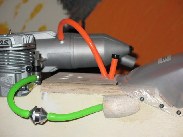

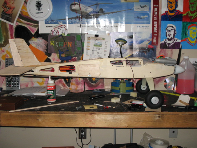

well i moved some stuff arond to compensat a little for the heavy engin in the CG. i moved them back far and i made a door at the rear. i also did some weird stuff with fule line out lets

You are going to have to secure that green line fuel filter. I'm sure you thought about that. Just a reminder.
Did you consider lengthing the wing by adding additional wing bays? I hope you didn't mention it and I missed it in my reading of the thread.

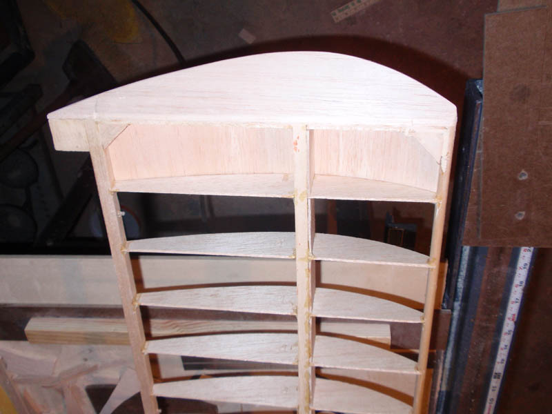

i did think of that i was thinking to extra bays to add something like 4 inched bolthsided but how can i do it while keeping the wings strong anuf for flihgt and with the wings l.e. being a peace of dowl how do i lengthin that. alersons i can just make soo no worries there. oh and i already thoght about the securing for the fule lines but i havent come up with a 100% sure way any sugsetions. at this point this build has gone for sooo long and i just wana cover it but soo much arises that i need to deal with. next kits i think wont be too bashes mabie scale lol .....[8D]
Old 11-20-2008 | 08:12 PM
  #60
Joined: Aug 2004
Posts: 2,263
From: Jacksonville, FL FL
Default RE: eagle 2 mods
I'm not trying to talk you into anything here.
Think it over before you attempt anything.
Cut the wing tip off one and a half bays in from the tip of the wing .... in the middle half way between the ribs.
Take the tip piece of the wing, pin it to the bench.
Now butt all the pieces that you need to build the extra bays together, to the tip that is pinned to the bench and build the extra 2 bays.
Epoxy a length of dowel rod that is one bay wide to the back of the end of the dowel that will be re-attaching to the wing.
Do this to all pieces that you cut off the end of the wing. Not with dowel rods but with pieces like the ones you used to build up the extra bays.
Butt the new end pieces that you have created against the wing that it was cut from.
Pin the wing flat against the new piece and epoxy the dowel rods together and zap the other extended pieces together.
It should be straight and even stronger than the rest of the wing.
It took me longer to write this than it takes to do it.
