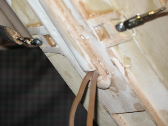

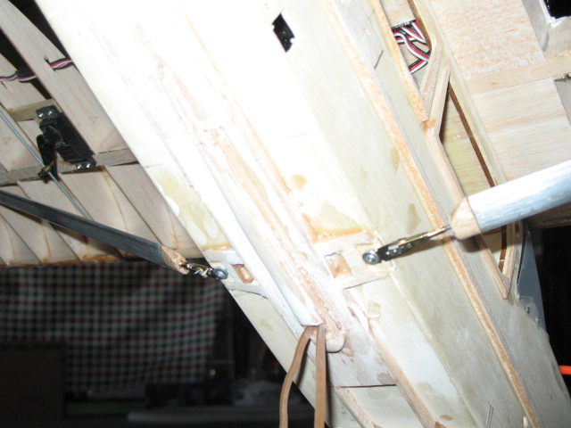

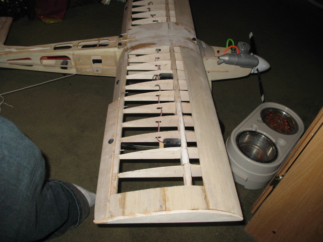

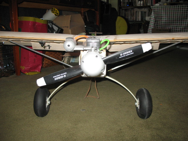

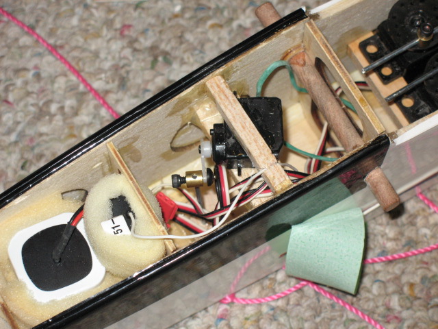

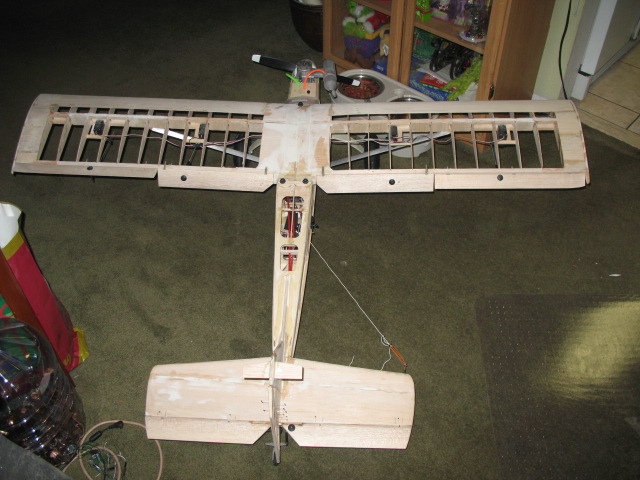

well ive done the structure completly!

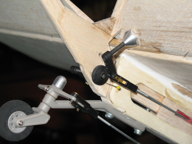

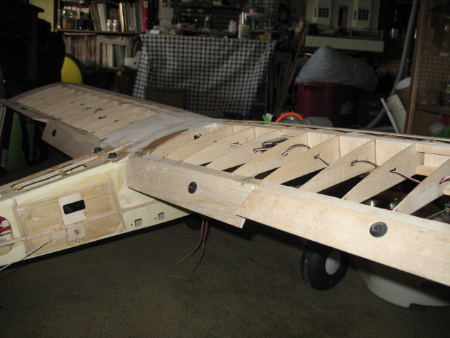

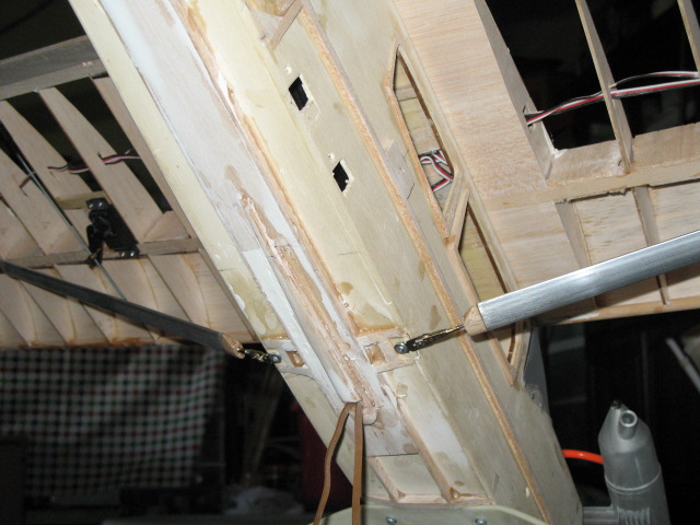

i didnt extend the wings the seem to be long anuf and with the flaps its seems to beable to produce anuf lift and i did add leading edge sheeting and tip sheeting for some sregnth with 1/16 balsa the flaps extend to about 60 degrese . the pushrods have all been all re done and dont seem to work to bad. i have almost as much movment in the control serficesas i did to start i beleave i lost about one eighth. well im just now ready to cover my plane i went to my local hobbie shop and they said the wouldnt be able to get the sig covering soo i will have to order it streight from sig. next pay check i think.i have some pics for you guys to look at just a hole bunch of the finished plane. such a beast of a plane i hope it flys like a real bush plane/towplane

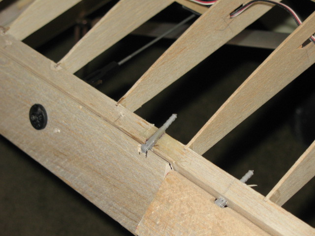

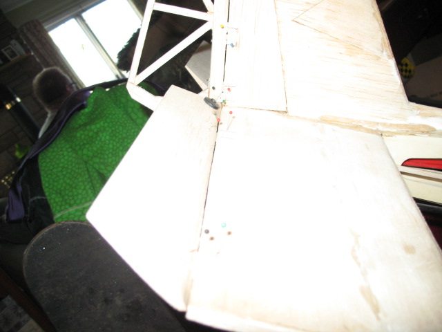

heres some more pics of the plane by the way for the flaps the hing sits just a bit in the rear spar and its epoxied like crazy in soo it will not move and the main switch is in the rear hatch and the two holes in the side of the fuse is for one big vent that will be make after the covering gose on.

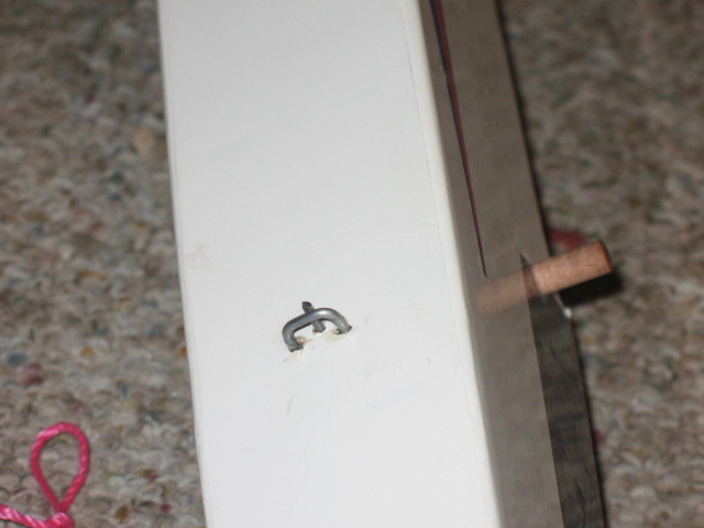

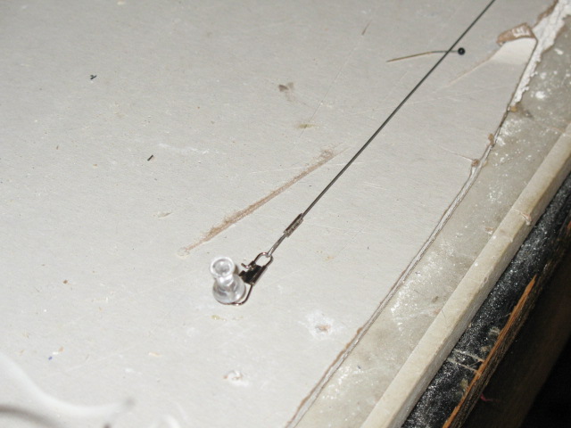

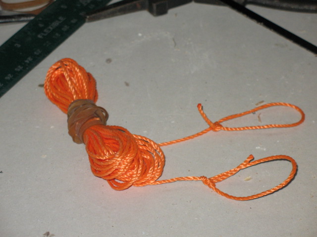

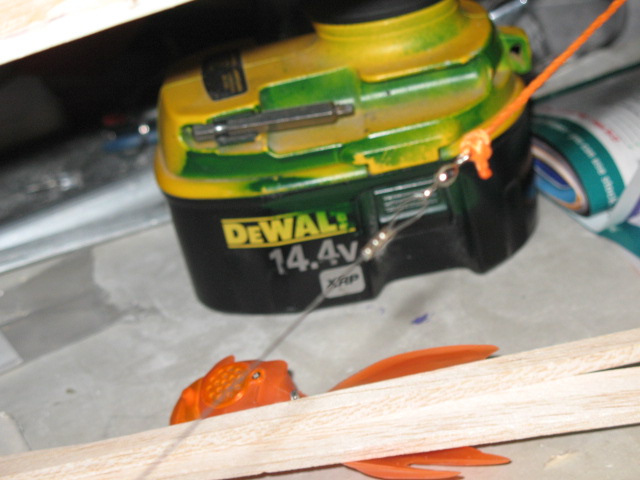

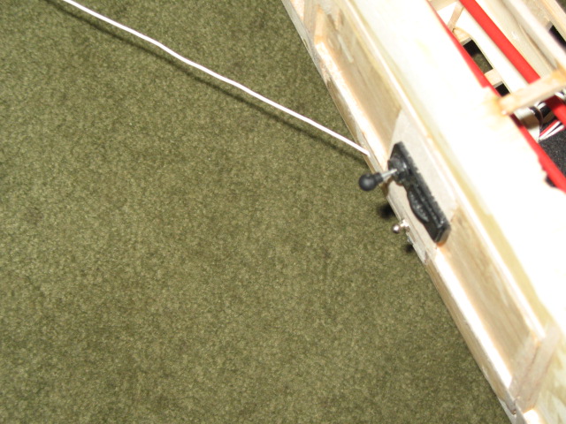

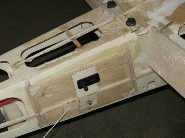

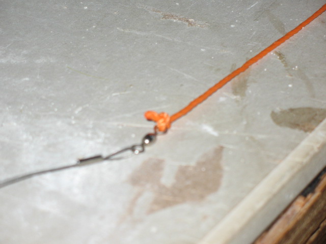

hey alll ive been pretty boared waiting for my pay so i can get the sig covering soo i desided to build an arf i had laying around i beleave its made by tower hobbie i received it in the mail for free no clue where it came from but they didnt want it back and it cost me nothing. i had a three channel controller laying around soo i added a tow rop release out of some 2-56 pushrod and a micro servo looks ok and i cant wait to try it but itll be hard seeing as i am the tow pilot. i also went to the hardware store and got some twine and some fishing whires rated at 30 pounds soo in the case of a hard snag that could damage my plane it will break. ill put some pics on latter. bolth of my glider and my rope.
Old 03-26-2009 | 05:41 PM
  #148
Joined: Oct 2006
Posts: 281
From: Barrie ont, ON, CANADA
Default RE: eagle 2 mods
any questions just ask ill explain
