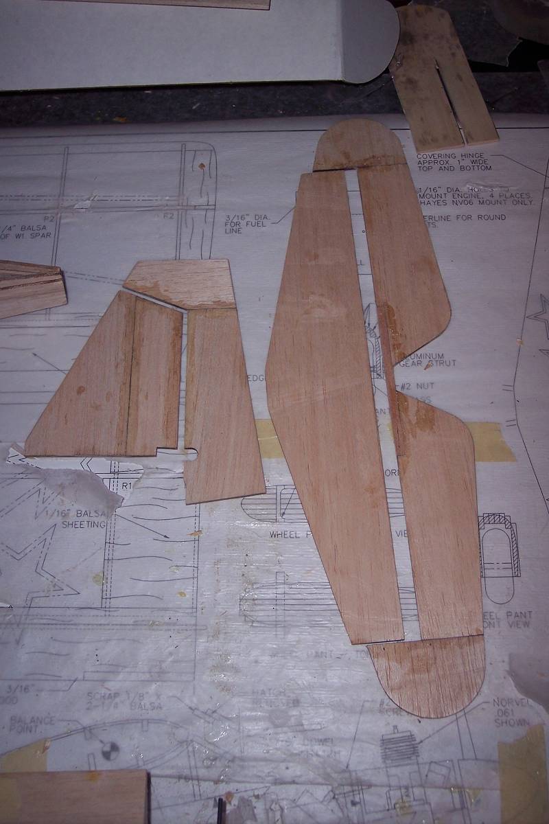

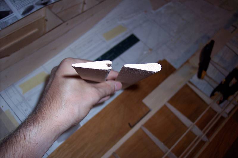

I sanded down the epoxy nightmare on the fins, rudder and elevator. One thing I learned in their construction, do not use T pins on small hardwood strips. I used some CA to seal the split. I also beveled the ailerons.

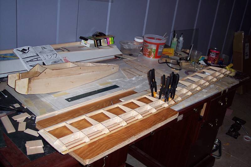

Hey gang, I've been doing a lot more family stuff and building than posting, so its been a bit. The progress to date;

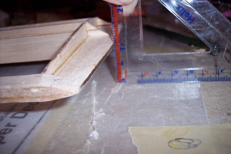

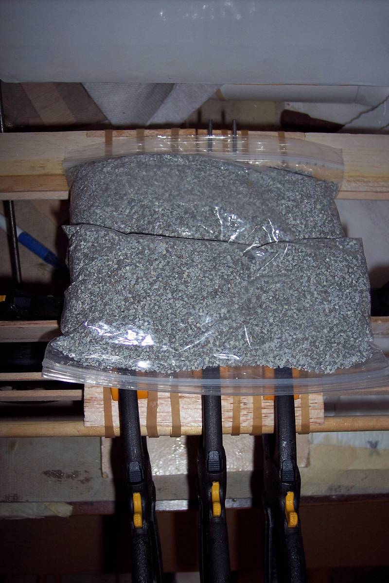

Wing

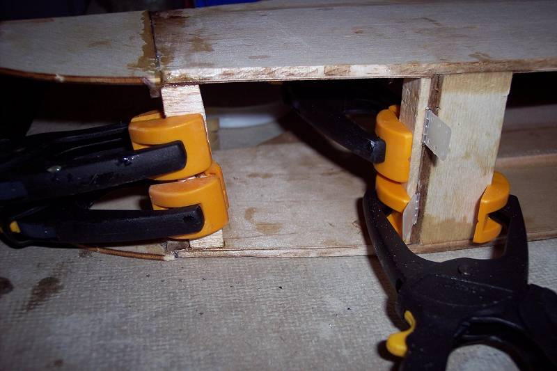

I dealt with the gap between the trailing edge pieces with some epoxy, wax paper and a clamp. I pressed the epoxy into the gap with a piece of scrap. Unfortunately I didn't get a picture of the finished result. I'm sure its added some weight, but there is no more gap.

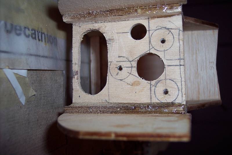

Back to the fuselage. I left off at the firewall.
Having marked and installed the firewall, I was ready to "hog" some of it out. I used spade bits to drill out the stuff I thought was absolutely not necessary. The holes will also serve to vent air past the motor/battery/esc. I didn't remove a lot, but I'm sure it'll help.

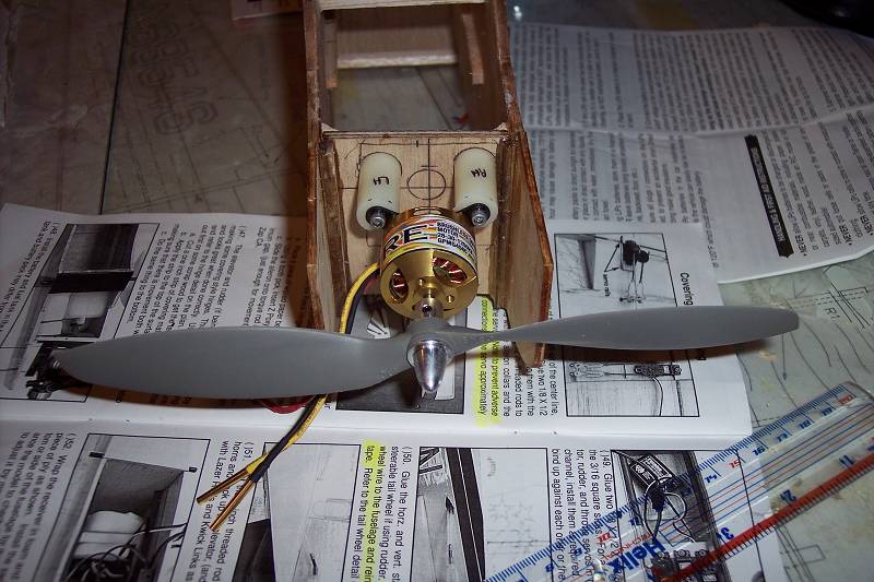

Sorry about the picture not being vertical.

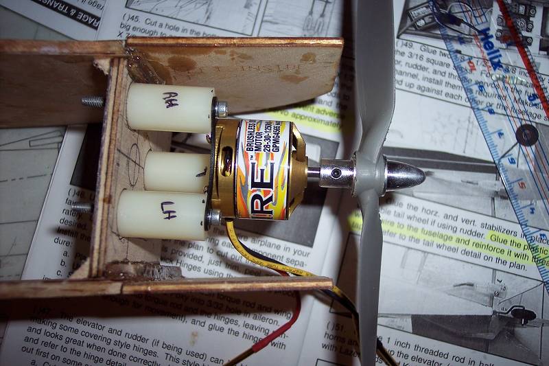

Next I setup the motor mount. As I said in a previous post, I intended to use nylon spacers and bolts to mount the motor far enough forward to have a nice fit with the prop and the cowl. I did a lot of fitting with this, and eventually came up with the length my spacers needed to be. There is a large amount of right thrust built into the model, and its construction (cheeks, motor mount offset, etc) allow the prop to clear everything. Yeah, I know, no kidding. The point is, all this allowed the spacers to be the same length. I used a miter box to cut them. I also fount I had to nip a bit off one corner to allow the motors mounting plate screws to fit. The motor fit near perfect, with the prop exiting the center of the non existent front of the cowl. I also used nylon lock nuts on the back side of the firewall.
I installed the blind nuts prior to gluing in the firewall, and used CA on the back of the nut to secure it.

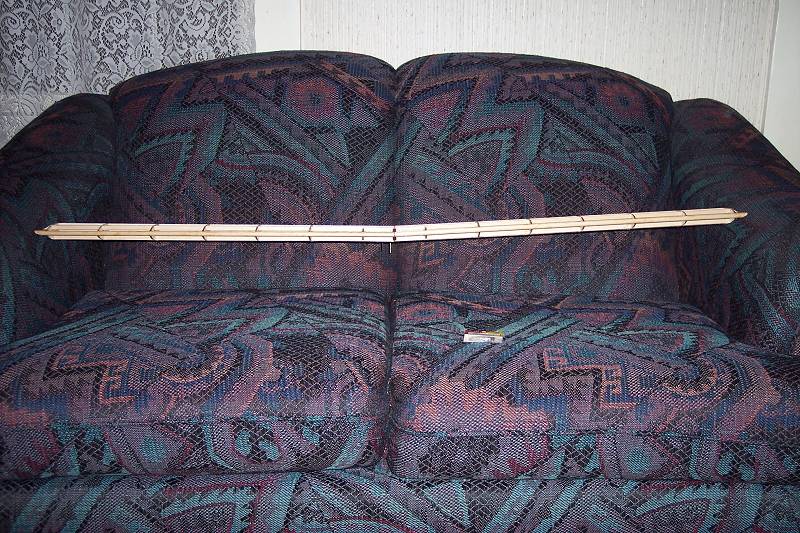

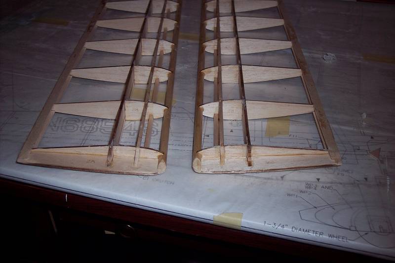

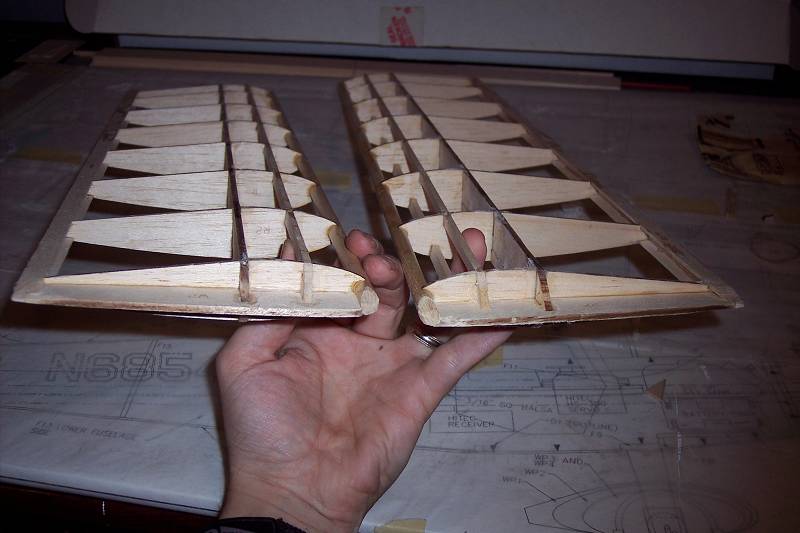

First the question on shaping the wing tips;
Ya know, I didn't really have a good way of doing that. I found that as a bit of a sticking point too. The plans don't really show it, so I just sort of guessed. The supplied wing tip is made of balsa sheet, laser cut to its rounded shape. It slides into a notch in the main spar, inbetween the TE sandwich construction and on top of the LE dowel. I used epoxy for where it touched the cedar LE dowel, and Titebond 2 everywhere else it touched.
I sanded (used a razor saw for the ruff angel on the dowel) the dowel, spars, and TE to match the taper the wing tip would provide to the covering. I'm not sure if this was the right thing to do with the TE sandwich construction, but its what I did. I rounded the corner of the LE dowel. I hope the pictures help.
Also, I think the forward spars were meant to be cut flush with the last rib. Instead, I added pieces of balsa between the forward spars and the wing tip piece.

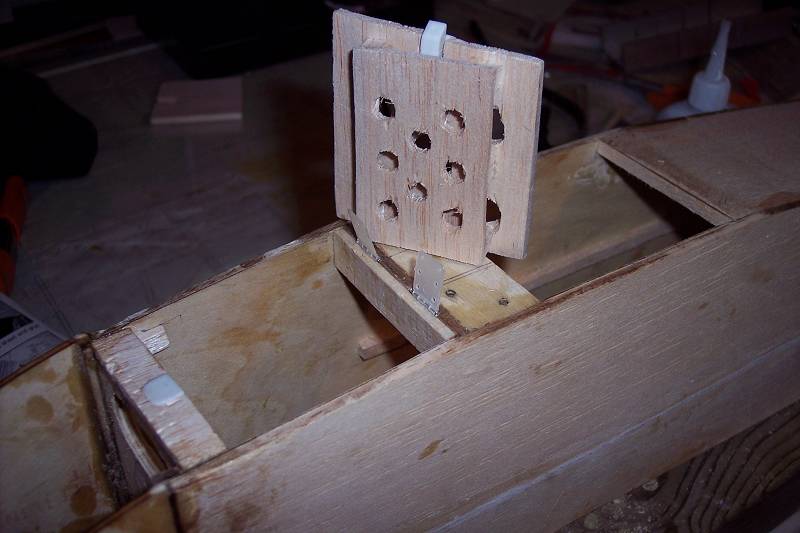

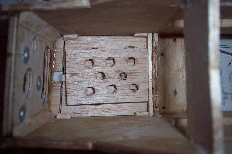

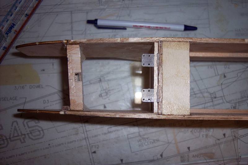

Back to business;
I took the motor and mount off and began work on the battery hatch. I decided on a hatch hinged with pinned nylon hinges (dubro small) and a dubro hatch latch.
http://www3.towerhobbies.com/cgi-bin...?&I=LXD943&P=7
http://www3.towerhobbies.com/cgi-bin...?&I=LXMRK5&P=7
I started by cutting out a new "tank floor" piece, using the fuse as a template. This I made into the hinged hatch piece. The original tank floor sits underneith the firewall and the F1 former (in front of the landing gear block). To make it into a hatch I removed some of it on the aft end where it would be hinged, cut a strip off the front of it for latches "plate," and a rectangular hole for the latch to fit into. Dubro provides a template for this. It'll make more sence when you see the pictures.
Next I installed the hinges on the fuselage at the F1 former. I used extra strips of balsa sheeting directly on top of F1, and in front of it, sandwiching the hinges between the balsa. I glued the whole works in with epoxy. I was very careful about the fit of the hinges (I think some would say the geometry of it), and to not get any epoxy in the wrong places.
a note on the fit of the hinges; the hinges are thicker in the midlle where the pin is. I stuck that thicker piece just over the edge of the bottom of F1 so it would make a nice tight fit. To explane a different way, the flat thinner part of the hinge was placed in the balsa sandwiched onto F1, with just the round pin part of the hinge sticking out.

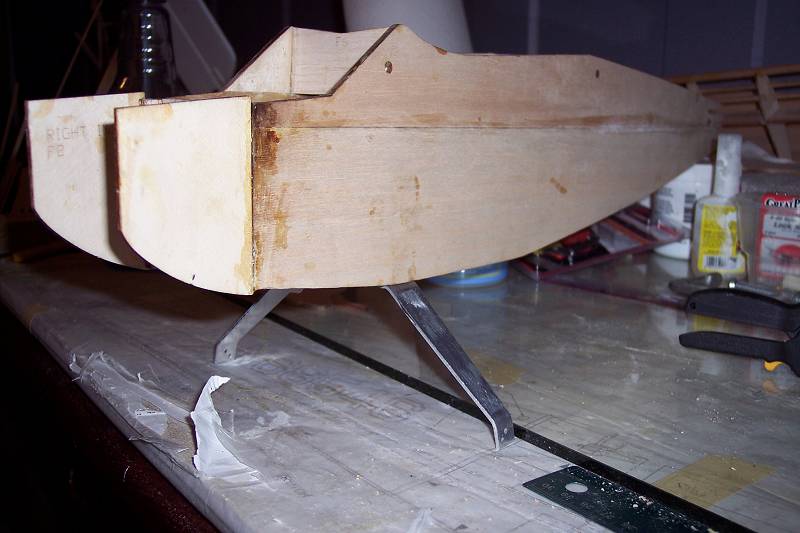

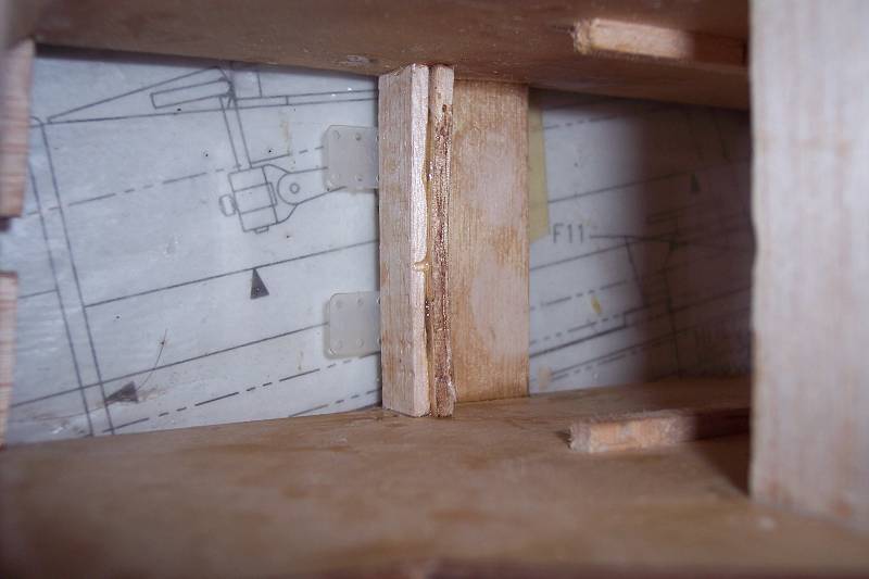

Continueing with the build;
I did install the triangle stock on either side of the firwall as I had planned. I did this prior to installing the hinges and tank floor front edge. I used a razor to split a piece of balsa stick, thanks for the tip Sky Sharkster, and then sanded the triangle stock to match the right thrust set into the firewall.
I also drilled the holes for the landing gear screws, set the screws and hardened the threads with thin CA.

Back to the hatch.
With the Dubro hatch latch cutout made I drilled some holes through my modified tank floor for weight savings. I was not concerned about the strength of the structure as it would later be glued to 1/8 inch sheeting, and the tank floor was made from 3/16 inch sheeting. I also had to make a raised "battery floor" to get the battery over the lip created by F1 and the nylon hinge/balsa sandwich. I used 1/8 inch sheeting. I attacked some balsa stick to make some square legs to raise the battery floor high enough to be flush with the F1 lip, made holes in another piece of balsa sheet cut to size for the battery, and glued in the latch with CA. I then glued the whole works together with CA. My intent was to then put some velcro on this battery floor, which I'll get into when I describe installing the "guts." One more point of interest with the battery floor was that I used a square leg in the middle to help with strength of the floor.
