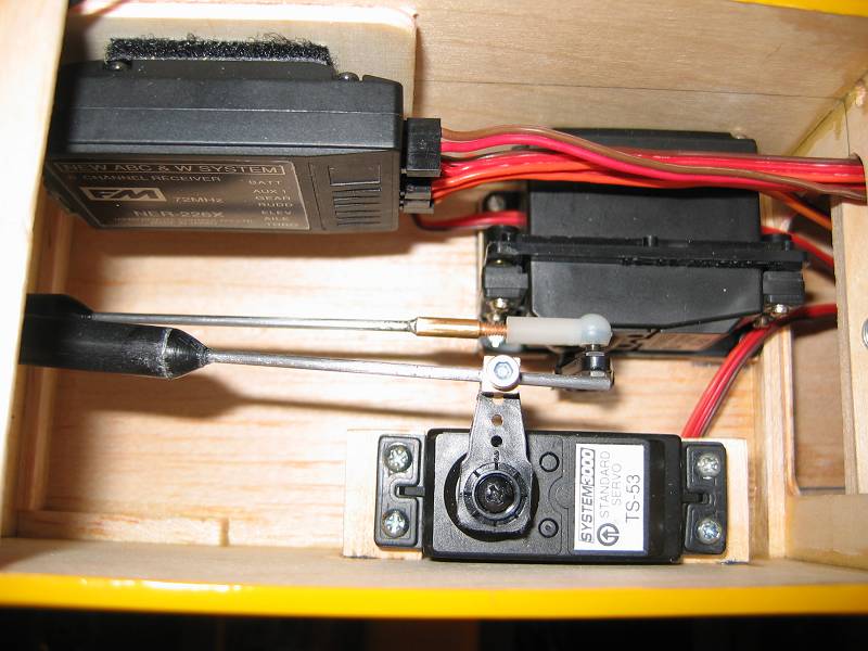

Hey everybody... Just got back into the hobby after a 13 year break. Finising up a guillows 16" p-40 Warhawk and a 20" Piper Super Cub freeflight for building practice. I am covering these with a mix of tissue and coverlite microlite for practice on covering. I have never used plastic covering. All of my previous RC's were BLAHH!!!! ARF's ..... Anyway I just got my House of Balsa .20 43" P-51 Mustang from Tower and am looking forward to the build. The power plant will be an OS .25la hopefully installed horizantally. Using a Tower Hobbies 4 channel trans from ebay for 25 bucks, a GWS 6 channel naro reciever, 2 sg 90 servos for the alirons, and undecied about the other three servos. Any suggestions for this build would be greatly appreciated. Sorry won't go eletric. In 95 the eletric guys were kinda weird and I guess that sorta stuck with me... LOL HaHaHa... Just kidding... but really no eletric conversion for me... Thanks for any replies and will supply pics if interested..

2-56 rods for the aileron control rod run out to u-control bell cranks then A straight shot to the aileron control horns. Then get A 5 year old with small hands to install your radio gear, it gets kinda tight in there.

Yeah it's alot smaller in person I've read somewhere to use a single standard servo for the ailrons but was not sure. What do you think of the sg 90's I've read different opinions, good and bad.

Couple of thoughts for you:
Head on over to the 1/2a forum and root around for building ideas and such - a 43" WS P-51 will seem huge by comparison!
Unless you're planning to setup flaperons you may only need a single servo for ailerons if you use a torque rod setup. I've done this in several HOB kits.
The specs on the SG90s look good, but I've never used them. Hitec HS-81, HS-82 or HS-85s would also work well.
EG

Just for the ease of set up you can use the HT 81s in each wing half to get rid of the torque rod set up. That always seems to be the stumbling block for most new builders to this little plane. Out of the servos you listed it's the only one I have used so I haven't got A clue about the others without looking them up. Getting an engine in that little cowl is another thrill if you want it to look good. I just rebuilt one for A friend this year and made some changes for him, really for myself, I like easy.

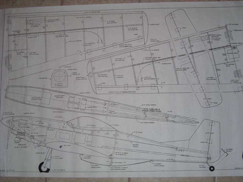

Gents,
would you happen to have a plan for the HOB 43" Stang? If not, even a good quality photo of them would be much apprecaited.
Thanks in advance, David.

I have the plan though I'll have to see about making a copy... Not real sure how to do it yet.... I'll see what I can do...

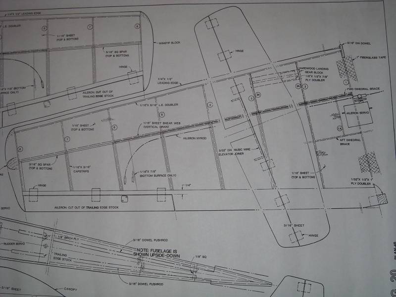

Here you go David I hope these will do...

Just what I was looking for.
Many thanks, David.

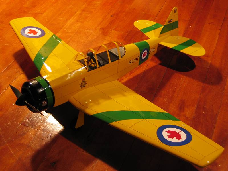

I've considered building one ever since I (almost) finished the equivalent size HOB T-6 Texan. After a little further research, I looked into the electric HOB version of the .Stang as I though it best to stick to my T-6 setup which is electric.
BTW, who's design is it (the original not the electric)? HOB had the habit of putting the designers name on the edge of the plans. The HOB T-6 was, I believe, Rich Uravitch's first design to be kitted commercially!
Incidentally, in the March 2009 MAN, Rich can be seen with his latest model - an electric twin Sky King! Very nice design. RU is old school and designed simple to build and clever scale models. And he still does!
Now it's just a matter of deciding between the Stang and the King!
I'm looking forward to your build!
David.

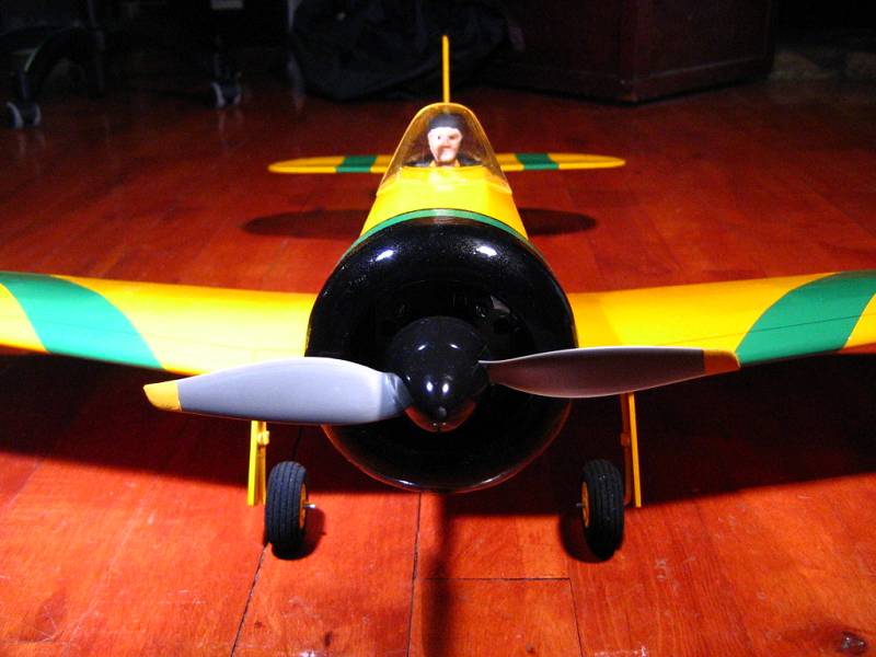

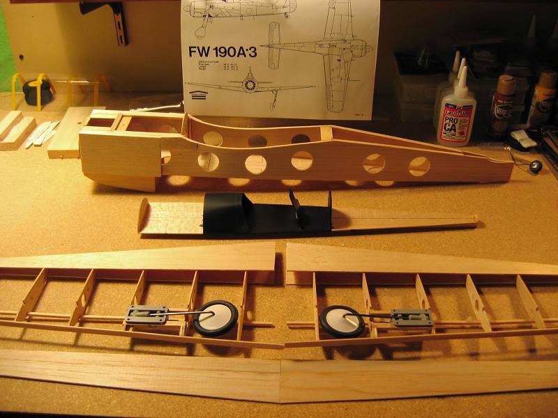

P.S. A couple of snaps of my T-6 in trimmings loosely representing the Canadian Harvard Aircraft Association - Dive Rescue Team (CHAA-DRT) efforts.

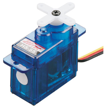

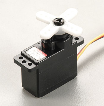

you might find these servos interesting:
http://www3.towerhobbies.com/cgi-bin...?&I=LXUDS3&P=7
I'd put one each of these on the ailerons and one each on rudder/elevator. You can use the servos you have for throttle or use those in the wings and a Hitec HS-55 on throttle. The HS-65HB's would also work nicely all around.
On the .23 powered Deception I'll be using 5 HS-65HB's (ailerons/main gear/elevator/rudder) and 2 HS-55's (throttle/nose gear). I may go with the digital version of the 65's on control surfaces (4 x HS-5065MG) if I can find them at a decent price.
Just some ideas...
David.

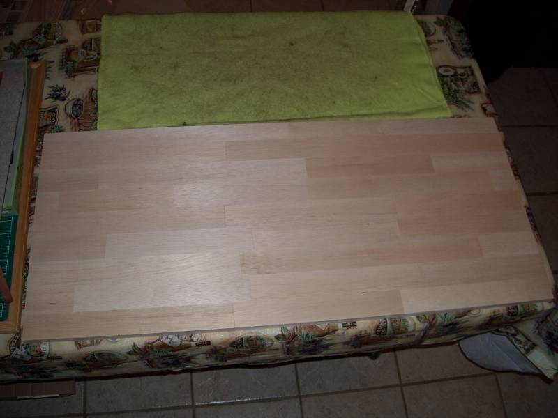

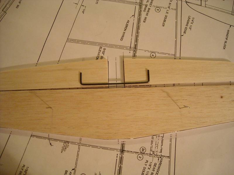

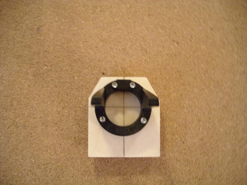

IT'S HERE YEAhhhhhhh.... My building board arrived today...
So first off... on the Elevator, should I bevel the LE before or after I insert the connecting rod??? I will be using CA hinges..
Any suggestions...
David,
I like the servos you showed me... the problem is in my budget... I will probeley get an hs55 for the throttle, use the tp 90's for the ailerons I have a towerhobbies standard I received for free that I will use for the elevator... and I may get a futaba s3114 for the rudder... what is your opinion of these servos...
Pics of the board.. It is the great planes 36 x 16 x 3/4..
Pic of the firewall and engine mount.. did that last knight could not wait....
pic of the elevater...

Old 01-12-2009 | 08:46 PM

Old 01-12-2009 | 09:09 PM
doxilia's Avatar
Joined: Apr 2008
Posts: 5,200
Received 9 Likes on 9 Posts
From: Montreal, QC, CANADA
Default RE: House of Balsa .20 Stang
Tommie,
nice board! The servos you have in mind should be fine. Futaba and JR tend to be more expensive. You could certainly use standard Tower servos on the empennage and an HS-55 for throttle.
Re the elevator, first make the holes at the right distance, then notch the LE of the inboard sections to countersink the rod. Roughen the rod up, stuff some epoxy in the holes and slots and cover the rod (except the exposed middle portion. The assemble on the plans insuring that the spacing is correct and put some weight on the assembly to make sure it is absolutely flat.
Once done, you can then hinge the elevator to the stab. Again, absolute centerline by drawing two lines on elevator LE and stab TE. A simple slot with a #11 will do for the CA hinges. You can later drill a small 1/16" hole in the center to allow the CA to flow when the time comes. Once everything is hinged, flat and symmetrical you can then bevel the elevator LE to 45 degress about the centerline. Stab LE and elevator TE are then rounded and everything sanded smooth. Done!
Rudder/Fin - same process. Ailerons much the same.
David.

thank you very much.. your help is very appreciated...
For the absolute center I am using a hinge marking tool... and I have measured and marked the location of the rod and hinges...
I don't have any epoxy yet... tommorow or wednesday I will be picking up 5 min and 30 min from Hoby Lobby craft store... I did not expect to get the board today.. but excitment is making me check and recheck all possiable next moves... I'll go ahead and notch LE for the rod and make my hinge joints... I'm already checking all the wing instructions and getting the ribs sanded and ready...
Once againg thank you for your help...
Tommie

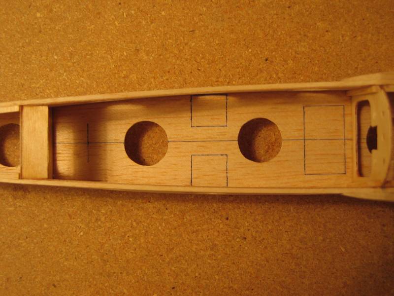

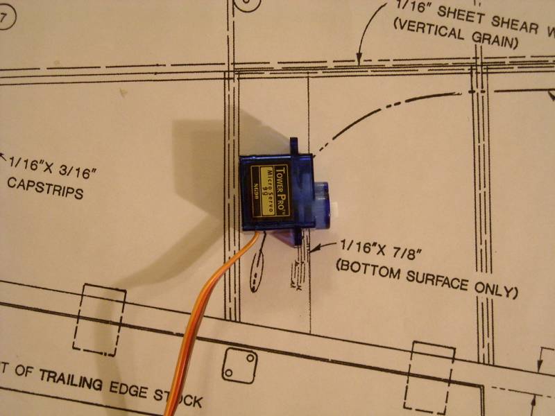

Next question... Should I mount the aileron servo horzintal or vertical??? Or does it really matter??? The plan only shows using nyrod..
Lots of questions... any comments welcome...
