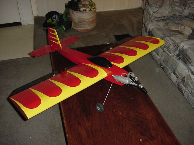

Old 06-07-2003 | 02:10 AM
Posts: 554
From: Beaumont, TX
Default Uproar 40
No complaints here with the Uproar.I've only had the 40 size,not the 60,but the kit was ok with me and no problems. I've had two and getting another. I'm thinking the hardware came with it,even at the low price.

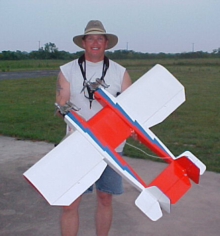

The Uproar .40 is a great plane ! I too lost mine but now I'm building the .60 size and it looks to be a pretty cool plane as well.
Old 06-08-2003 | 03:08 AM
Fubar-One's Avatar
Joined: Mar 2003
Posts: 1,774
From: Canyon Country, CA
Default Re: Tower Hobbies Uproar 40 kit ?
Originally posted by Elric
I am looking to build a quick, cheap 3D plane to practice with. Has anybody had experience building this kit. I`m sure for the price It doesn`t have much hardware, but how is the overall quality? How about flight characteristics and weight? Power combos? Any input would be very much appreciated. Thanks!
Elric
Built mine using HS225MG servos and an OS .32SX for power. Plane flies pretty quick and with the throws dialed up, will roll like its mounted on a giant Makita.
Im kinda weird and usually get an engine first THEN look for something to mount it on. Got the Uproar kit to build while the wife was out of town. Figured it would keep me outta trouble.
Great building kit and a joy to fly. Only thing I would do different would be to mount the engine sideways to put the muffler underneath. Tends to get a bit slimey.
