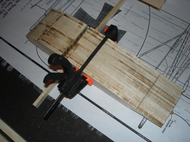

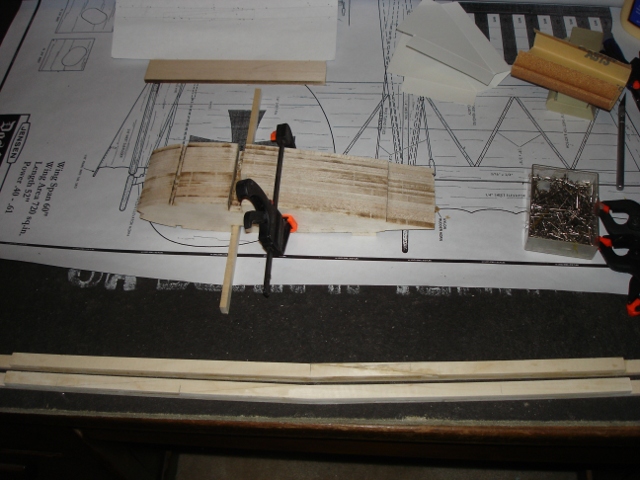

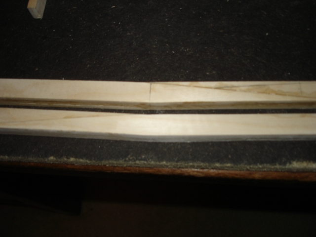

My plans show the main spar and spar doubler with a long splice joint you glue up before building the wing. If I want to change the dihedral, I have to modify this joint. This joint takes advantage of the six degree dihedral and the splice follows that six degree angle.
1. I could just butt join the two wing halves like many other planes and add a dihedral brace.
2. I could make the splice twice as long to accomodate a reduced dihedral.
3. Or, I could modify the joint somehow to work with a lower angle.
I decided I could cut one side just like before with the six degree splice, and then cut the other side with an equal length three degree per side point. They then fit together perfectly at half the angle.
Diagrams below. The first one shows the original six degree cut used on both sides. The second shows one side with that cut superimposed with the other side cut to a point.

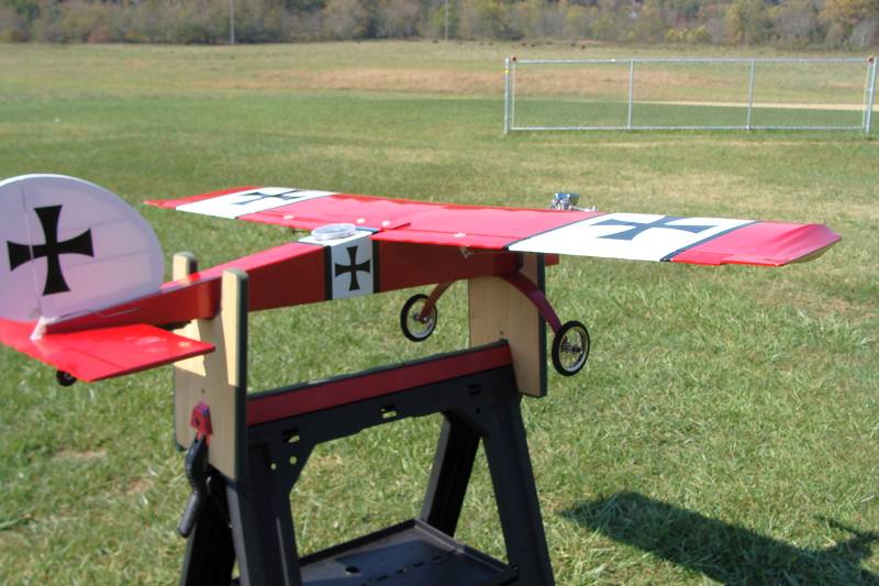

Here is a pic of my Arf with a Saito 82. This a GP 40 size
You can see how much or little Dihedral it has.
Bob

Looks like zero to little diheral at all on that ARF.
Apparently, the Ultra Stick has zero as well.
So, on the Ultra Stick, besides losing what little WWI design elements the Ugly Stick had, what did they change?

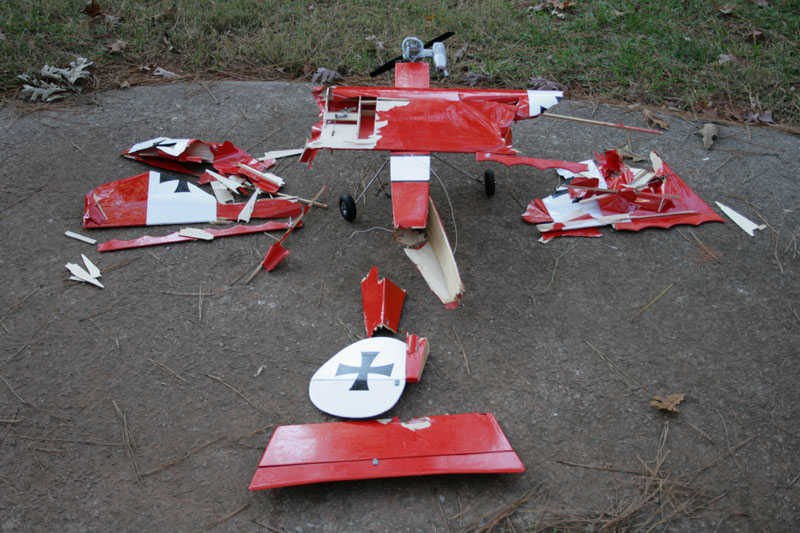

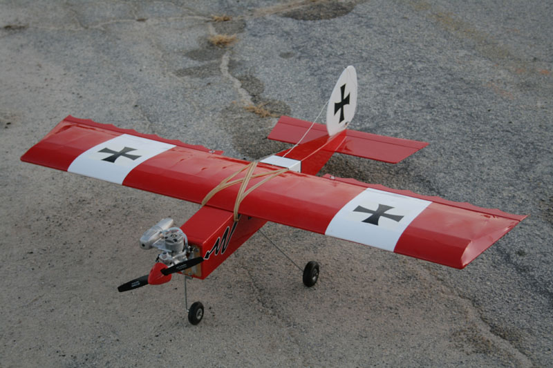

I just looked at your opening remarks again and am impressed at the amount of damage you were able to impart on that Stik - very impressive indeed. That must have been one wicked crash.
-MA
-MA
Joined: Jun 2008
Posts: 428
From: , GA
lol, yes it was.
Long story on it, but it ended up going into the woods at full throttle. It must've hit at least two or three branches on the way to the ground.
However, on the positive note, radio bay was completely intact, and the engine looks fine. The prop only had a small chip in it.

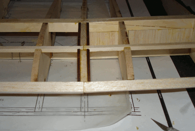

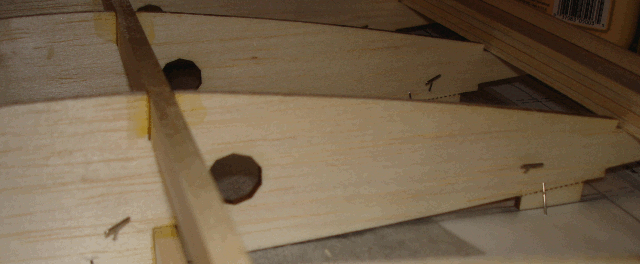

OK, I finished epoxying the main spars with the 3.1 degree dihedral. I've been reminding myself this means I won't have that big "gluing the wing halves together" task later on because of this.
The angle looks good to me. To me, no dihedral on a shoulder wing plane makes the wings look like they are hanging down. This looks like enough to avoid that without making inverted flight too troublesome.
I pinned the spars down to hold them together on the first one. I tried clamping the second one as well, but I think the pins alone are fine.

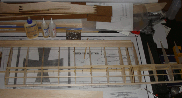

Next step was stacking up all the laser cut ribs and knocking the burn off them.
The plans suggest creating a "custom" build table out of two sheets of plywood - one side propped up by six degrees.
I'm thinking I'll just build one half of the wing, then prop the other half up while I build the second half. This means sliding the ribs between the two main spars on the second half, but right now, that doesn't sound like a big problem.

I'm also well into the wing build. The ribs I have are tabbed, so to take advantage of them, I'm building the front half of the wing first. I then plan to cut the tabs and rock the wing back onto the rear sheeting. (In the picture below, the stack of wood on the rear is just resting there.)
Of course, the rear sheeting needs to wait until after I finish the entire length of the front of the wing. In order to get everything to line up right, I will need the tabs when I prop up the first side by 3 degrees to build the second side. This all seems to work fine so far. It was no problem slipping the ribs in between the top and bottom spars for the second half.
I decided to glue those plywood rib halves into the center anyway. Even if I go with two pins, I can just glue them to the outside of these plywood pieces instead of between them.
I noticed in the scratch builders thread that there was some confusion as to whether the front stringers (or secondary spars?) should be hardwood or balsa. I remember when I reviewed the plans to order the stick wood that somewhere it clearly said hardwood for those. However, now I can't find where?
Finally, the wing looked a little on the light side strength-wise, so I decided to do spar webbing out through the 3rd most outside rib bay. I was suprised to see the exact same solution on the other build thread. (His went all the way to the end though.) I went back to check the plans to see if it was called for there, but I didn't see any mention of it. Anyway, glad I decided to do it now!

Just a quick update this week.
I lifted the wing up and rocked it back to do the trailing edge sheeting. These short kit ribs aren't quite as flat, so I had to prop the main spar up about 3/16 of an inch. The plans show a 1 7/8 inch rear sheet - just enough to trim the edges straight. (However, the short kit ribs apparently were cut for a 2 inch sheet, so I had to trim them down a tad.)
I then marked the hinge locations, four per aileron, and added a small chunk of wood for the hinge to glue to. Next, I added the top sheet, leaving it overhang a bit. Once the wing half is off the board, you can easily run your knife along the bottom sheet and trim it to the exact size.
I turned it over, glued in the bottom stringers. (Or, sub-spars?)
Probably should have glued the riblets in before the bottom stringer, but I couldn't figure out an easy way to hold them in place. I have to tug the stringers apart a tad to slide the riblets in now, but once in place, they fit snug and hold themselves in place.
