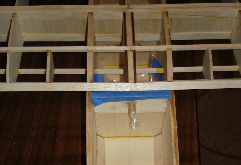

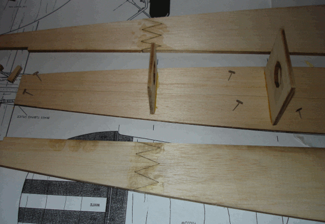

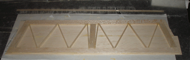

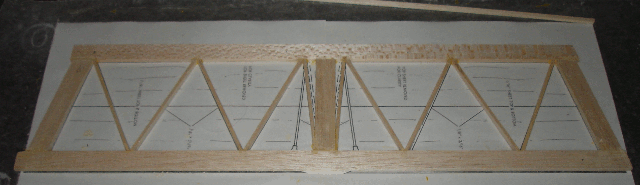

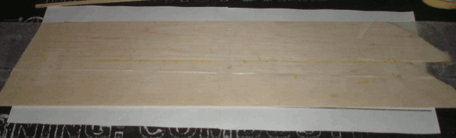

Decided to do some easy stuff this week, so I framed up the stab.
Plans say to build the frame on the sheeting. However, I like the method the 4 Star uses. There, you build up the frame, separately glue the sheeting together, sand everything nice and flat, and then finally glue the sheeting on.
The plans only had half the stab, I guess since you aren't supposed to use them for this anyway. I decided since I had the plans in digital format, I could print a flipped stab half on a normal sheet of paper. (I printed one flipped and one normal, just in case my printer was off a bit, things would still line up.)
I've heard people complain about warping using methods like this. I stack a couple books on mine, and let them dry for at least overnight. I've never noticed any warping. (Of course, this only works if your build pace is slow enough!)

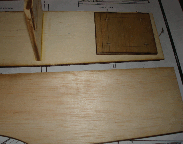

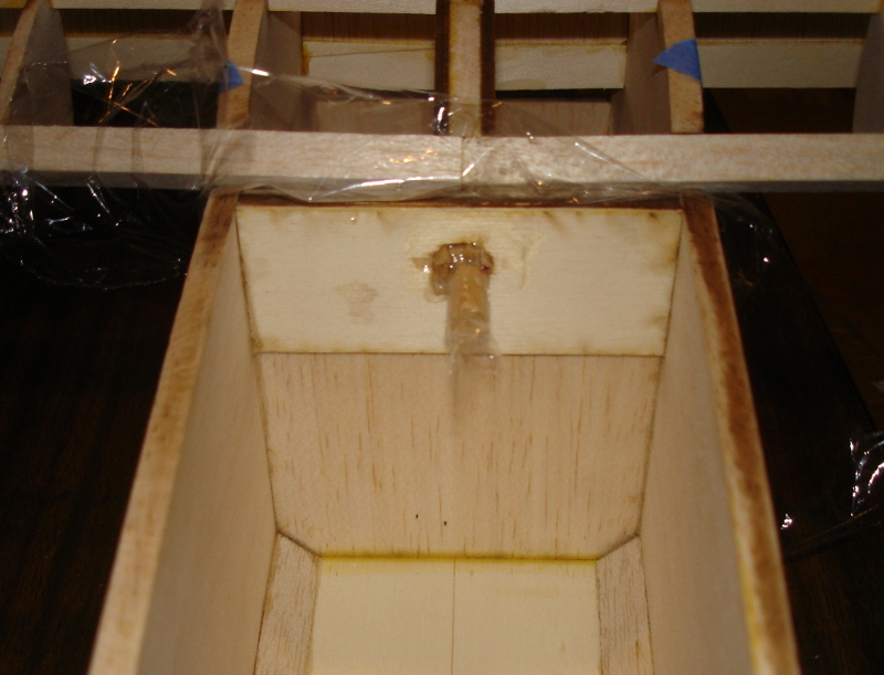

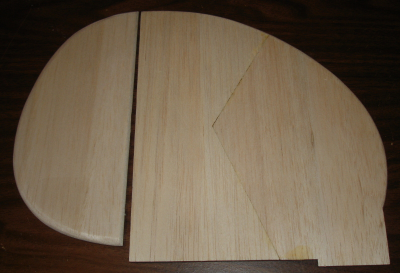

I've also been slowly gluing up various bits for the fuselage as I go.
The Lazer Works kit came with two firewalls of half thickness. (Each cut cross grain to the other.)
I'm assuming one is supposed to laminate the two to create one very strong firewall of the correct width.

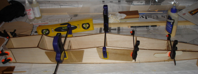

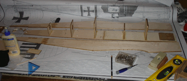

So, Sunday morning the Stab came out from under the books (weights), and I started laying out the pieces for the Fuselage.
I had already glued up the Fuselage sides at this point. Lazer cut kit came with a nice splice joint, which should be stronger than the wood!
I also have epoxied the mysterious single 1/4 hole plywood piece to front of F2.
I pinned the bottom sheets down and used a little epoxy to join them together. I started gluing up the bulkheads until I realized I still had to drill the firewall for the nose wheel and engine mounts.
I have to admit, I hate this part. The holes never seem to line up right! However, I managed to do OK this time. Nose wheel mount only required a very slight widening of the original top two holes, and the engine mount actually came out perfect.

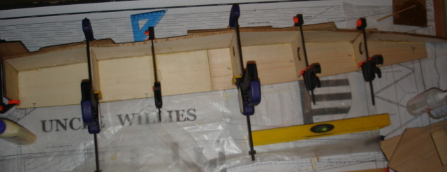

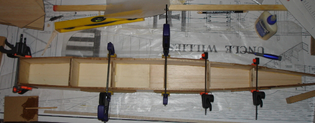

Quick update:
Glued on the fuselage sides and started reinforcing the front two bays.
It's good to have lots of clamps, but I'm pretty sure I need more!

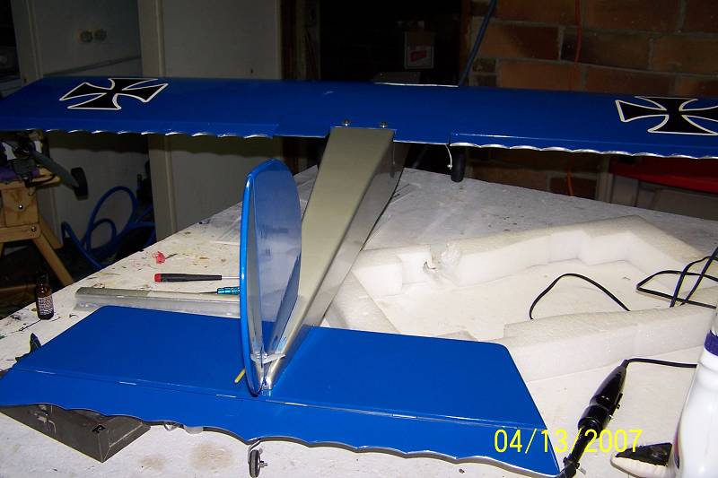

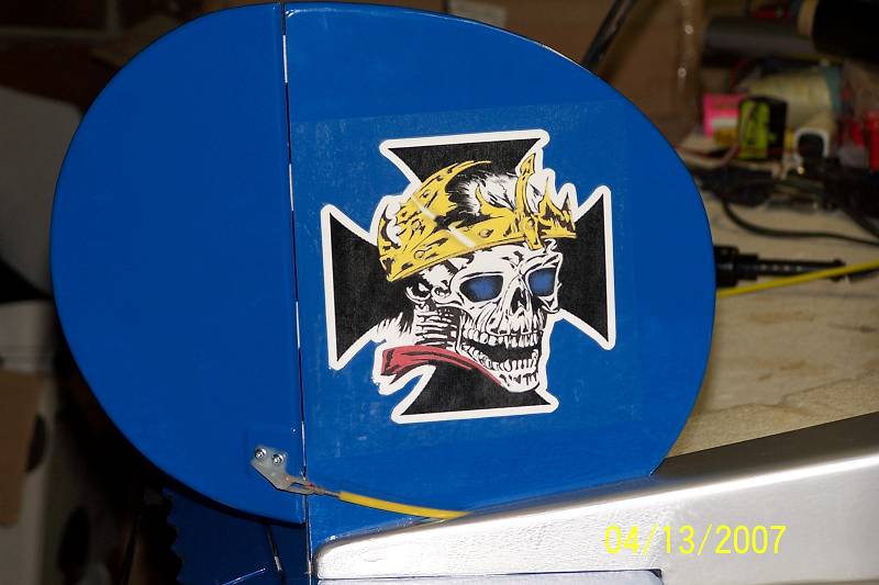

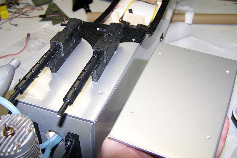

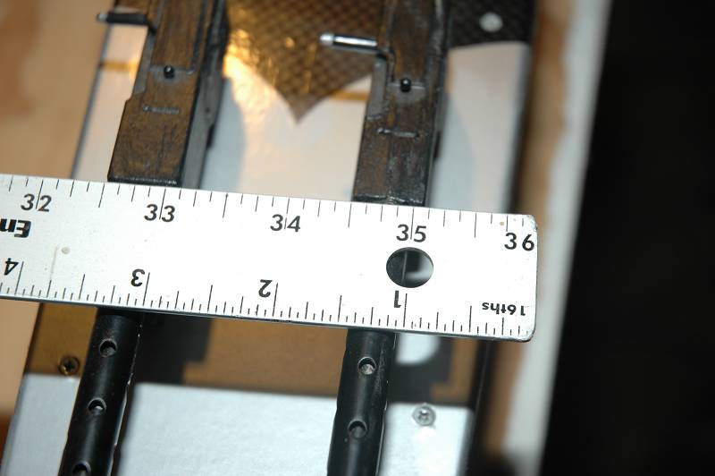

Here is mine from my own wing design and modified plans they are free for the asking if anyone would like a set.
ID:	1147458   Click image for larger version
ID:	1147459   Click image for larger version
ID:	1147460   Click image for larger version
Old 03-02-2009 | 12:44 PM
  #38
Joined: Jun 2008
Posts: 428
From: , GA
Default RE: Ugly Stick Build

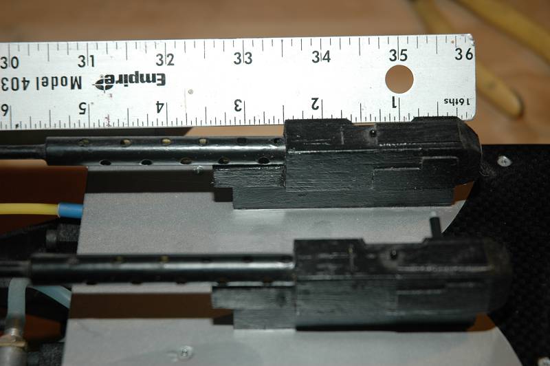

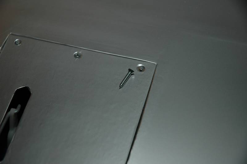

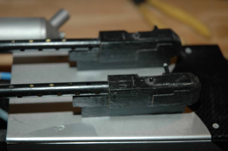

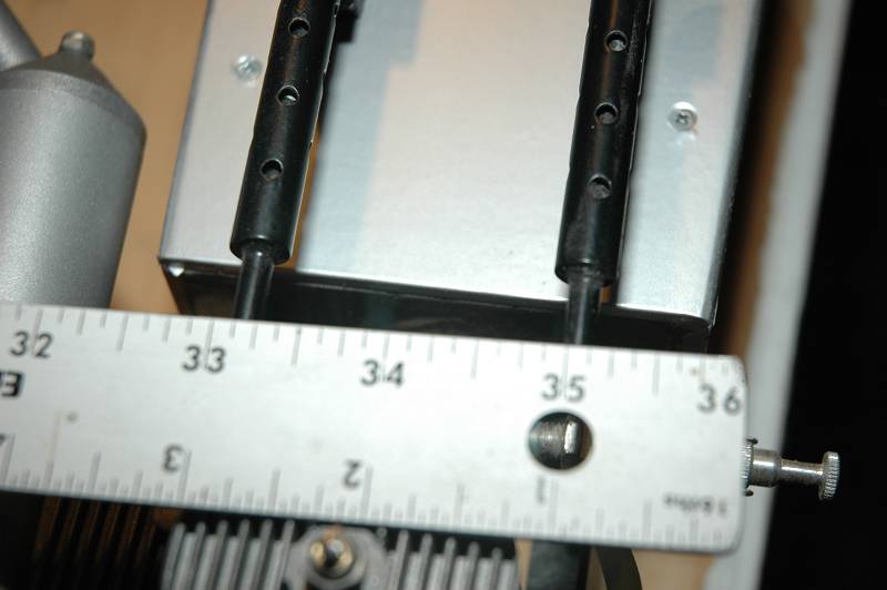

What happened to the machine guns when you got out to the field?
Where did you get the tail graphic and did you build or buy those machine guns?
I'm also kinda curious how you mounted the aileron servos.
Old 03-03-2009 | 04:23 AM
  #39
sticktickler's Avatar
Joined: Dec 2006
Posts: 551
From: Des Moines IA
ORIGINAL: Nergall

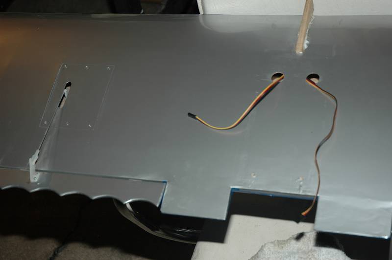

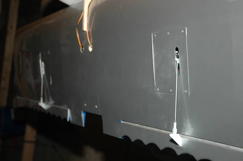

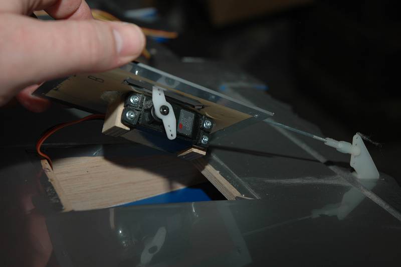

As you can see in the first photo above I have two hatches made one with guns and one without I used the hatch cover without guns that day as the paint not dry yet at that time. The guns are easy to build you can make two in a few hours real quick. Simply start carving the gun body add some scrap thin ply to simulate pannels and some small metal pushrod peaces for the bolt. The barels are simply brass tubing 3/8 outer and 1/8 inner after you drill all the holes in the outer barell fill it with foam then push the smaller one down inside the foam and hit with a touch of foam safe CA. Then thick CA a piece of 1/4 ply to the gun body see pic to use as a base for mounting. Then use wood screws to screw up into from under the hatch and paint flat black easy. See pics for size.
My aileron servos are on hatches in my wings on each side (dual servo) as are all my planes quick simple and the best way to do it see photos. Counter sink screw hole in hatch for the screws for nice no drag flush quality look. Use hard wood for the rails between the rib bays. This method for mounting dual aileron servos is really standard practice for most planes beyond trainers. Beats the torque rod method by far nix those and do this you can even program your radio to use flaperons way fun for slow aproches and short field take-offs.
The decals are even easier! Are you an artist or can you use Photoshop or some graphic imaging software? (I can do one for you if not) Once you have a design simply print them on regular paper in full color from your printer trim to fit on the plane. Spray glue the back (lightly don’t soak it) and stick it on the covered plane then fuel proof by covering with clear Ultracote covering. Overlap decal 1" all around paper edge with the clear Ultracote iron on low heat just to seal it up that's it easy way cool and looks great.
See You Tube flight video and a plans overview video as well link below.
http://www.youtube.com/watch?v=mqxakYJ8LLI
http://www.youtube.com/watch?v=zIBfRaYlTSA

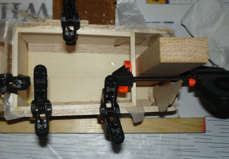

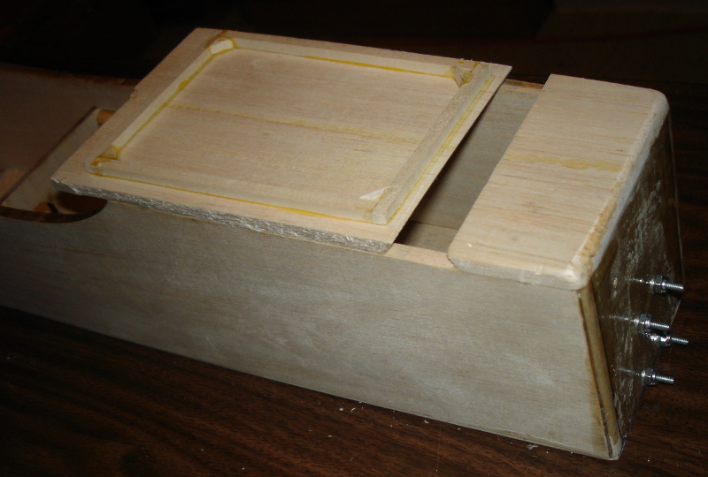

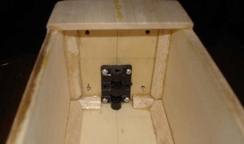

I started on the front hatch here.
My style is to build a frame inside the existing fuselage, lift it out, and glue it onto a blank. Later, I will trim the blank to the fuselage and then cut the front of the blank at a 45 degree and glue that piece onto the fuselage. This gives the firewall a little extra strength and the 45 degree angle should hold the front of the hatch down. This method is from the Sweet Stick plans. On that, the rear is held in place by the wing. I was thinking on this one, I'd add a tab that would engage the front wing hold down pin.

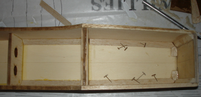

I installed the wing bolt blocks here.
The eccentric shape of the plywood below is because I used some leftover plywood pop outs from a 4*60 fuse side. However, it does what I want - which is to connect the forces on those hardwood blocks to the F4 bulkhead, a larger area of the 1/4 balsa sides, and to the base of the fuselage.

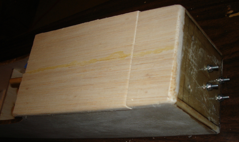

More progress to report:
I cut the hatch blank as described above and epoxied the front bit onto the firewall. Fits nicely, so I just have to give it a final sanding now. (And decide if I need a piece to hook onto the wing pin.)

From: , GA
I also got a little sanding done during the week. The vertical fin/rudder are ready to cover, the horizontal stab / elevator still need hinge slots and control surface bevel.
ID:	1152717   Click image for larger version
Old 03-08-2009 | 12:27 AM
  #49
Joined: Jun 2008
Posts: 428
From: , GA
Today, I got started by drilling the hole for the nose wheel. I needed the bracket to measure the hole, so once that was done, I could then install the bracket.
Old 03-08-2009 | 12:31 AM
  #50
Joined: Jun 2008
Posts: 428
From: , GA
I went on to work on the wing pin. I had to re-drill the hole because it had filled with epoxy when I glued the plywood piece to F2.
It ended up not quite where it needed to be, unfortunately.
In the first picture, I'm refilling the hole with epoxy and shims to keep the pin snug. In the second picture, I'm gluing the pin into the wing.
I'll let this dry overnight, and then I can re-measure everything and drill the rear wing bolt holes.
ID:	1152737   Click image for larger version
