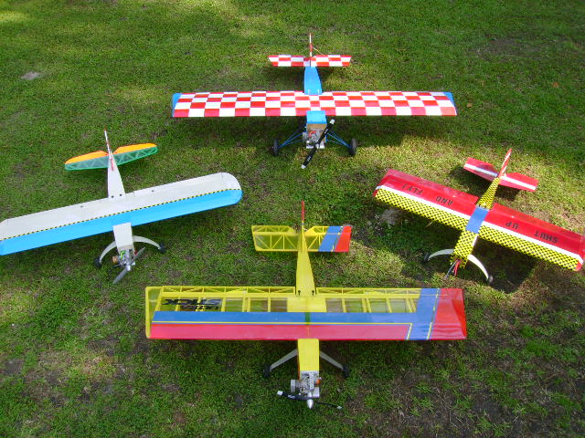

Thisweekend yet another club member was out with his Great Planes Ugly Stick ARF. Mine looks like an evilbrother to his. We've been chasing each other round the sky all weekend and having a blast.
Ithink Ihave a handle on the flaperons now. Ican definitely land better with them on, but they have their own issues.

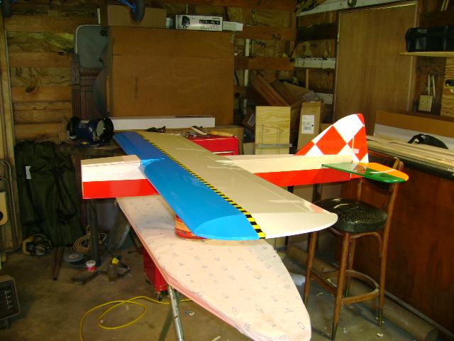

Uncle willies mod. of the jenson plans were the best(.Lazer-works.comhas short kit basedfrom these plans.I sent them 2yrs. ago. Go to L.W. and you will see that plane and a94" Tele master I built.)He removed the dihedral, I built this plane and others like it as a T.D. Nergall use vert. grain sheer all the way leading edge spar,half way trailing edge spar cover well. I did not use the dowel pin and #64 band setup. 2 dowels in center L.E. and nylon 1/4-20 bolts in rear. I've tried taken pics while I build, I get lost in the build and forget all about ths camera. So I will be startin a 106" Hobby Shack ugly stick and into the wonderfull world of gas.
