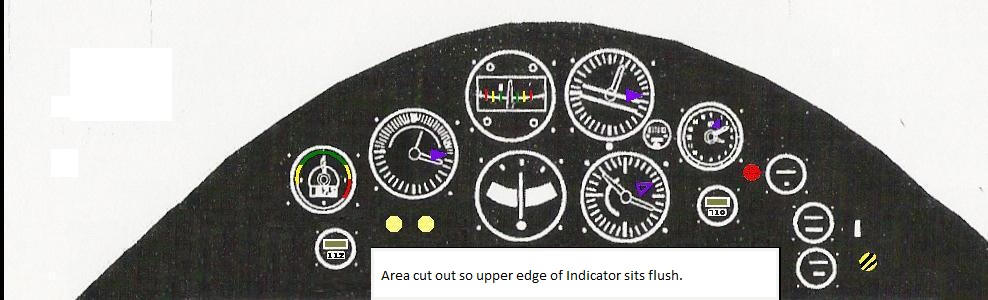

Could you share your ammended manual? Could you give more details on your wingtips, cockpit and dashboard? Where did you mount your switch?

In the cockpit I extended an existing slot in the fuselage balsa to accept the battery staus indicator and glued a suitably angled block of balsa underneath. This provided enough surface to stick the indicator on (they come with self adhesive pads). I then shaped a block of balsa to blend with the forward curved raised portion of the cockpit and cut a 'slot' in the lower face of it to accept the upper edge of the Indicator where it protruded from the cockpit floor. I then shaped it to give it a sort of cowling look and used lots of balsa seal before giving it a final light sanding and spraying it.
I used the attached picture (suitably sized and printed) and cut it to fit the console face. It also shows where the slot should be to accept the upper edge of the indicator.
My Rx switch is on the left side almost in line with the LE (as per the original picture). The other black dot in the photo, slightly higher and a few inches forward of the switch, is the refuelling dot.

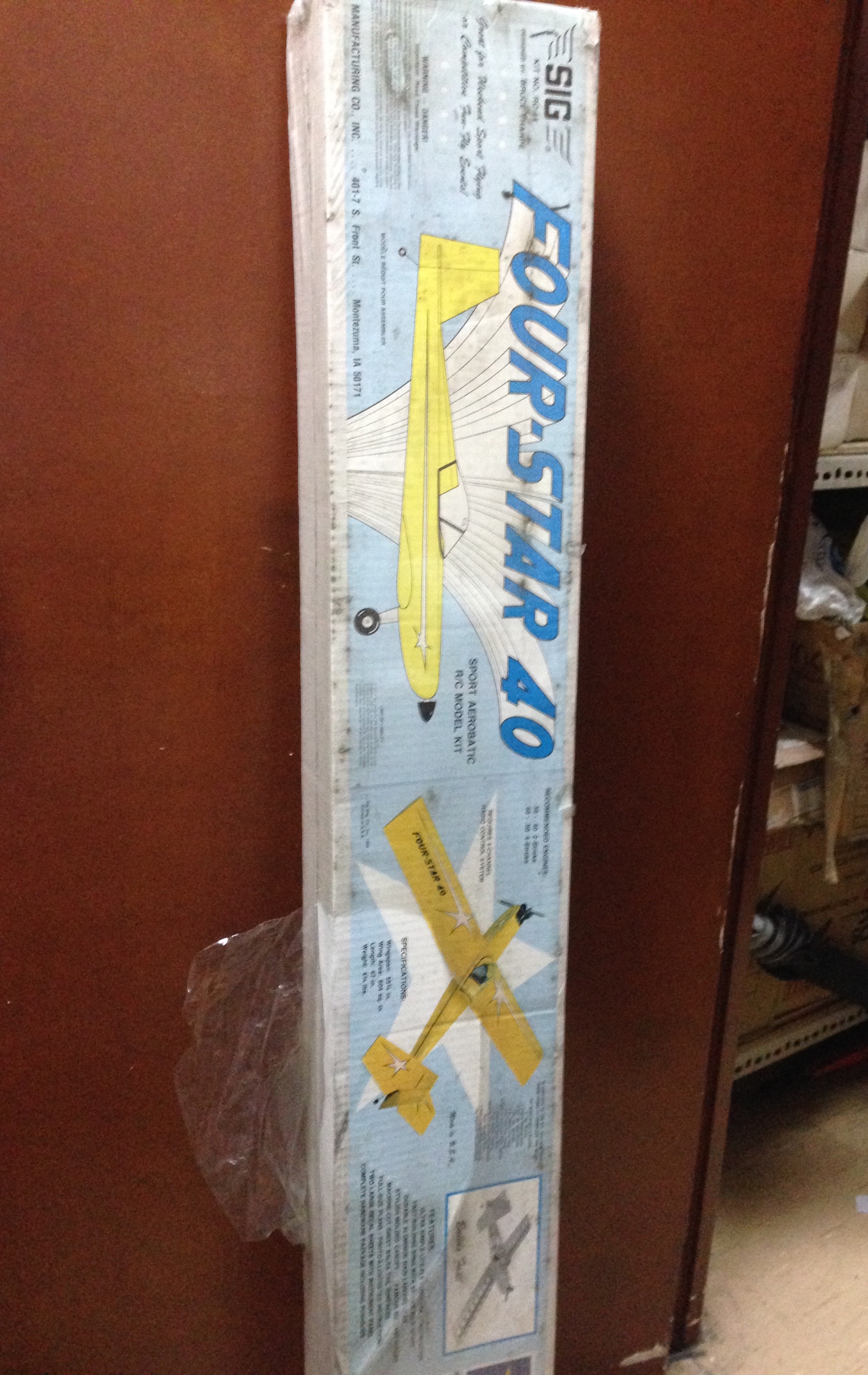

Hi all, first post here as I recently decided to do a search about this plane and came across this thread. Recently acquired this kit and this will be my first time to assemble a kit plane, any suggestions other than the ones mentioned in this thread? Anything to look out for? I'm not new to flying, but new to building a kit. Thanks in advance

My only recommendation would be to review the build manual and familiarize yourself with all the steps and methods before putting glue to wood. My first kit was a four star 60 and found it 'easy' relatively speaking. The Sig manual with the four star 60 was very thorough and didn't leave much to question. That being said, take your time and enjoy the build! The end result will be something your proud of and happy to put in the air alongside the high dollar ARF's at the field on a Saturday morning!!

Gordon, you could simply follow the manual and end up with a perfectly good model but personally I would advise adding the saddle strengthening, and the sheeted turtle deck as a minimum. The first will protect against the occasional less than perfect landing, and the second against rough handling of the fuselage.
If you have any questions please feel free to ask.

Oh, and do not forget to laterally balance the model before you cover the wings. Mine took 1/4oz of lead in the Port wingtip, but that might have been because of the modifications I made.
