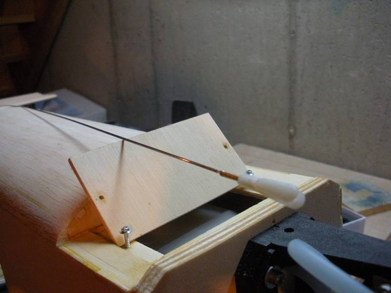

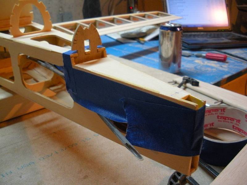

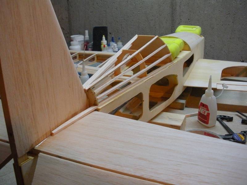

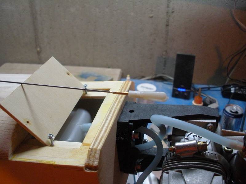

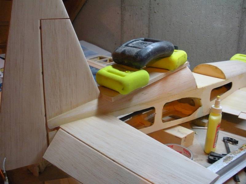

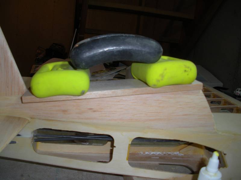

Ok, so here's the update, the side rails are done, the tank hatch is in place, it's been rough sanded and smoothed with 220 grit (next is 320) and now I need to flip it and put it in the stand to do the linkages, and pull pull, mount the motor with pitts muffler and set up the switch and fueler system, the tank is already installed as well. I did change it out for a 10 ounce so working on it is no problem in the future, unlike some planes like the sportster and hog bipe, where it's almost a perminent install.I do need to epoxy microballon the pull/pull guide tubes in place, these are just the reminant guide tubes from the elevator guide tubes. I do have new red sullivan tubing, but I'll try to use up as much of the material if possible and not waste the old tubing. I do plan on installing an antenna outlet to the tail section, you might want to do this for you extra kit. It's simple and easy enough to do now, rather than later. Oh yeah, the stupid little tip is the piece of flashing tin bent around the leading edge of the rudder, if you hit the tin, you won't knick the leading edge, it worked like a charm, and the best part is, you can cut it with siscors(splg?).
Why isn't there a spell check in the task bar, I really could use that on a daily basis.

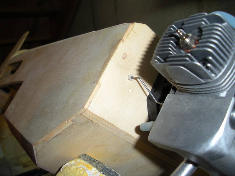

Sorry about that, I went to go run a few engines to determine which one to put in the extra. Then I had to go grocery shopping and do dinner, so late last night was a wash. I ran the fox .40, and the webra 50, I also have the NIB supertiger 40 ring, but after running the webra I decided that's going in the extra. I had a heavy 3 blade 10x6 on it and it was still turning 15,000 Rpm. Idle was great as well. The lower profile head will keep it inside the cowl as well. So I'll set that up on the engine mount today. As far as the tailwheel goes, I already made a provision for the GP semi-scale tailwheel assembly, it's for 40-60 size planes. I got the servo layout set, but need to finalize the connections and install the control horns. Basically set the whole plane up and tear it back down so I can cover it. I don't know how much I can get done today, my GF wants to have a "Date Night",........at this point, I'd rather build my plane than get lucky. I guess I'm missing a few screws in my head if I'm thinking that way but it's true. I'll post a few more pic's today as I go.

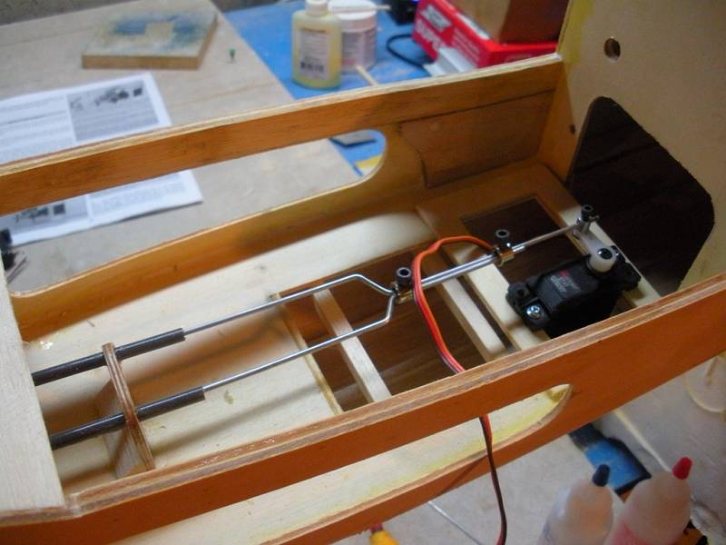

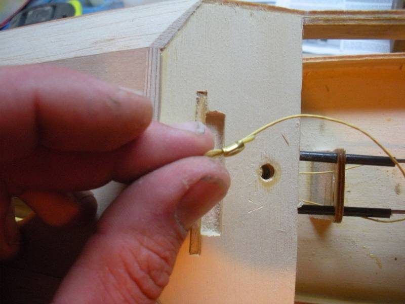

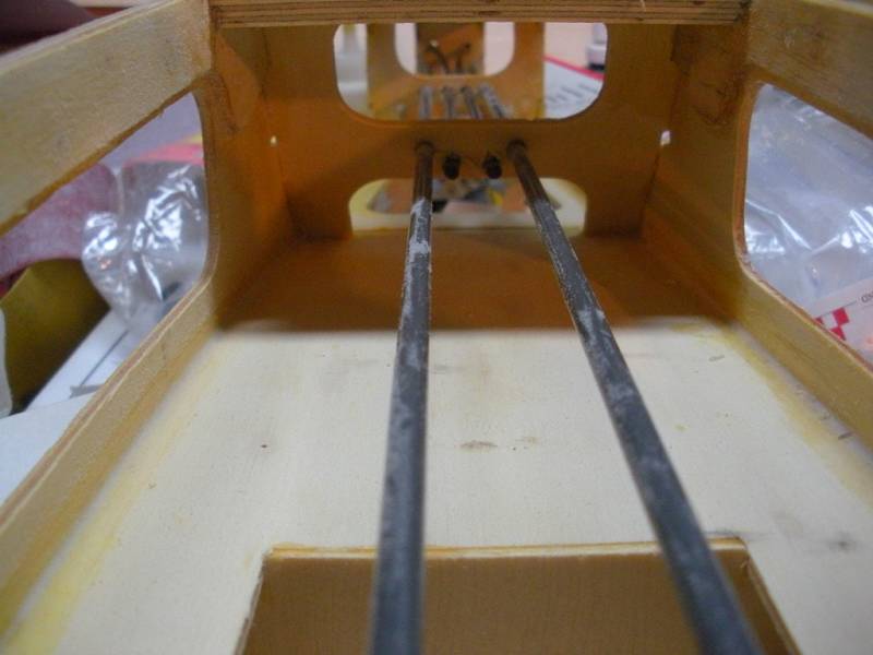

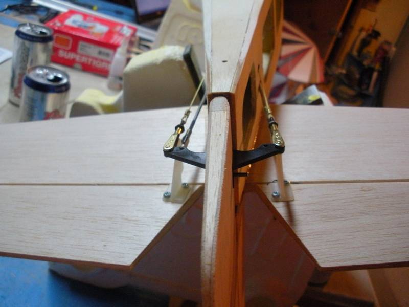

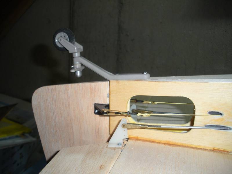

All right, so elevator and rudder/tailwheel are done, here's how to add pull/pull, if you were building it in, you'd offset the elevator tubes to the opposite side of the throttle input, but since I built it per plans and changed my mind, I had to set the rudder servo behind and below the elevator and throttle servo tray. The pull/pull is the sullivan kevlar strand type, the servos are for setup, only, I plan on replacing them with the hitec 475's coming sometime this week. Throttle will be a standard type 422 hitec or so. The trick to pull/pull is setup one side and match the other cable as best you can, don't worry about putting a ton of tension on the cables. I've seen guy's set these up with soo much tensionyou could tune a panio with them, unfortunatly, it just invites failure, especially in the turnaround in the threaded adapter. Remove enough slack to take away the play, but no more, remember, when the plane goes from the cool house workshop to the field, the airframe is going to grow as it gets warmer and more humid at the field. Plus, you'll only wear out the bearings in the servo by doing that as well. I simply cut a small piece of brass tubing, about 1 size smaller thanbrass tubing provided in tank systems, CA the strands tight, trim it flush, slip a brass tube on, the 2-56 end piece by dubro (PN-201), loop it through the brass tube and then do another loop back through the tube for security. Add a drop of ca in the tube and let it sit for a few seconds to soak in, now crimp it with a pair of electrical crimpers, I use a pair that are designed for ear tabed type terminals, the kind you find on servo ends and push pin connectors. There, your done, you can also add heat shrink over the brass and loop and make it look more "finished", and add a drop of CA inside to lock it all together, but the CA will cause a hard point and fail eventually down the road on the kevlar, but for stranded steel cable it won't. So it's still feasible for you to do pull/pull, it's all about 1 1/2 hour's worth of work from tubes installed to setting it all up. It takes almost no enery away from the servo and is very persice in movement, you can actually see each step in trim on the servo. I mounted the tailwheel, I installed a blindnut on a plate for the front screw, the rear is just a tapered head wood screw, that one see's almost no load, just the front screw. I also shortened the aluminum dome nut and threaded shaft, I ran into the same issue on my skybolt where the aluminum nut was hitting the rudder fin from initial sag of the bracket. The elevator linkage was going to be bound with copper strand and soldered but I decided to use the wheel collars for the fact that in the future I can remove the push-rods to not only cover the plane but do repairs on the system, it does have drag of the rods but no more than a ounce or two, basically the bow of the rods in the sleeves. The servo doesn't even notice the slight drag. Now I have to setup the engine, and bore the hole for the throttle linkage and set the throttle up, along with the fueler and switch assembly. Basically about another hours worth of work, if I don't get distracted by the GF or the cats?!

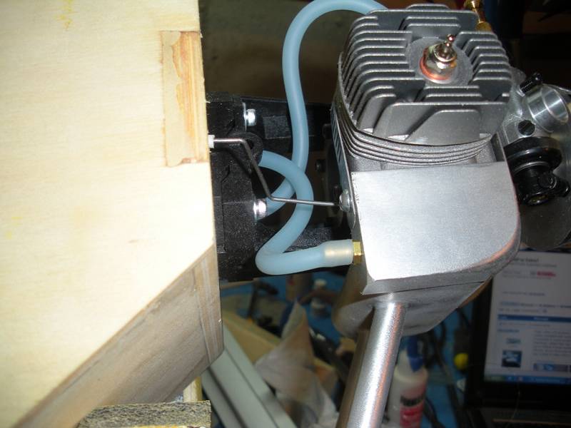

Alright, so the ST has a lower profile then the webra, and after throwing it on the scale, I decided that the ST 40 would be more than enough for how I fly, I'm more of a sport pattern flier. So no 3D on my plate means a light mildly powerfull airplane is just what I want, I'm not worried about getting in trouble, even pretty low I can bring them back home without issues. (Unless I swipe a goalpost or a tree) I mounted the ST 40 and put the pitts muffler on, bored the hole for the throttle linkage and set that all up, but tonight is a wash, I have date night like I said, so I gotta go blow money on the GF watching a movie and diner, so this is where I'll stop for tonight. I hope this spawns a buying spree on the GP extra 40 and 60 size so they don't discontinue this great little airplane, and if they do, O-well, it was good while they lasted.

More great pictures.  Now I understand how to setup the pull-pull.  I may do this when I build my next kit - probably the SSE.
I picked up a dubro tail wheel, blind nut, and spring from my LHS - I am going to use a similar setup to what I set up on my two scratch built planes - it has work very well and survived many hard landings - I need to glue a small piece of hardwood to the bottom of the rudder to put a screw through the spring.
