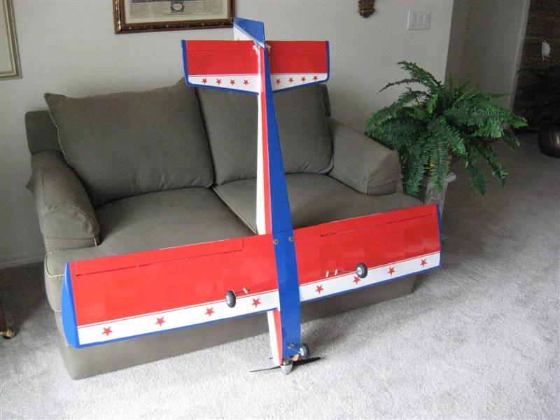

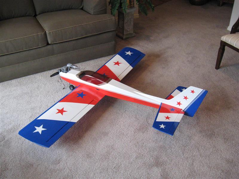

Hi PB66
Interesting thought. I guess I built my Tiger 2 according to the plans without mods. It's still hanging in my shop, unscathed, because my wife won't let me fly it after totaling the T-60 on its second flight.

Great covering job Geezer! [sm=thumbs_up.gif]

safeTwire
Thanks for the compliment. I think it turned out pretty well. To a great extent I was trying to follow the guidance of MinnFlyer on changing colors on the wing at an angle, not just straight fore and aft. It was pretty interesting.
Frank

Youre welcome Geezer! The layout is great, and I absolutely love the colors!

Hard to beat red, white, and blue, isn't it!!
