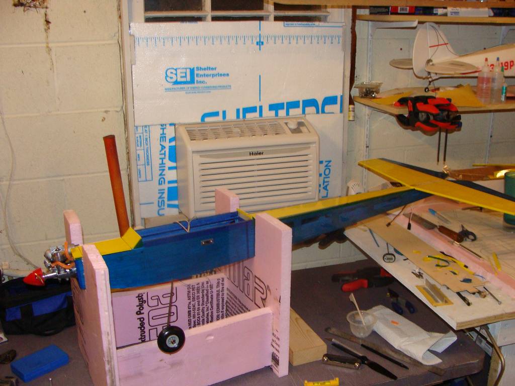

Well as of tonight I have completed the covering on the fuse. I have the throttle control rod hooked up, and tail section epoxied.
As I was waiting for the tail to dry, I started installing 1/16th balsa sheet as web braces. I found some 1/32 balsa sheet that Im going to sheet the two outer ribs with. I may even put a sheet on each side of the joining ribs. It depends on how difficult the outers are. Pictures will come soon.

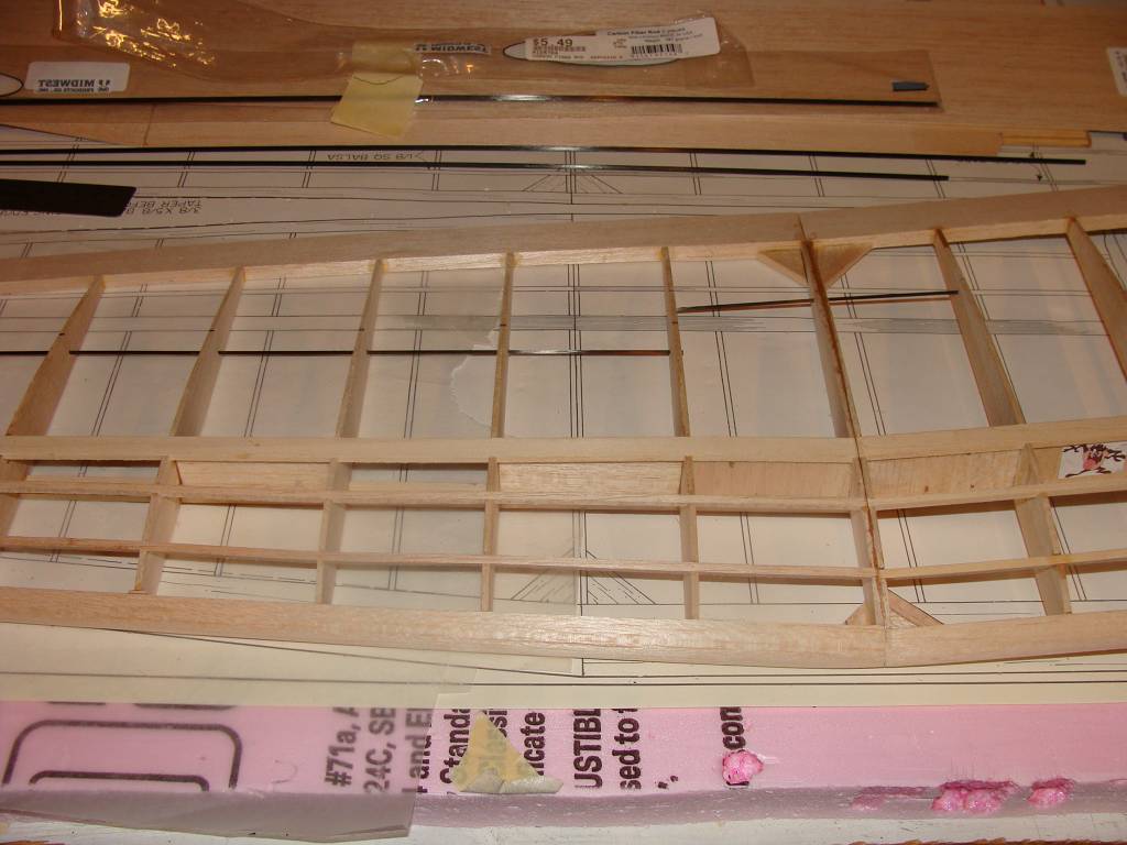

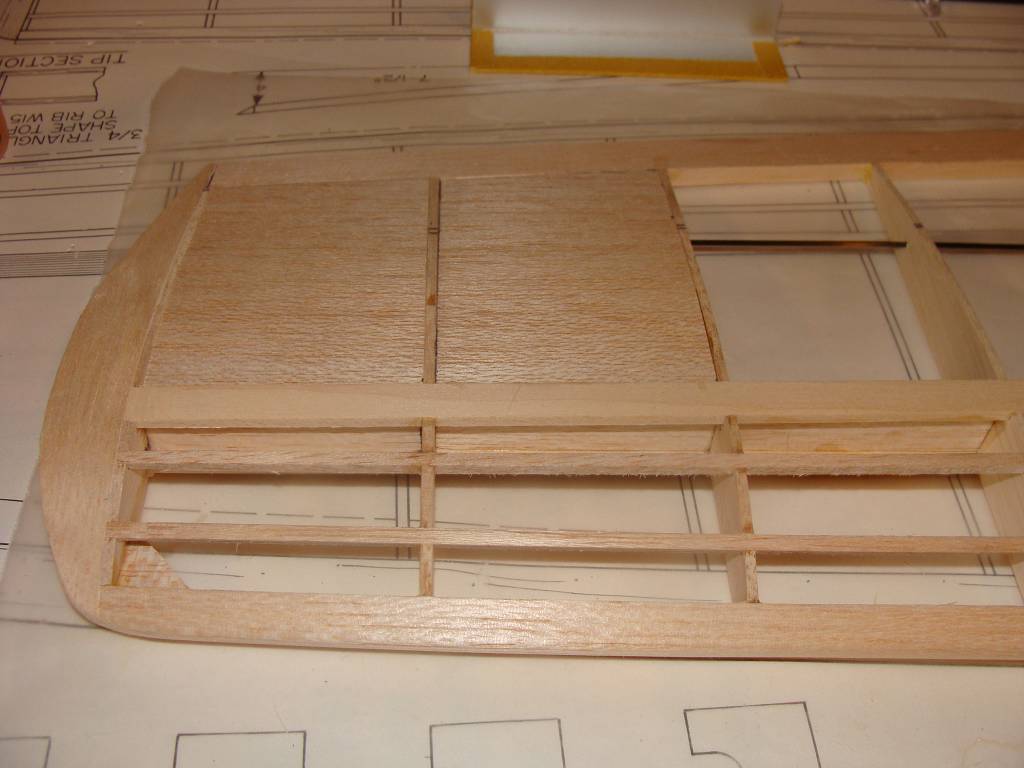

Picture updates

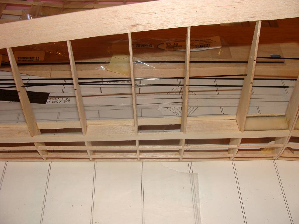

I have been working on the wing. Installed 1/16th balsa web sheets, but I didnt notice any benefit. So I added the .06 in. carbon fiber rod and sheeted the outer two rib areas. That should add enough stiffness.

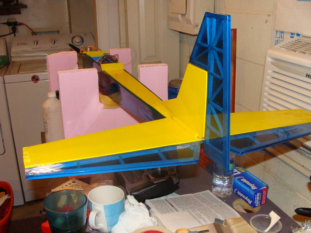

I hope that the wings will be easy to see hight up. I have one side done with blue on the bottom, and blue on top with a piece of bright yellow at tips covering the last two ribs. I may have to add 1 to 2in stripes of yellow on bottom. My plans for adding 1/32 balsa sheet on bottom tips got left out. After doing the two top, I got too lazzy and didnt feel like doing the bottoms, but now I wish I had.

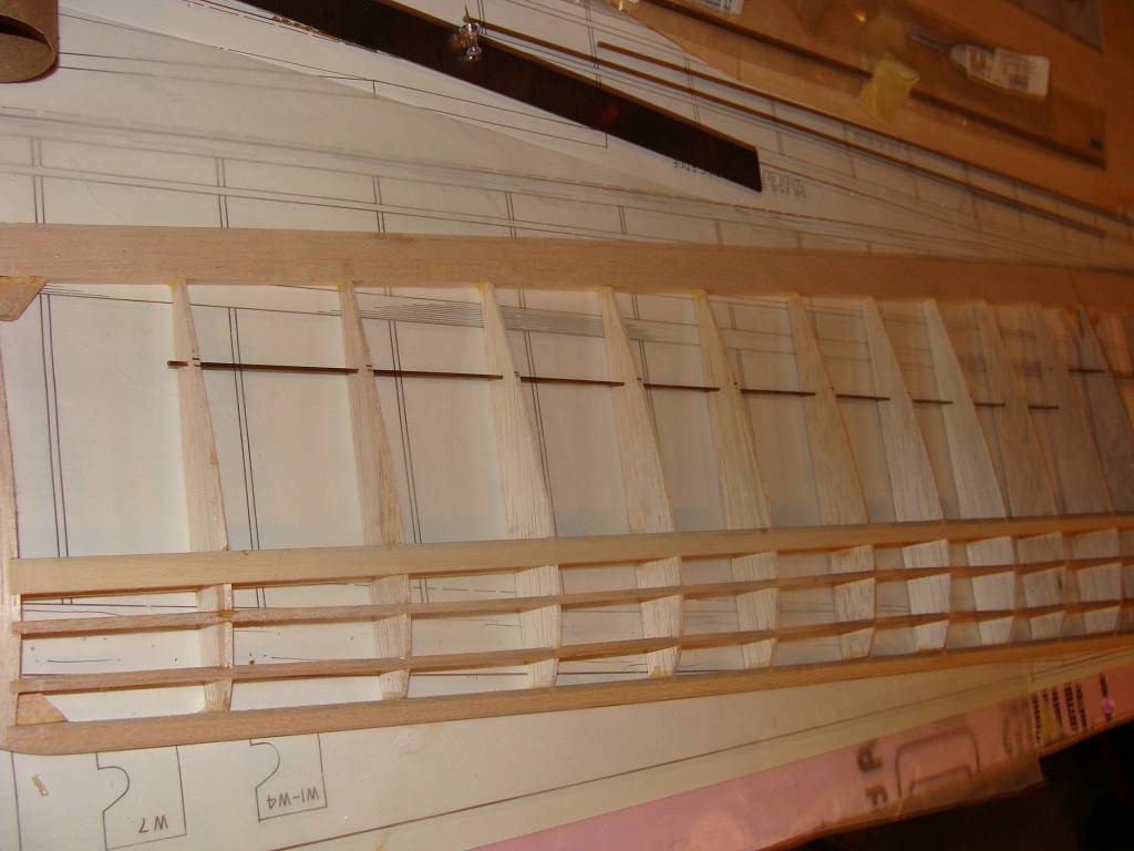

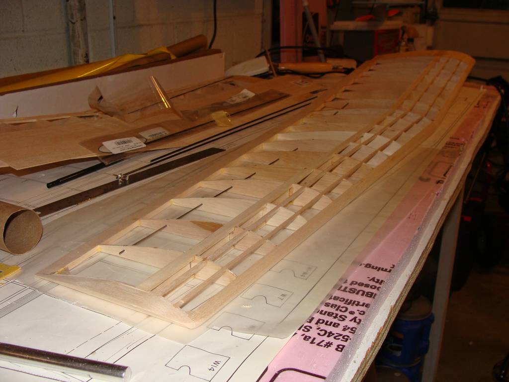

Here is what I got done saturday night.
1. installed the .06" carbon fiber rod in left wing
2. sheeted the out tip of left wing.
3. installed the tail skid, painted it, and coated with epoxy.
4. covered one wing.
5. made trip to Ace for longer hardwood dowel for rubber band holder thing. Kit ones were too short, and exoied them.
Now all that is left is to cover the other wing and tune the engine, oh and check my throws.

Great work but how about some red to join the yellow and blue it will look good and may help at the high altitude this model can get to. Dont try to fly it with one wing covered LOL Yours Paul T

I hadnt thought of that. Where would I add The red? Right now, I have been thinking of what I could do to the bottom of wing. It is all transparent blue. I was joking with the wife and said I was going to put a large yellow smiley face[8D] on the bottom of both wings. And she liked the idea. But Im worried about making a mess trying to put ultracoat yellow over the monokote trans blue. My covering skills are still in its infancy stage

I think that red about the width of three inches around the wing would look good or orange. Yours Paul T PS you should be in bed look at the time.

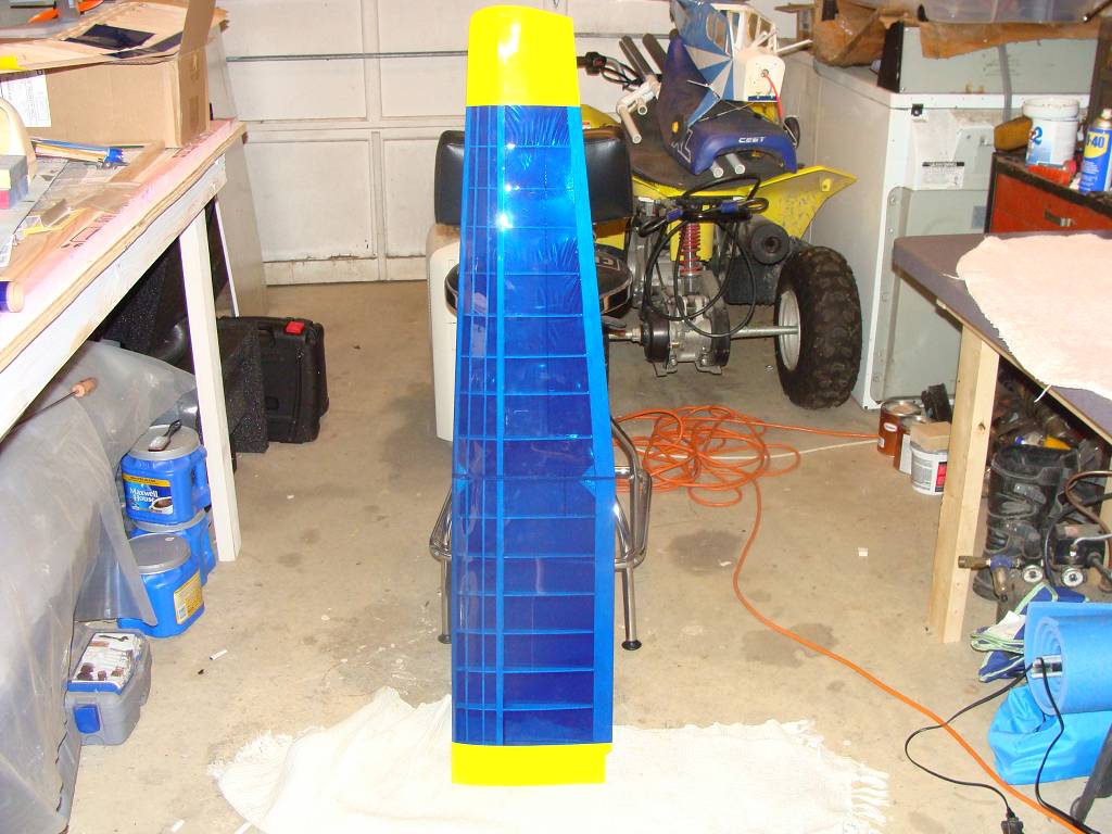

Ok -Heres what I have so far. I wont be able to work on it for another week now due to work. At least this part is done! My favorite part to cover is the fuselage!
Happy Flying!

That is a great color selection and scheme...You ought to be able to see that in just about any conditions............unless you get above the clouds.
Way to go!
