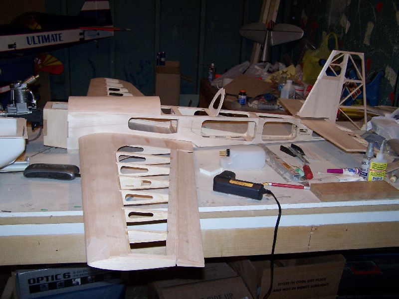

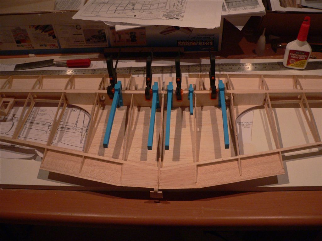

Progress Update:
Right wing bottom completed. - Next step joining the wing halves. Mmmmm

I joined the wing halves before I sheeted the wing[X(]

Only the bottom of the wing is sheeted at the moment. The top gets sheeted after joining.

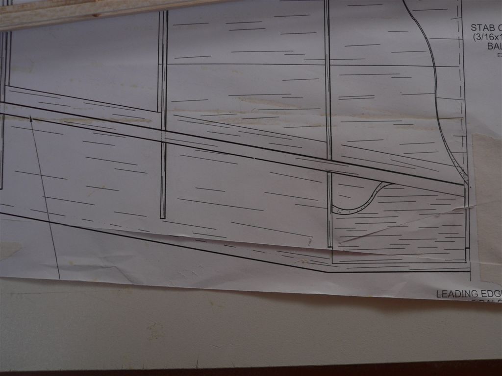

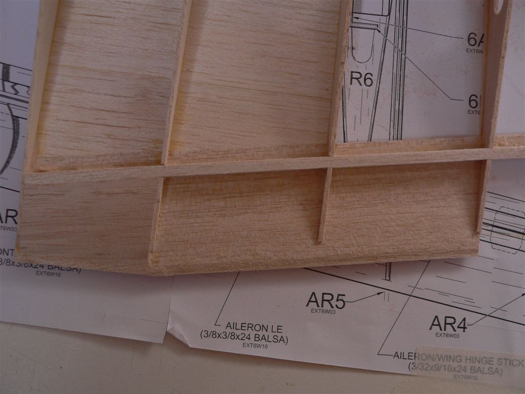

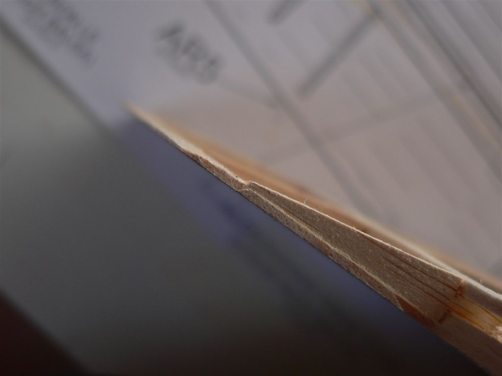

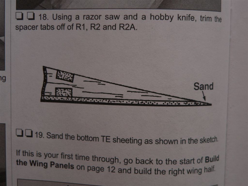

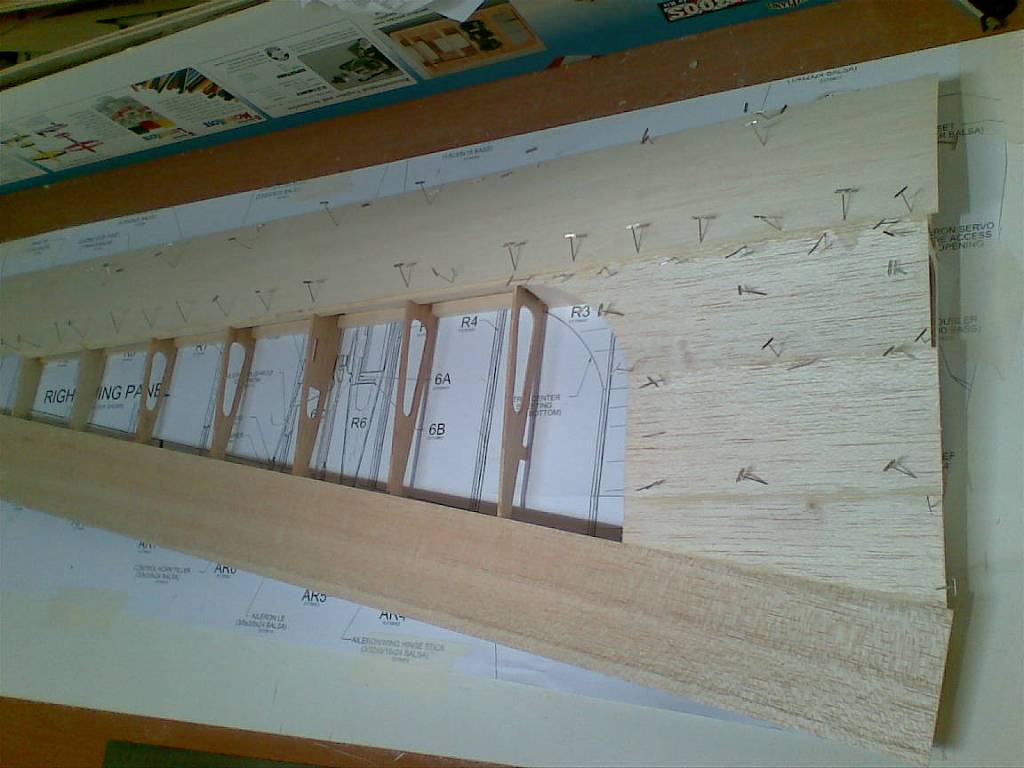

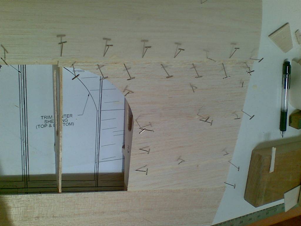

Got a problem with interpretation of the plans.
On the trailing edge of the wing frames it instructs to trim the sheeting so that it is 1/2" longer than the ribs, which I have done.
The instructions then show a diagram of how the TE should be sanded (photo 2)
But to sand it this way there is much less than 1/2" of sheeting. If I sand the sheeting back like this won't it affect how the plane fits in the wing saddle?
Also the wing TE ribs do not taper to a feather edge as indicated so this would require changing the shape of the ribs which would make it even shorter.
Don't quite know how to proceed. Any suggestions?

Another photo of the TE.

I built this plane, so I'm not just guessing. You did it right. Sand the wing as if the ribs extended to a point. Do not sand the ribs any more. If you cut the sheeting like the plans show, you're all set.
Old 08-23-2009 | 08:45 AM
  #35
EscapeFlyer's Avatar
Joined: Aug 2003
Posts: 2,396
From: Brooklyn Center, MN
Default RE: GP Extra 300S 60 Build
Bax with Hobbico could answer this question- and probably will. He watches these threads too.
I think you are doing it right. You might wind up with a tiny gap behind the rib, It will still work.
This is a great question for Bax.

Looking at joining the wings. I have made up the wing jigs and presented the halves to each other. There is a large gap on the underside of the root ribs when the top portion is touching - maybe 1/8". I used the rib guage to set it up so I had expected a much better fit.
I wonder are the ribs supposed to be perpendicular to the spars when flat on the board or is the rib jig supposed to set them up so that when the dihedral is in the ribs are vertical? Alternatively I have use the rib guage from the wrong side - if this is the case the instructions did not even mention this.
Anyway, I will need to sand the root ribs/spars to obtain a stress free gap free glue joint.

The ribs are square to the spar and are straight front to back and top to bottom.
The issue is that when they are set at the correct dihedral the upper spars touch while there is still a gap of about 1/8" on the bottom spar.
What is the point of having a rib guage if it doesn't work - or if the instructions do not tell how to use it!
From my experiences as the wing is built bottom up when building the top of the root rib needs to be farther away from the tip than the lower edge of the root rib. To acheive this the rib guage needs to be inboard of the wing as the angle on the guage is about 91°.
A 2° offset angle will lift the wing tip spar by about 1" I will measure up latter and post what the angle should be for the dihedral, then when you press out your rib guage you can sand the correct angle into the appropriate edge.
What I have done is to set the wing onto the wing jigs and then to sand using a vertical sanding block.

Double checked plans and instructions. no mention of any angle on root rib or dotted lines on plans.
Hope to get a chance to glue together later - family commitments et al.
Just a note that the dihedral angle is around 3 degrees, the rib guage is between 89 and 90 degrees, probably supposed to be 90 degrees.
Confused on this one as it is surely not correct as is. Anyone else built this kit noticed this issue?

But I have managed to get a good fit on the wing joint so I will glue that this evening and post some more pics.
Went through the manual again yesterday noy reference on root rib angle but it does show using the rb guage to set the end points of the spars at the root. I measured and calculated the dihedral angle based upon the wing jigs at 2.7°. This implies that the rib guage should have an angle of 87.5° - mine does not. Would really like to hear from other GP extra builders on this one - for furure reference.

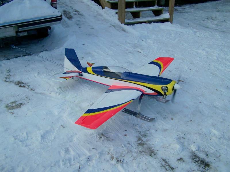

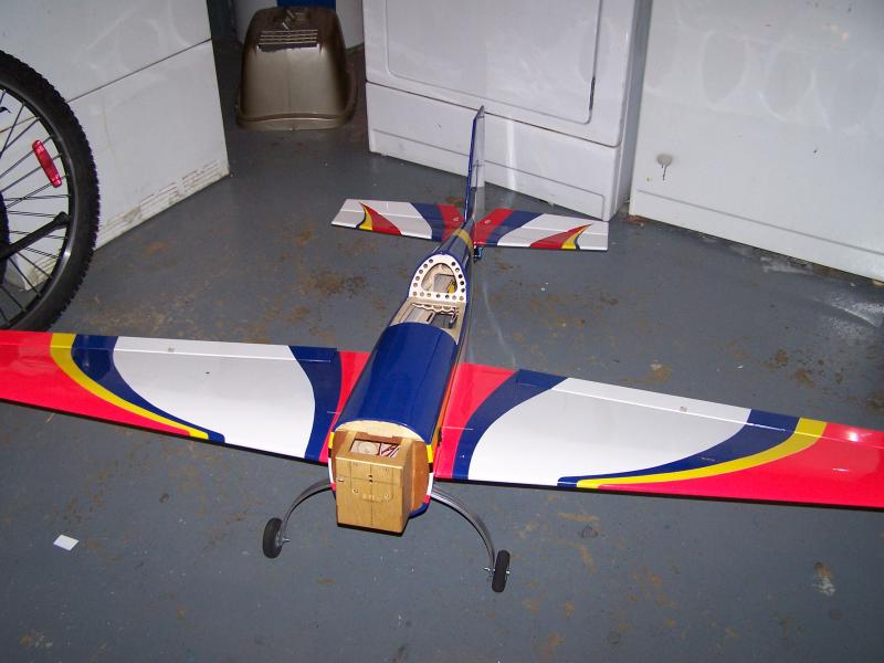

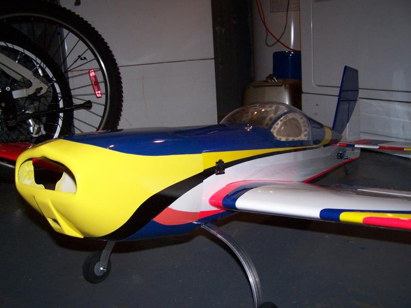

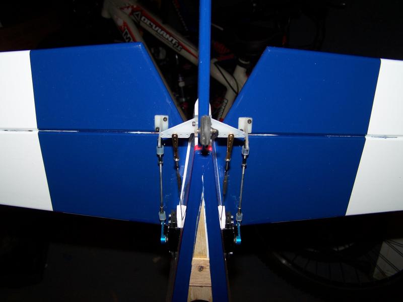

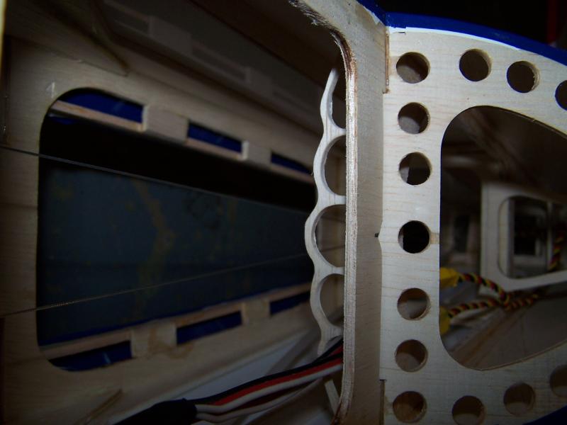

Andrewmc, great choice and yer doing a great job. I built one last year. A few tips. You want this thing light. I got mine down to 7.3 lbs. I'm running a saito 100 (pumped) on 30% heli. The vertical is BANGIN! I went with 5245 mini digital on ailerons and elevators (split) and a 5625 on rudder, pull-pull 2-56 (light...)
I lightened EVERYWHERE. The wing on this thing is built like a tank. You can drop a surprising amount of weight by carefully removing here and there.
The elevator/stab on this plane is very sensitive. In hindsight I would have moved the hinge line forward 1/2" cut 1" from either side of the elevator/stab and added some counter balance. Not a lot of counter balance and in fact hidden like a funtana so it is not overly touchy at high speeds.
Be careful on landing. mine liked to rock a bit. I was all over the ailerons keeping it level on approach, mostly when it got about 5 feet over the runway and down and it gets a bit mushy on approach so keep the power up a bit and don't float it in as it will drop unexpectedly. This plane does the best lomkavecs I have ever seen.
Be sure to beef up the landing gear mounts. I did with mine and it is a good thing as mine survived a drop of 3 feet with only a slightly bend gear. (i.e. don’t slow up too much on landing.)

Happy with the wing fit and took the plunge and epoxyed all together. I think I used enough clamps
