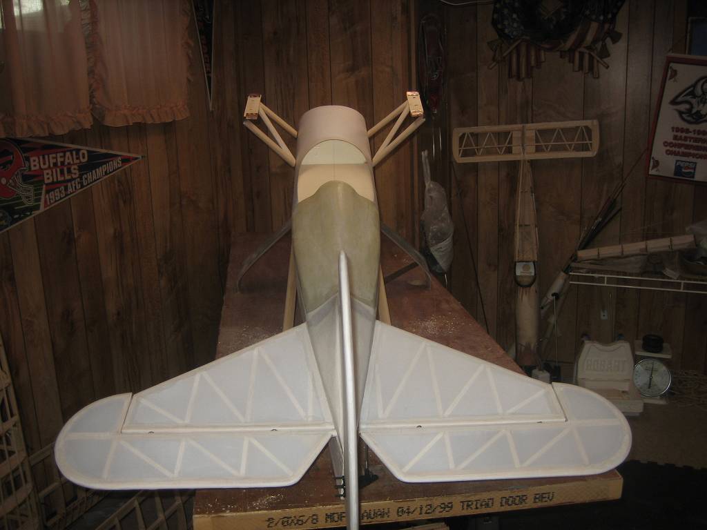

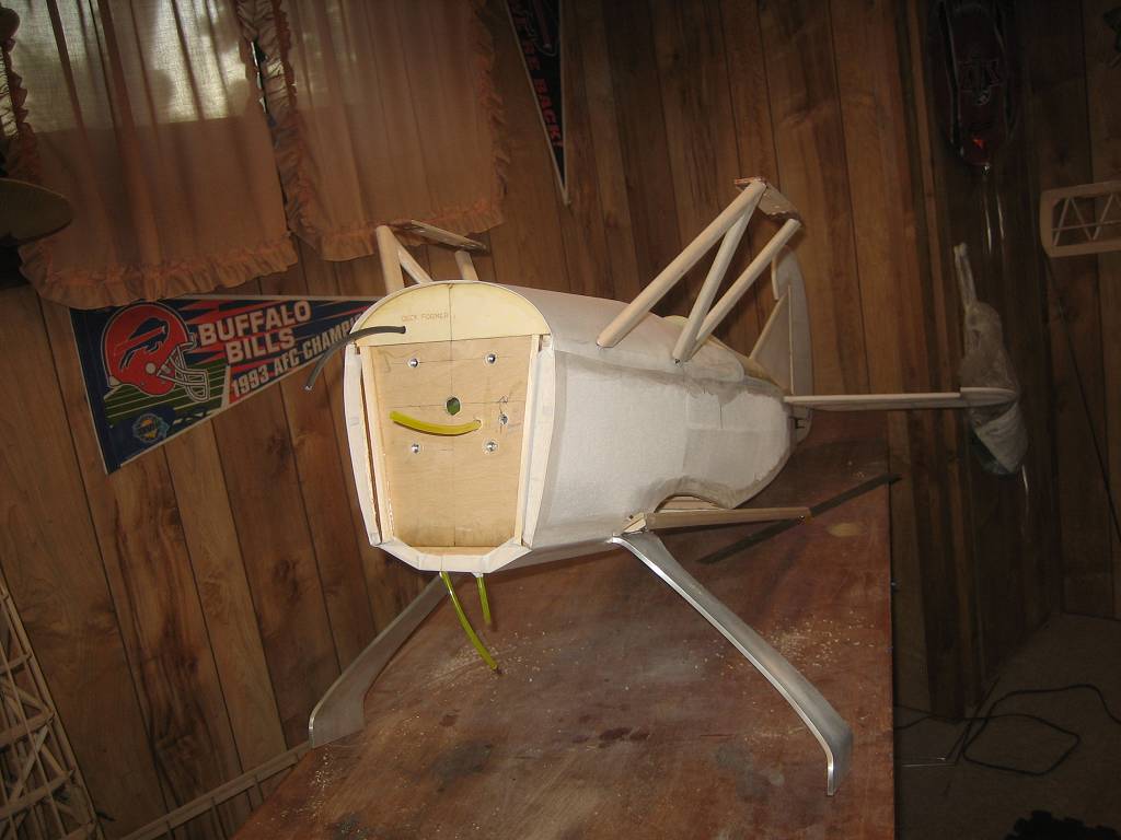

here are some pics of the fuse ready for prime , wings are not coverd yet

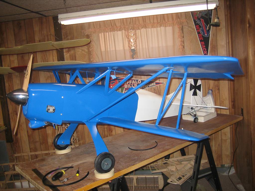

almost done

Looks Great! I'm still stuck here in Afghanistan, ordering parts for this build. I did get the landing gear from TNT and a G-62 with a pitts.
Do you have the drawing or measurement for the Cabain struts? I don't have my plans here with me, and I forgot what size wheel and spinner the plans call for.
Just more stuff I can order for this while I'm here.
John
Old 09-19-2011 | 01:31 PM
  #81
lazyace's Avatar
My Feedback: (126)
Posts: 510
From: buffalo, NY
Default RE: Der Jager 1/3 scale
john
they are 5" wheels. it calls for a 5" spinner but used a 4" the 5 looked to big to me, I made the cabanes from the plans . I need a lot of tail wt. with a fuji 50ie up front , g-62 is heavier be carefull .

Thanks for the wheel and spinner sizes, gives me a chance to order a couple more things. I got a pretty good deal on the G-62, but I also picked up a NIB BME 50. I may use that instead of the Zenoah if weight up front is an issue.

I've got hitec 645's on all 133 oz on 6 volts , I don't do 3d just some mild aerobatics .

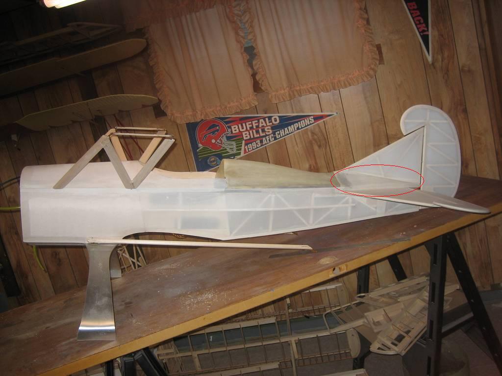

Question about the area aft of the Turtle Deck, between the vertical and horizontal. Did you fiberglass this fairing, or is this just fabric?
John

I carved it out of balsa and covered it with cloth
