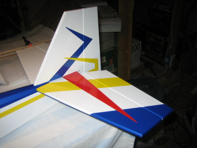

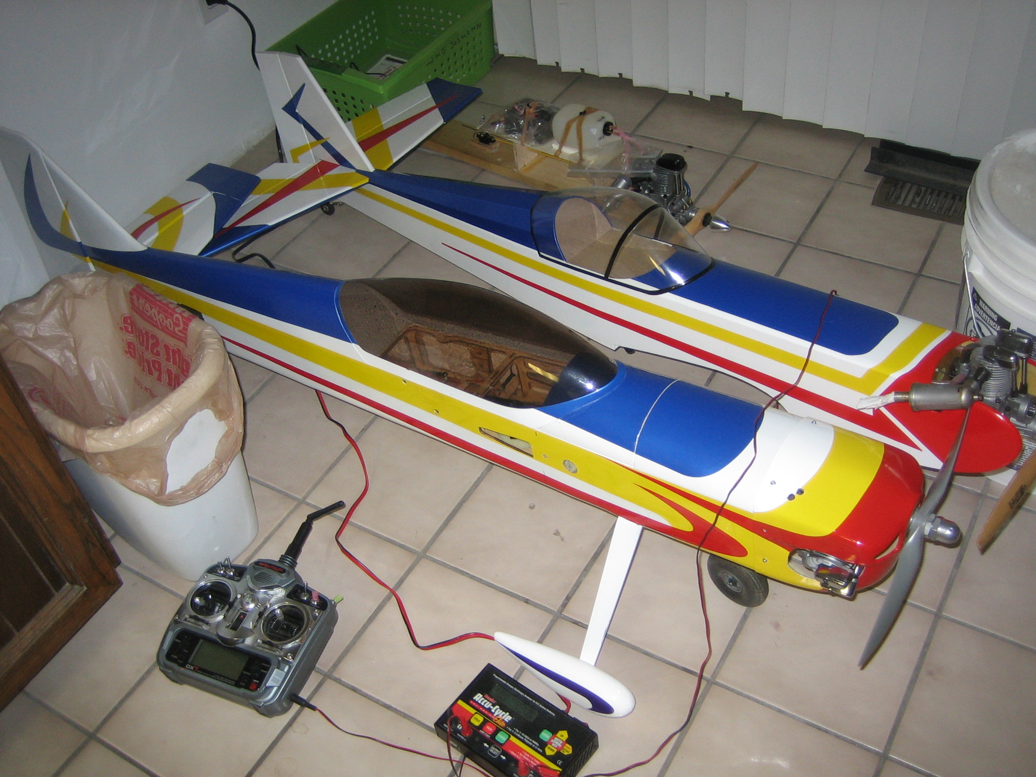

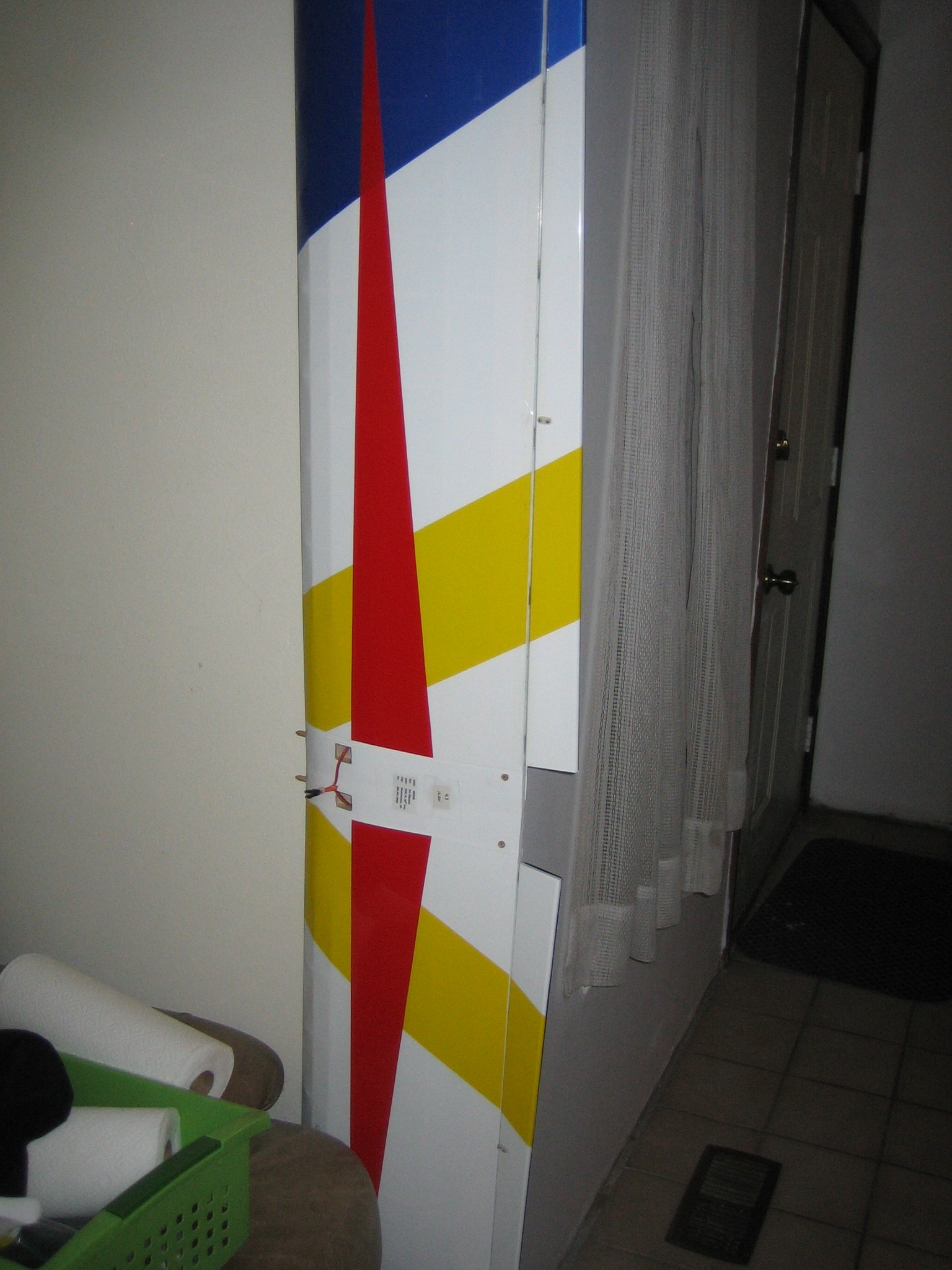

My 4Star60 was covered and trimmed in Ultracote. All has white base except for the turtle deck and the bottom of the wings & stab. It took an hour to apply the pearl blue on top of ONEof the wing tips. I'm guessing that Ihave over 10 hours in applying the trim. You will not find a bubble in any of the trim.
The last 3 pics show the real inspiration for the scheme ...
