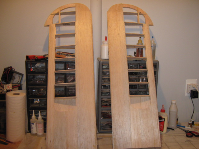

Both winpanels built now. Next a little sanding and joining the panels. Also, now leaning toward a Magnum 4 stroke 90. Just ordered one from Hobby People for $139.99 + shipping.

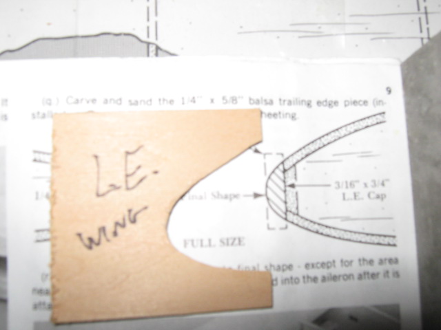

Another minor comment; while I agree sanding the leading edge of the wing as illustrated on the plan, I thought it worth mentioning that I made a simple jig to ensure the proper foil is maintained thoughout the length of the wing. Made the jig in 5 minutes or less, and I think it's worth the effort
