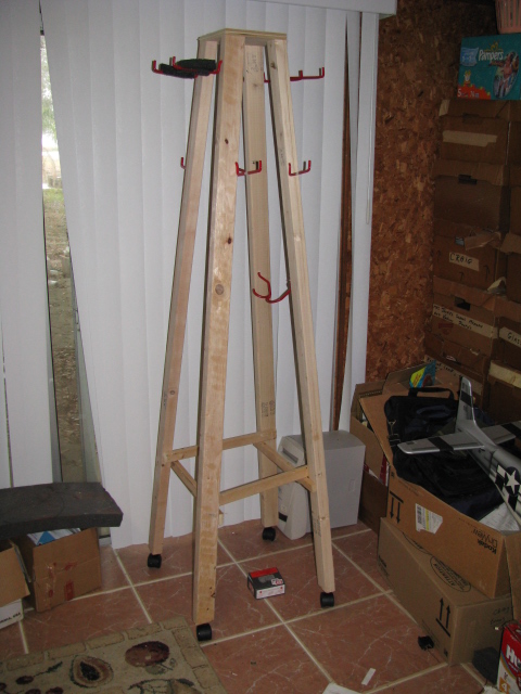

I didn't know where to put this, But I wanted to share my Storage Project. I call it my "Airplane Tree". I am able to store 5 (The Smallest one on the inside of the tree) fuses in about a 3'x3' area.. It took me about 2-3 hours to make, and less than $20 in materials.. I even had some casters that I put on the legs, and I am able to turn it whichever way I need to get to the fuses..

I have since put padding on the hooks so that they don't leave nice little indents on the stabs.
I decided that it's best if you can find 4 straight 2x2's(it's not as easy as it sounds, most of the 2x2's are twisted orwarped.) Anyway, I used my compound miter saw set at 5 deg miter and 5deg tilt. Cut both ends, that's what makes the tilt of the legs, andhas the top and bottom parallel to the floor. the top ply piece is 8x8"then I just tied the legs together with 1x2's. it's nice and sturdy!Mine is 6' tall, but I could have gone shorter, you see how far off thefloor that Ultra Sport 1000 is off the floor. I probably could havegone 4.5' or so and still have been good. I got the hooks at Wally World for about a $1 each.
