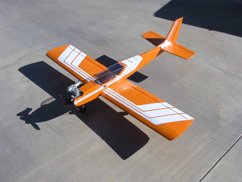

Got my Tiger 2 done and got in three flights on a very windy and gusty day. So gusty the airplane would weather-vane into the wind when taxiing downwind or crosswind. Once in the air, the airplane flew beautifully even though the winds were strong. Put an OS .35AX on it and love that new slanted needle valve arrangement. Perfect power for this airplane.
So here is the only flight squak:
Main gear are too far forward so the plane does not sit on the nose gear without fuel in the tank. Difficult to taxi in strong winds.
That's it! Superb flying airplane and I can see it will be a lot of fun. The kit itself was missing the wingtip balsa so I built up my own. Put in a lot of lightening holes in the dense balsa provided in some areas, and the wing is really over-built with those large square basswood spars AND sheer webs. I just got back into the hobby after a long absence and the Tiger 2 is going to see a lot of touch-and-go's and aerobatics. I think the Tiger 2 might be the best wind flyer I've ever had except for a very heavy Stephens Acro design I flew once.

Old 03-04-2010 | 09:20 AM
HFrank's Avatar
Posts: 224
From: León, MEXICO
Default RE: Tiger 2 First Flight Squaks
The landing gear is not too far forward, your engine is a bit small, I have this plane with a GMS 47 and the nose stays in the ground just right. Congrats with your Tiger2, is a great airplane.

Old 03-04-2010 | 12:32 PM

Old 03-04-2010 | 06:48 PM
thailazer's Avatar
Joined: Mar 2008
Posts: 1,593
Received 7 Likes on 7 Posts
From: Liberty Lake, WA
Thanks all for the comments.
I love the CG where it is based on how it flew and how well it slowed down for landing. Very stable.
MinnFlyer.... I remember your comments from another thread I believe, and I think my landings should eventually bend the gear back on its own! The gear steel Goldberg is using is really well treated and springy (tough to bend), and all of the angles are 90 degrees or 0 degrees exactly. I think they intended to have the gear swept back about 5 degrees as that would solve the problem. I had a Tiger-like model I flew for years that I called The Scavenger as it scavenged parts and engines from other planes I had. My gear was further back and it could handle engines from .25 to .60 without having a gear balance problem.
Checking the plane over I found a loose wheel collar. And I thought I had tightened them all! Happy building and flying....

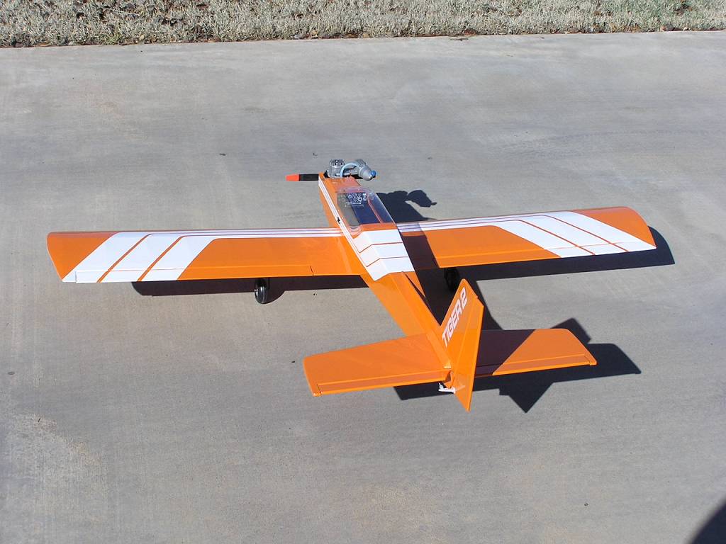

Old 03-05-2010 | 01:43 PM
Posts: 18
From: Lawton, OK
I flew my Tiger 2 for the first time on Saturday. It flies great, I don't have the problem with the gear. The gear on the wing slant back quite a bit though, I would say about 15 degrees. They were installed per the plans, mine is also kit built. This is my first complete kit build. It feels pretty good to build one from a kit and then have it fly so well.

Mikester, Very nice! My gear has perfect 90 degree and 0 degree angles to it. I tried what MinnFlyer suggested before I covered the ship and the gear do not have that rake angle you have. That 15 degree rake angle would completely resolve my problem so I guess I just got the wrong parts in my kit. That and that fact some balsa was missing must make it a Monday manufactured kit! Congrats on the Tiger 2!
Old 03-05-2010 | 07:27 PM
Posts: 18
From: Lawton, OK
Thanks. The angle comes from the hole in the mounting block in the wings. The instructions show to install the block at an angle. Maybe you could bend your gear, but they are pretty tough to bend. With a good vise and some leverage it could be done. I have an LT40 and the gear on it bends by itself frequently, and it is difficult to tweak. I'm sure you'll figure it out. I couldn't be happier with how good my plane flies, seems easire than my trainer really, flies like it is on rails.

Old 03-08-2010 | 08:25 AM

Old 03-11-2010 | 08:05 AM
thailazer's Avatar
Joined: Mar 2008
Posts: 1,593
They say a picture is worth a thousand words. Here's the reason moving the CG back a half inch or more would resolve the tipping back problem. (In the stock Tiger 2, the CG moves behind the axles if the nose comes up for any reason.) Of all the models that I have built and flown, the Tiger 2 is the only one with this problem. Easy to fix.
