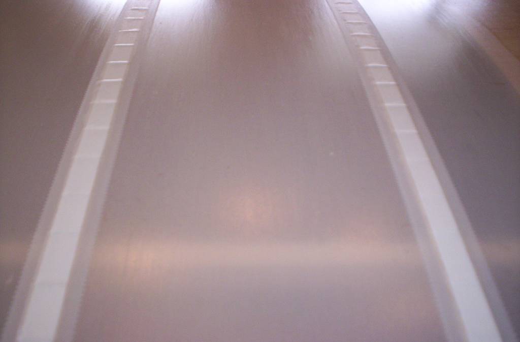

You will like the tapes from Pink-It, I have used them on several builds.
The trick to the tapes is to iron them down as you go from stitch to stitch making sure you iron it down well on each side of the stitch. I found this method gives the best effect. Aftter the tape is down run the iron down along both side of the tape to assure the edges are sealed down.

waco what do you use to simulate stitches..someone gave me theidea to use monofilament fishing line and glue ut.what do you do on the bottom tape that the sitch is glued to?how long do you wait to brush nitrate or whatever over the tape.I am going to contact gary and have him walk me thru all this .I researched spacewalker photos and came up with a great color combo...

what is the bottom tape ?a board of some kind ?and this is partof the kit?

What you are seeing is the rib stithing. It is from Scale Rib Stitch, do a google search.
It is a self adhesive strip with the stitches on top. There is a paper layer over the stitching that you peel off after apply the stitching to the plane. You buy the scale you need then cut them to width. The rib tapes are over top of that and ironed down. I did not apply any dope over the tapes just a coat of primer before paint.
I bought rib tapes and perimeter tapes from Gary for my Waco. I also applied tapes over all the fuse stringers just like the full scale. Adds a nice little touch.
