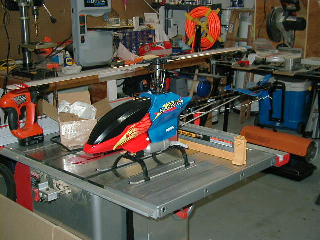

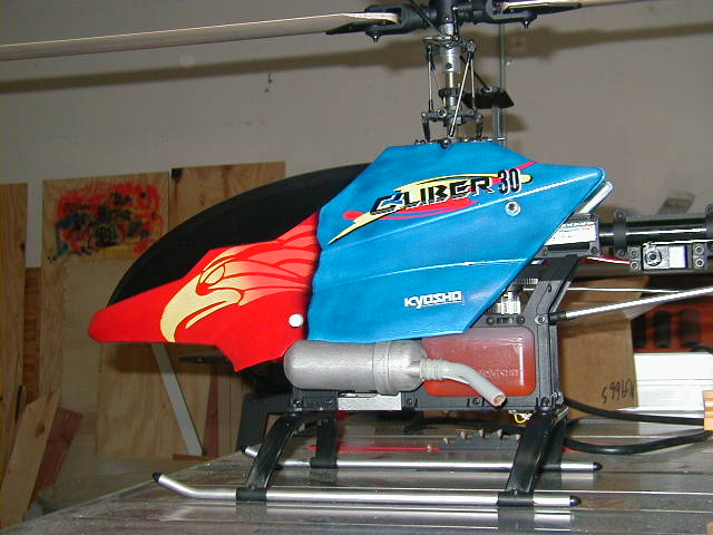

I also, recently got a caliber with the 7CHP. here's what I got: 4-S3151 servos, 1-S9254 T/R servo with GY401 gyro. If you go into the reversing menu on the radio I got channels 1,2, and 3 reversed. HR3 type swash, with Ail @ +76, Ele @ +97, and Pit @-75. My gyro is set to: DS Sw to ON, and Rev switch set to Rev. Delay at 0 and limit to 100. Hopefully this will help you out. I'm still messing with throttle and pitch curves if anybody has any idea's. I have my Gyro setup on sw B with UP @A 75% and DN @N 30%. It still wants to yaw alittle so these settings are good starting points. Well The AVCS is. I put it in Normal today and It started spinning pretty bad. I hurried up and put it back in AVCS (sw B up). Today was the first time I got it up in the air because of a training gear failure a week ago. I busted the tail gear housing and a blade when one of the training dowels slipped and cause my helo to go tail first in the ground when I brought it down. Notice the new Maverikk tail blades instead of the stock white ones. Yeah, it sucked. Helo never left the ground cause of the gyro settings being wrong, then boom, BROKEN!!! I uploaded some pics of my helo after I got the parts and fixed it up. Hope my advice works.

Nice looking Heli. Though I was wondering why you chose a different swashplate setup from the one recommended in the manual for the Caliber 30 which was the sr3. I still can't find the info on the pitch curve setup I want for the beginners setup which only uses the positive end of the pitch setting so you don't drive the heli into the ground while you get used to it. Sooner or later I'll find it . is it normal for the main drive belt to ride high on the clutch pulley?
Thank You
Thank You
Joined: Jan 2005
Posts: 17
From: California,
MD
The HR3 setting on the 7CHP is the same as SR3 in the 9C I quess. There is no SR3 setting in the 7CHP. If you look in the 7CHP manual on pg 61, it explains the different swash plate settings. If you set you CAL-30 up with eCCPM then your running 120 degree swashplate, which is HR3. At the top of that page it also say what type of helo the Cal-30 is. Hope this explains it. Not sure about the belt. Next time I fly i'll take a look at it. Have fun.
