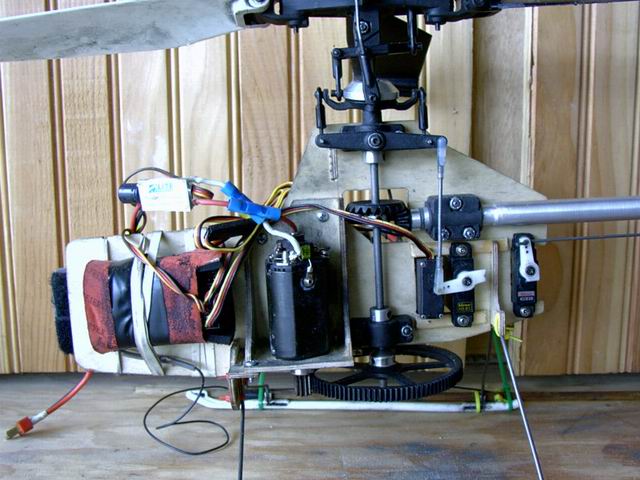

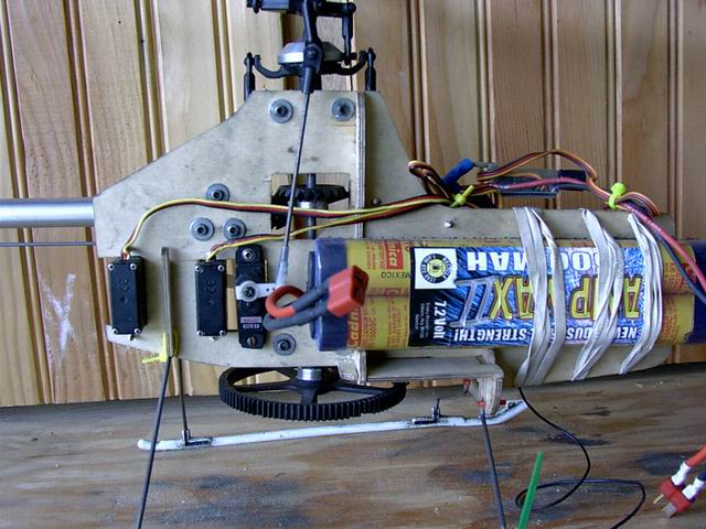

Just finishd her last night. I originally had the battery beneath the crutch, but it just feels more solid in its current position. Yes, I went with the fusion (burn-out) motor, but I ordered it well before I came across this site. Let me know what you think - comments, ideas, tips. She will take her first flight in 3 hours over my lunch break - lets hope the arlton gyro likes the new weight. I've been waiting for this for 7 years since I bought the LMH 100+. . . [:@]

Looks to me as though you've wrapped your Rx antenna around the boom. There's a couple of really good reasons why I wouldn't want to do this - best to try a different system I think
Good luck,
Tony
Good luck,
Tony
yea, I was thinkin the same thing!
I would run a Deans or simular....Just to be safe
.02

Wrapping the reciever wire around the boom. its best to run the wire out and not coil it around anything. Or go with the deans antenna. I use to wrap my antenna wire and I was loosing servos left and right. I stopped wrapping my reciever wire and my servos stopped burning out. So, I figured somehow signals to each servo were being strained causing my servos to over heat and burn out the pots. I could be wrong but I havent had a servo failure since and its been almost if not a year now. I was loosing a servo on average of one a week.
Your fore and aft cyclic servo seems to be in a strained position. Also I made me a new crutch (homemade) based off the Corona crutch. The motor in the pic lasted a few flights and died, right now I have a EF7 mounted. This crutch is also a little taller than stock with a taller mainshaft also.

I did notice some servo issues while my antenna was wrapped on the boom - I'll move it ASAP - thanks!

Question!!!! Will having the battery on the side of the crutch cause the heli to lean towards the right in flight?

i have my battery on the side of the crutch, I have an 8 cell pack and i really dont see a problem. Ive heard others say their heli seems to lean a little while hovering. i havent noticed a problem with it. About the trees, yea, they do tend to reach out and grab the heli once in a while. Hey, theres tons of stories here in these forums.
