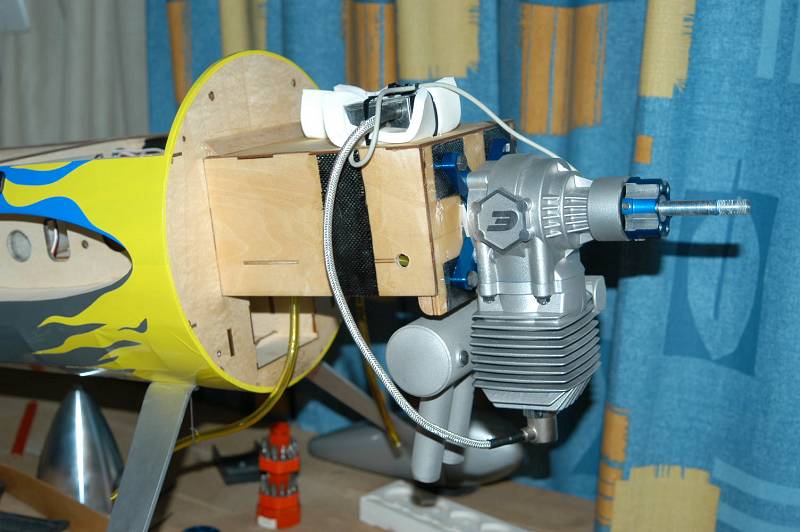

Old 07-31-2005 | 03:34 PM
Joined: Apr 2005
Posts: 130
From: PERTH, AUSTRALIA
Default RE: mvvs 58 problem
hey guys,
here are a few pictures.
aerowiz
ID:	303856   Click image for larger version
Old 07-31-2005 | 04:23 PM
Posts: 6,571
Received 5 Likes on 5 Posts
From: Arcen, , NETHERLANDS
Looking good.
todo:
- fix those rod guide ends to the engine pod, so you will get precise lever movements
- Isolate the muffler heat from any tubing that runs near it
- Isolate the ignition from the engine heat, and provide for some cool air around that critical component.
