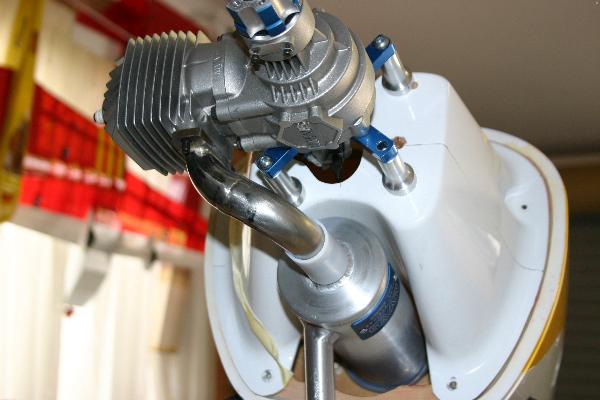

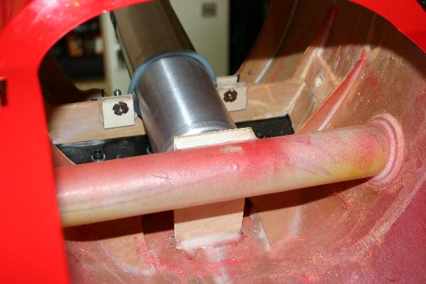

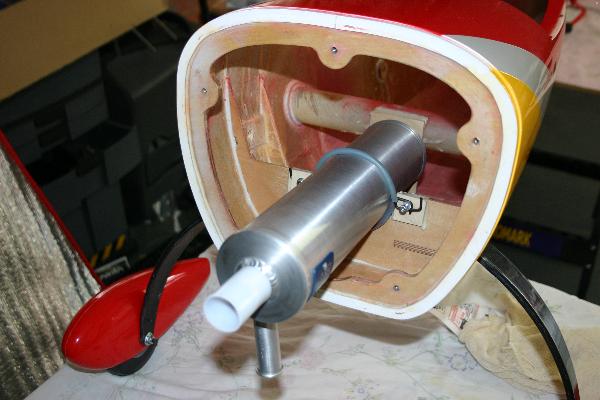

I have had a request for information on the pipe install. here are a couple of photos
Please note - that both ends had to be shortened to fit ... and the angle of the motor is down from 90,degrees (see CARF world - germany)
Dom
Dom
Dom,
The installation looks good, especially the way you hung it in silicone covered cables and the way to prevent it slipping back.
How are you going to cool the pipe?

Cooling - I have used some ceramic cloth (from BVM) to protect the wing tube and the UC,
And the are big holes in the bootom of the fuse - aft for the pipe to suck the heat out
Dom
