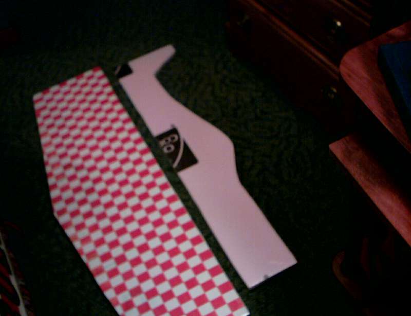

Covered in the same stuff. I have found the foam doesn't like the heat from an iron too well, so Monokote is out. It's just standard sign vinyl. Go to a sign shop, or better yet, a sign supply wholesaler.
I made the span 50 inches instead of 48 to handle the extra weight of the MDS .68. I also double beveled the hinge points, which gives me 90 deg. of deflection. I'll set up the controls for 60 deg. I also integrated the landing gear mount with the hardwood motor mount, so it's one piece. The HOTS had a little 2x2 block glued in for the gear. It held fine, but it was at the bottom of the fuse and caused a twisting stress crack in the foam from hard landings. This is in the center, meatier portion of the fuse. I also used tri-stock balsa at the wing/fuse joint for a bit more strength in the wing mount.
Look at my page for the pictures.

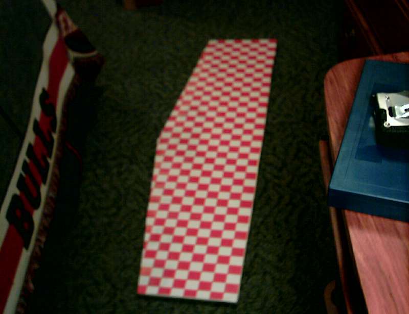

Where did you get the checkerboard vinyl? I am building a profile now and would like to build one of these next month. I have all of the foam, vinyl, and yardsticks.
Joined: Feb 2003
Posts: 688
From: Omaha, NE
That's not checkerboard vinyl. You have a few options here:
1: cut squares by hand and stick them on
2: use Monokote's checkered detail. It's self-adhesive, not heat activated
3: print them on your computer on regular paper, trim and stick on with 3M Super 77 spray adhesive. Then cover with clear vinyl or packing tape.
I did option #3 and covered with the thinnest packing tape I could find. I've been using this technique on my planes for a few years now. Weight is not too bad, and I can print any color/size checker I want.
