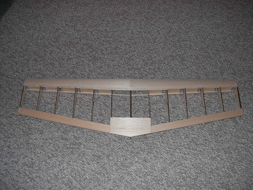

Old 08-05-2002 | 12:42 AM
Posts: 6,378
From: Bloomington, IL
Default Sledge 540 progress.
Both wing panels are framed and joined.

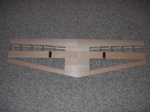

Old 08-07-2002 | 12:28 AM
Posts: 6,378
Got some of the top sheeting on tonight.
Old 08-09-2002 | 12:41 PM
Posts: 1,515
From: Georgetown, IN
Default I beams
Wayne, the pictures make it look like the I-beam wood is not touching on all four sides of the rib and spars. Let me know your intent on that. Keep the pics coming and I will keep watching your progress to check that you are going in the right direction. Everything else looks good. Jeff
Old 08-09-2002 | 01:15 PM
Posts: 6,378
Jeff,
I used the wood supplied for the Shear webs (I-Beams) with the grain going vertical. Doing it this way, the pieces arent wide enough to fit completely inbetween the ribs. They are glued up against each rib on the inboard side. Same support as far as I could tell and a lot less work on cutting them to fit.
Wing is just about done. Need to build the hatch covers and do the cap strips. Then its on to the sticks!
Old 08-10-2002 | 02:20 AM
Posts: 6,378
If I would stop flying my New Aero-Works Edge maybe I could get more work done on the Sledge.
Bottom sheeting is done and Aileron servos installed.

Old 08-10-2002 | 02:51 AM
Posts: 1,515
Default sledge look
Wayne, that is fine I would think. I never have flown one without the webbing being I beamed on all four sides. You will be the judge if that is strong enough. I know the way I have done it is very strong. By the way, the bottom of the wing looks right on. Keep up the good work, soon we will see fuse shots and flying surfaces from Wayne. I need to order a kit from Morrris to start the construction video.
