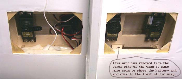

Battery and receiver mounting.
I cut some a piece of the vertical piece of the ply out to give me room to stuff the battery and receiver as far forward as possible in the wing. Used the foam rubber bought from towerhobbies. I'll take a pic and post it. I don't think I will be adding any extra weight for balancing.

I have a 1,1000 mah nicad stuffed in against the front of the wing held in with foam rubber and a popsicle stick.

Posts: 214
From: Prospect, KY
Default Another Pic Rec Battery
Here is how I mounted the Bat and Rec
