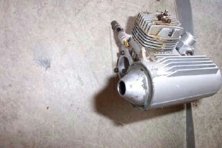

OS now makes a OS32SX. the 32SX replaced the 32F. I think the 32SX has been in production for over 3years now. Because I know I have had mine for over 2 years.
The 32F didn't have the remote needle valve and few other minor changes... the older 32F is a little lighter and just a tad stronger than the 32SX from what I have been told from a guy that has both.
But I have the 32SX and I have ran it hard for over 2years, and its still running strong. cranks a 10x4APC at 15,200peak w/ this muffler configuration.

This is the add from O.S. about the two engines.
O.S. .32 SX Output BHP 1.2 at 18,000 RPM Practical Range 2,000 - 22,000
O.S. .32 F ABC Output BHP 1.02 at 16,000 Practical Range 2,000 - 17,000
And what is that muffler ?

My muffler on my 32Sx is the front half of muffler. I lost the back part while flying. I had the baffle in the box. So i CA'd the baffle on the front half of muffler. It worked so well, gave me tons of power. so I ended up JB welding it to the front half of muffler. I have used it for 2 flying seasons. it is messing, exhaust just goes everywhere.
But I am taching a 10x4APC at 15,000 peak.. That is the same performance that a moosecan will do. But this does't cost a thing.

Ya but how loud is it?????
