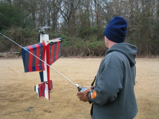

Default Yea, it is enough
OS46 FX. Think it is enough?

looks like more than enough.....I just don't know if the sf .46 has that much power.

Old 12-16-2002 | 08:23 PM
m.gramling's Avatar
My Feedback: (8)
Posts: 1,788
From: Atoka, TN
Default Engine for OMP edge?
I saw vr1vrv2 fly his omp edge at propbusters field in memphis,
He was doing harrier rolls about 10ft above runway. And torgue rolling it inches above the ground. I actually saw him T-rolling a stock stick arf inches above runway. I got pictures.
He is one of the best pilot I have seen. Just about anybody can T-Roll a 40%. But it takes skill to get a .40size profile and a stick arf as low as he does.
I am a fan of his.
