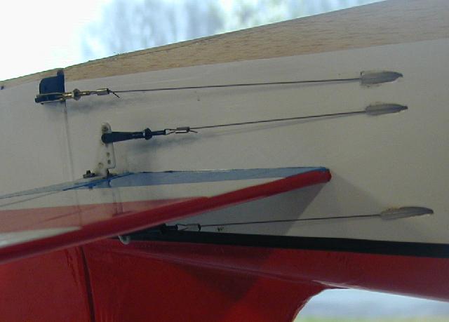

and another view of the tail. There are actually small pieces of teflon tubing inside the pushrod tubes where they exit the fuse.

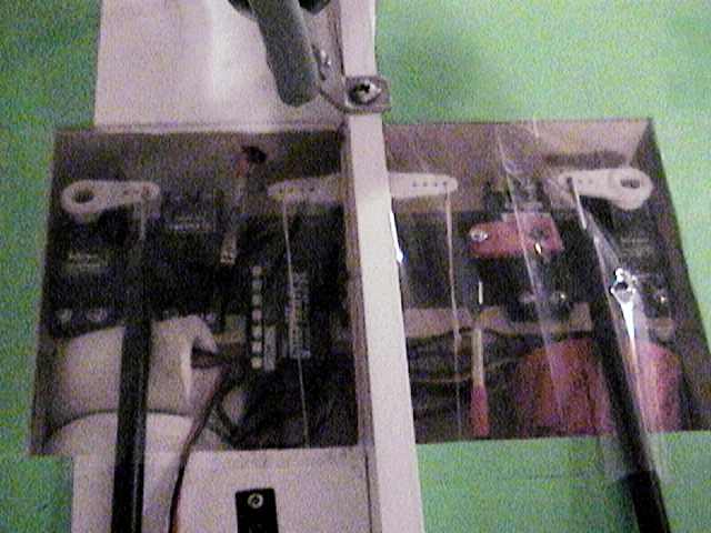

i just dont get how a elevator pull pull would work without the servo being mounted sideways???
Old 03-21-2002 | 02:15 PM
  #28
My Feedback: (11)
Posts: 819
From: Greensboro, NC
Default Pull-Pull Systems
Shortman, Look at the fuselage pic above. The two wire connection is the rudder. The 4 wire connection is the elevator. All 4 wires come together inside the fuse near the wing. The wires work just as a pushrod works with a servo mounted upright. As long as there isnt a severe bend in them, they move according to the geometry of the motion of the servo. Just look at it as a rudder p/p on its side at the surface, and normal at the servo. There is absolutely no slop in this arrangement, and it does allow you the ability to still have some elevator control in the event of one wire breaking. The 4 wire method only works on split elevators. It would be overkill to have it on a single surface elevator.

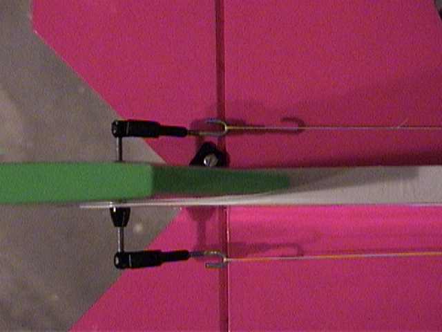

The lightest way to do pull-pull is with the least amount of hardware. I use K&S #49 Kevlar from Tower Hobbies. It costs 2.69 for about 100 ft. I tie it directly through the servo horn and secure it with a drop of CA. On the rudder end I used a short peice of 2 56 rod with a loop in the end like jmulder. Very strong and light and CHEAP.

Rudder end

Does this hold well Razor Sharp? To me it would seem safer to just use a clevis or something. Have you had any problems with your setup?
Thanks-Brian
Old 03-24-2002 | 05:08 PM
  #35
Posts: 36
From: Kaufman, TX
Default Pull-Pull
Not a problem yet. This is how Don Incoll does all of his wasps.
