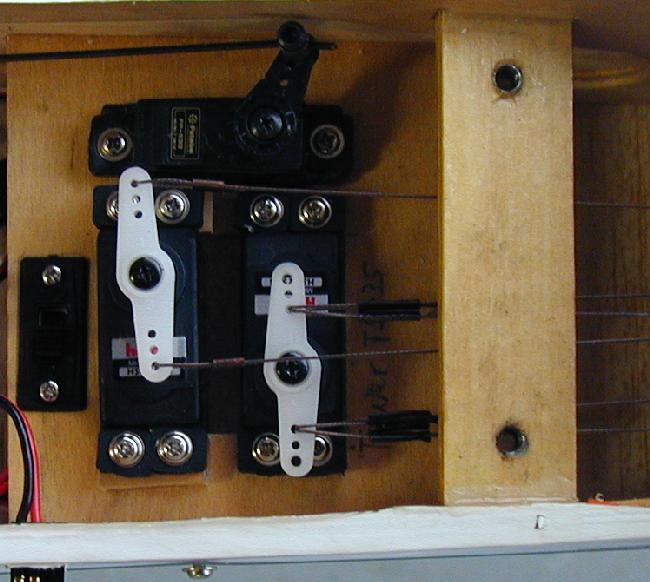

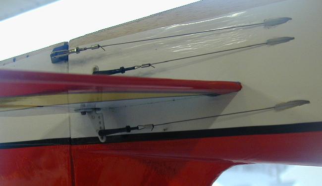

My majestic pattern plane has a 6 wire pull pull system on it. two wires for the rudder, and two wires each for the split elevator.

I will try to take some pics at lunch, and post them when I get back. Basically works the same as the rudder. Since my elevator is split into two halves opposite of the rudder, I have a wire on the top and bottom of the elevator half. The opposite half of the other elevator meet at the servo, to give proper input. Meaning the top of one will meet with the bottom of the other side, and vice versa.

Default pull pull pics
Here are some pics of my majestic's pull pull system. This is on a .32-.40 sized pattern plane, that is getting an enya 80 four stroker on it
I know there are a couple of bolts missing, but I am recovering the plane, so i slipped the linkage back on it for the pics.

Another pic
