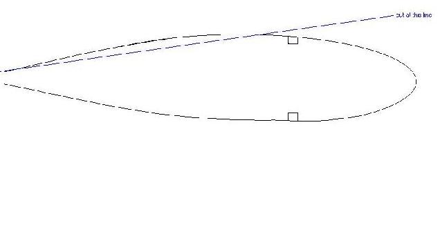

You might want to change the airfoil slightly on the Stickit IV. One of the problems with the IV was a tendency for aileron flutter at higher speeds. I think this was caused by the rearward highpoint of the airfoil. Just put a straight edge on the rib from the rear of the spar to the trailing edge and cut off the curvature, this seemed to help quite a bit. You also might want to look at different motor mount materials. We used 1/2" ply in the kit for economy purposes, but actually flew using the CF/balsa laminates.
for clairification.... You talking about laying a rib flat on the work bench, then laying a straight edge over it from the spar to the TE and cutting the above portion off. Same for bottom...... Right?
Posts: 148
From: , ,
Its been awhile so the pic below isn't too scale but the airfoil
mod cut is there. Might let Assar verify but this is how I remeber
the mod.

Miderror: I assume I should cut both the top and bottom of the wing rib? I get it now, thanks for the pic.
Azarr, What do you think?
I think I will do the 2 laminations of c.f. to make the 1/4" nose plate.
