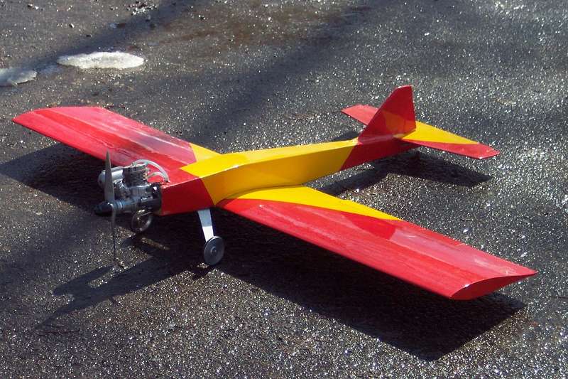

Well, here it is.... If anyone sees anything that looks off let me know. What should these (46fx stock) turn for RPM with a 8.75x8.5??
Thanks in advance.
Thanks in advance.

looks good Lee.
A couple things.
You should be able to peak that prop between 15,000 and 15,500 rpm with the O.S. FX. All you need to do to that engine is take the baffle out of the muffler. Leave the head and sleeve spacing alone, it does very little difference. I would suggest one of the following plugs in my order of preference: K&B HP, McCoy #9, K&B 1L. Keep the engine about 500 rpm off peak, with that prop, you need to keep it rich to allow it to unload in the air.
Are those aileron torque rods on the bottom side of the wing? If anything else, thats interesting.
Those look like alluminum wheels. If they are the wheels I'm thinking of, they are very heavy. There are some inexpensive "poker" style wheels available at www.lcsperformance.com or even better (still relatively inexpensive) pizza cutter style wheels their also.
I wouldn't get to worried about making changes to this plane, for now I would just focus on trying to fly the course.

It looks to me that you have your gear on backwards. The wheels should go under the leading edge of the wing. However, if you're flying off grass, perhaps you meant to do that?

I believe we are flying off grass, however, I will test it both ways if the snow ever melts.
As far as the RPM goes, I ran it up at lunch and it was actually around 16K full lean. If I understood right I should richen it up to drop about 400-500 RPM. I guess I can test all that at the the field to make sure I don't have it too lean when the prop unloads.
In respect to my aluminum wheels I haven't yet had the opprotunity to lighten them up yet. My dad has a milling machine and laithe
Lee
