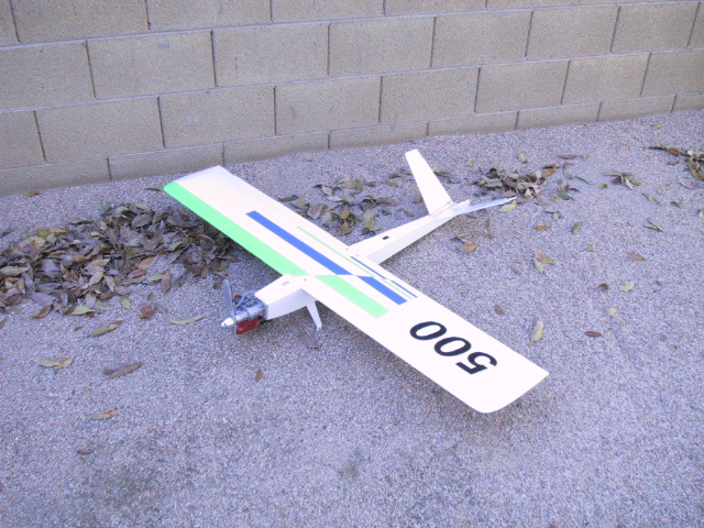

Old 11-29-2004 | 04:38 PM
Joined: Jan 2004
Posts: 96
From: Flagstaff, AZ
Default RE: is there a Q500 construction thread?
here are a few pictures
ID:	197771   Click image for larger version
ID:	197772   Click image for larger version
Old 11-29-2004 | 09:34 PM
Joined: Jun 2003
Posts: 25
From: Glendale, AZ
i think the best part of that plane is that sweet jr rx battery pack
Old 11-30-2004 | 11:34 AM
DHG
My Feedback: (7)
Posts: 928
From: Arvada, CO
I would strongly suggest wrapping that battery in foam ... vibration not good .... vibration veddy veddy bad.

Old 11-30-2004 | 10:13 PM
Joined: Jan 2004
Posts: 96
From: Flagstaff, AZ
o yah? i didnt relize batterys cared about vibrations>? il wrap it before myu next flight.
