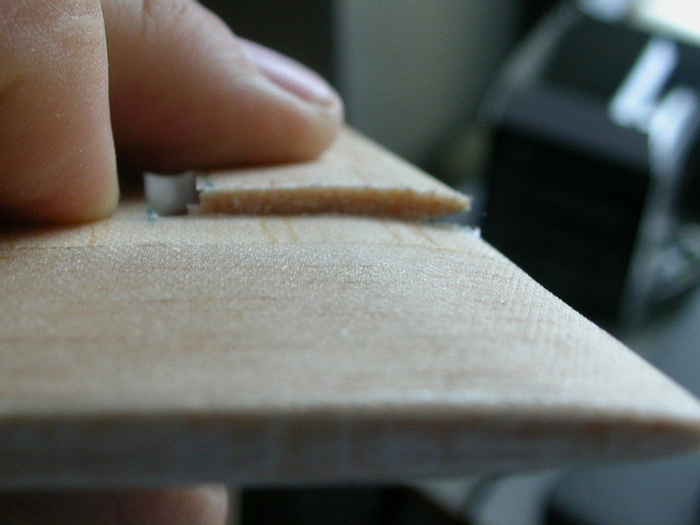

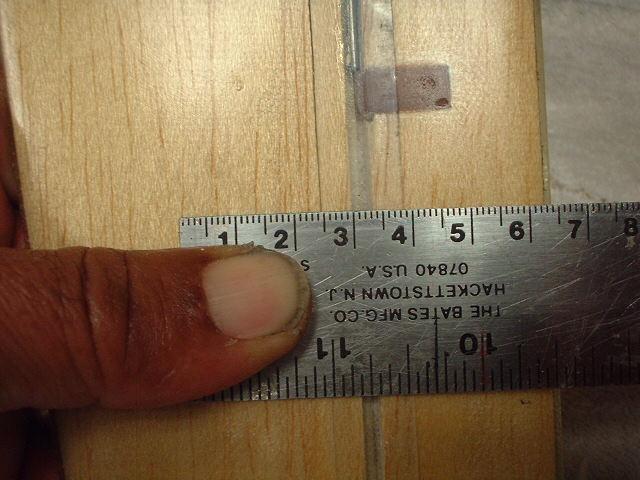

Howdy, here's a little more info for those that might want to try out the skin Hinge thing,,, but just aren't quite sure.
Experiment and Test with a scrap peice of balsa, some cloth, a peice of mylar, some 5 min epoxy OR with the epoxy that you are going to be using for the actual skin hinges on your wing. Mix a small batch of epoxy,,, lay the cloth down on the balsa and apply the epoxy. Next is to place the plastic over the work and squeegy out the bubbles and excess. Wait for this to kick off, about 5-7 mins and then just peel away the plastic!
Next is to flip the balsa over and cut a small groove, about 3/16-1/4 wide, to expose the bottom side of the fiberglass.
And there you have it,,, a fiberglass skin hinge

Default Skin Hinges,,, First Time Experiment!
On the test peice,,, it make no difference how the groove is cut.
On the wing, I cut straight down

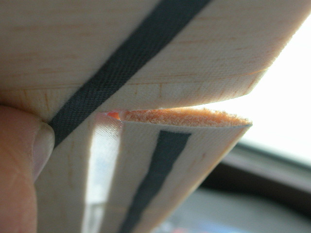

I post some pic so understand me, I have use 4-40 push rods and one layer of 2oz glass.
And as you can see, I did not mount these tail because of the flutter or what is called.
Old 04-11-2003 | 12:20 PM
Per_N's Avatar
Posts: 207
From: Stockholm, SWEDEN
This pic when I press a little down wards.
Old 04-11-2003 | 12:21 PM
Per_N's Avatar
Posts: 207
This pic when I press a little up wards.
Any suggestions Bill?
Old 04-11-2003 | 12:25 PM
Per_N's Avatar
Posts: 207
Default Bill&Daven
Some more info.
The gap is 6mm or 0,236 Inch
Per
Old 04-11-2003 | 03:26 PM
Posts: 1,987
From: Apple Valley, CA
Per, Good pics!
Add another coat of epoxy resin to the top surface only to fill in the weave of the fiberglass. I have a feeling you did not use enough or scraped off to much because I can see the pores of the weave in the fiberglass. By doing that should help to stiffen things up a bit and you should be Good To Go

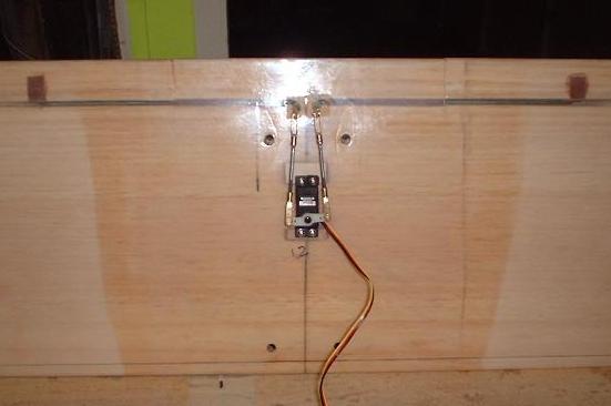

Old 04-12-2003 | 02:27 AM
Posts: 1,987
Per, here's a pic of my V tail on my recently retired Racer,,, its the plane you see me holding on the left<<<<------- The hinge gap is approx 3-4mm or 1/8"
I have the same type of deflection that you are talking about in the above posts,,, its also on my Vortex and Neme Q V tails, just not as much as you have. I really beleive that there's not enough epoxy on your hinge lines.
Brush on some more epoxy over the hinge lines,,, that will stiffen things up to a more satisfactory level
