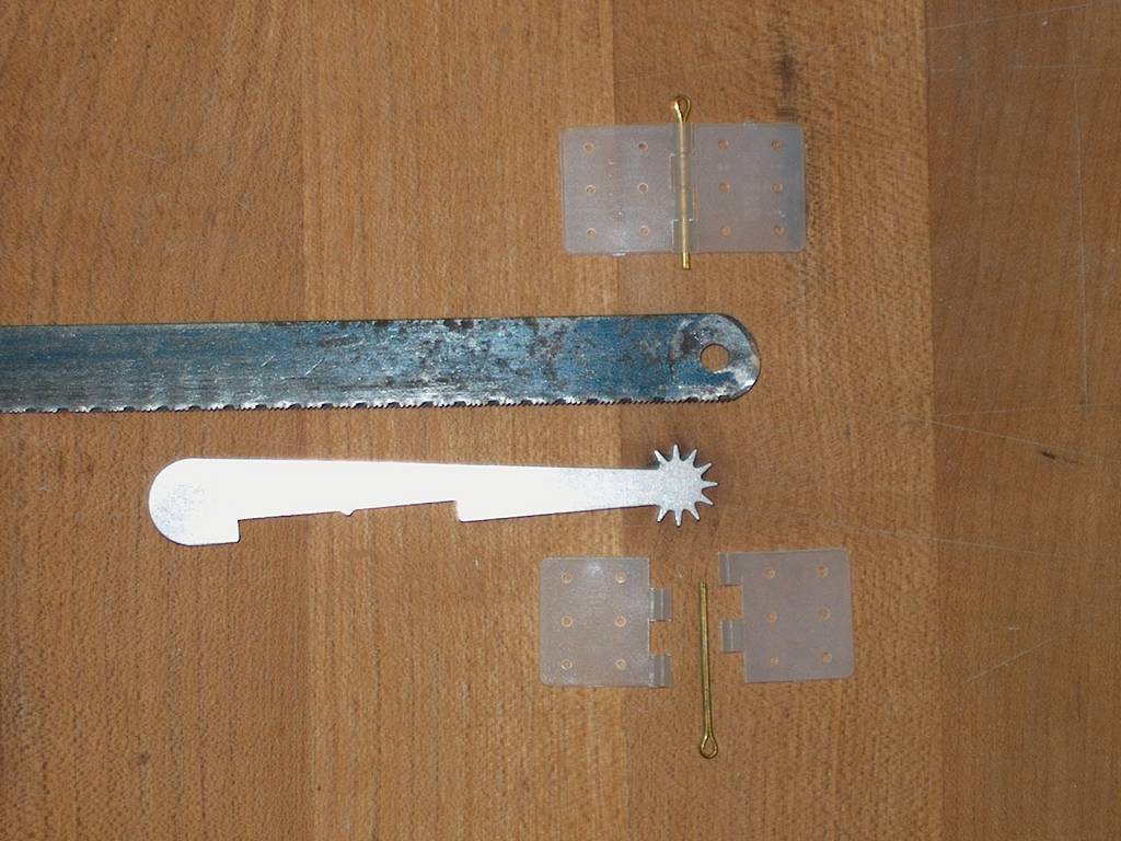

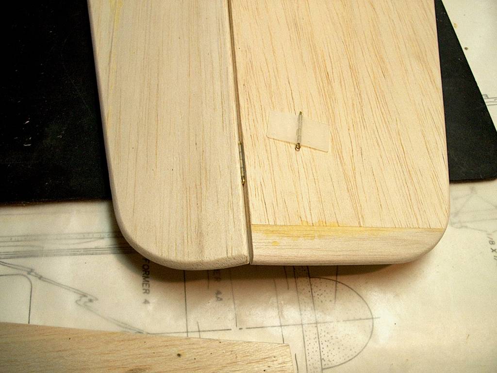

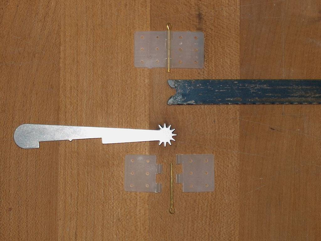

Ooooo. I lose two points for reading incomprehension.
Irecess the to the pins. Digging out the slot with a hacksaw blade ground to a round edge on one end and a "V" cutter on the other, then the Nibbler to clear the slot. You can also swap a singlelength of 1/16" music wire along the whole hinge line instead of using the individual pins. Easier to pull out and seals the slot.
