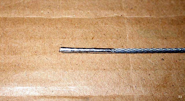

I use silver solder on both ends of the cable to keep it from fraying, and I use EZ connectors on the throttle arm and the servo arm. I'm about to do one, so I will post some pics.

Here is a picture showing one end of a Dubro flex cable before silver solder is applied.
Old 01-27-2005 | 11:07 PM
Richard L.'s Avatar
My Feedback: (24)
Posts: 8,788
Received 4 Likes on 3 Posts
From: Renton, WA
Default RE: Throttle Push Rod Connection........
Here is a picture showing the same end of a Dubro flex cable after silver solder is applied:

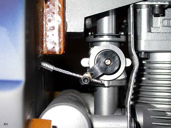

Since the throttle arm is much lower than the throttle servo, here is a picture showing the angle of the flex cable:

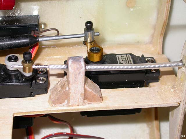

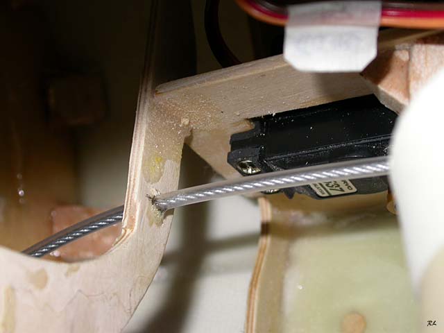

Here are two pictures showing the path of the flex cable inside the fuselage. Make sure the end of the cable at the throttle servo is at the same level as the EZ connector on the servo arm. Even though the path is not straight, the braided cable still moves freely with very little effort, just like the braided cables inside your bicycle brake lines.

The braided cables are great. Just keep in mind that the plastic sleeves needs to be supported very close to the end with only a minimal amount of the braided wire hanging out. You can see this in Richards pics. The braided cable will flex really easy without the plastic sleeve so it needs to be supported close to the end.
