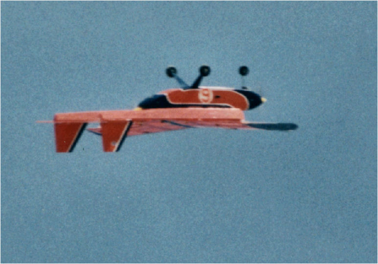

All right, here's the deal. I like to build junk with stuff lying around and see how good it flies. I'm currently building a push/pull airplane with some gutter downspout, an old wing I have and stuff like that. The thing is that I don't have two identical motors. Right now I have a thunder tiger 40 on the front and a LEO 28 on the back. As you all now the thundertiger 40 has about the same thrust as me blowing through a straw and the 28 LEO seems to be matched pretty good with it. From what I can find the LEO 28 has about .90 bhp and the TT Gp 40 has about 1.0 bhp DO you folks think that since it is a push/pull that that will make any difference.
Keep in mind that all though I plan to fly it, I'm not trying to make it perfect, or expect it to fly like a kit or anything like that. I just like to build it and see how much fun it can be to buzz it around. It is not going to be featured at any airshow thats for sure.

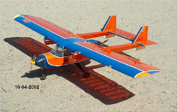

It should work, if it's not too heavy.
Keeping both motors running will be a problem.
With any luck at all it'll fly on either alone.
My push-pull Kadet at 13 pounds flies with two OS 40FPs.. on either or both.
The rear motor usually quits first.

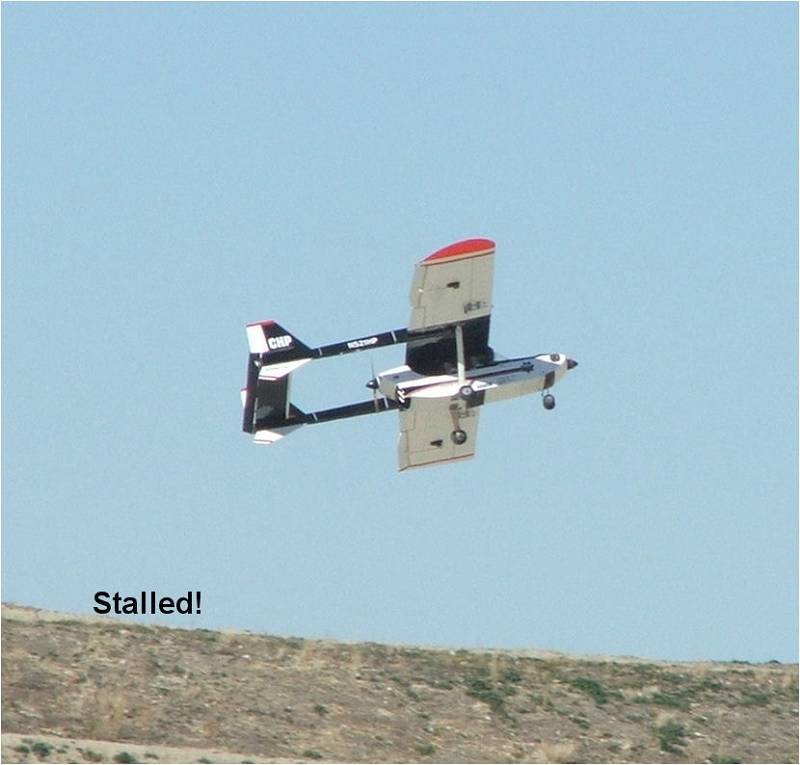

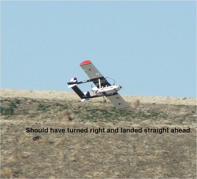

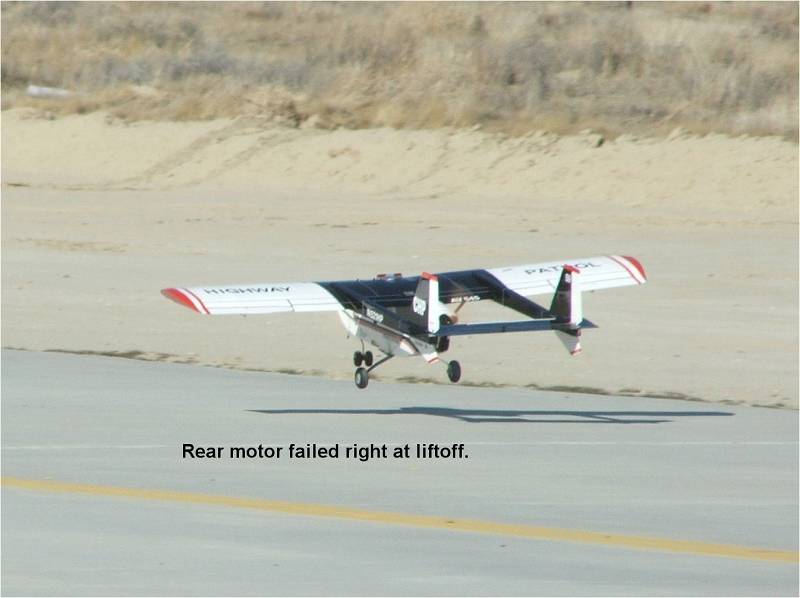

I photo'd this this morning.. rear engine failed on takeoff.. the plane can fly on one, but the pilot didn't handle the situation properly..
Did a left turn after getting airborne, but failed to stop the turn when aimed back at the runway.
Too much elevator stalled it, and the right aileron command tipstalled it.

The needle valve on the rear engine was clogged, and the motor was running too lean.
There's no specific reason for a rear engine to be less reliable than the front.

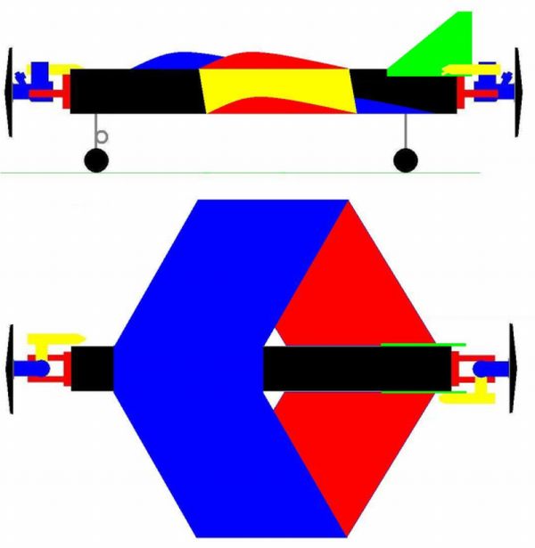

Hey I'm also building an inline twin SPAD. I also don't have identical engines, but only in that one is a Tower .40 and the other is a Thunder Tiger .40. The wings are a bit unconventional though, as one is rear-swept and the other is forward swept.
Hopefully my sketch shows up.
