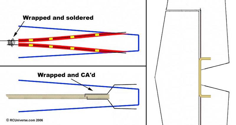

You can run two pushrods, or one pushrod that is split at the rear, or just run a single pushrod and join the elevator halves with 1.8" music wire

Has anyone done a GP ultra sport 40+ with this setup. The two pushrod approach shown in the planes looks like it could lend itself to a little differential elevator. Is the plan setup ok with two pushrods connected at the server, or should I look at doing something more/different?

The way they show in the plans works just fine, but I would add a little solder to that joint just to be on the safe side.

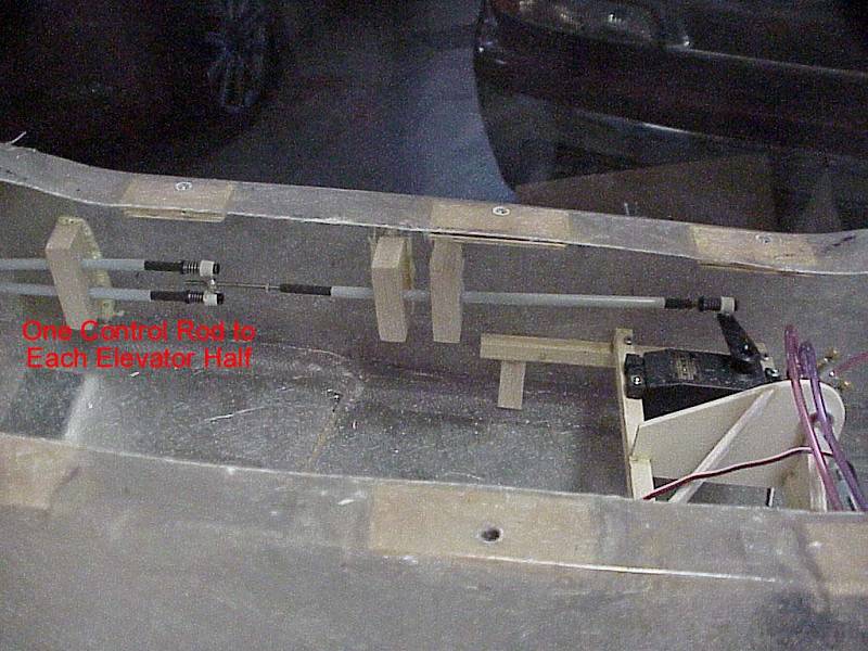

Here's how I have done it on my 104" PBN Nomad....
