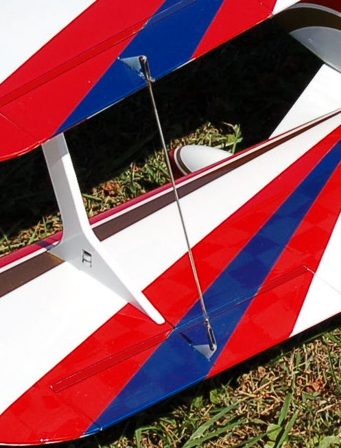

Here is a picture that shows what happens with the rigging that is very often used with smaller biplanes.
You wind up with the uniform movement completely screwed up, a real mess. When the servo moves the aileron it drives directly a certain amount, the paired one will move a very different amount. When the same servo moves it's aileron in the other direction, the paired will move a DIFFERENT amount than it did the other way!
What you wind up with are 4 ailerons moving, with the two that are being driven by the servos moving the same deflection as each other. No problem. But on one side of the airplane, the paired aileron moves a different amount than the one it's connected to. So you got one side somewhat screwed up a certain amount. Now, on the other side of the airplane, the paired aileron moves an entirely different amount than any of the other 3 ailerons.
It's really screwed up and hard to put into words.
But here's a picture of the side of the biplane that has the downgoing ailerons. Let's pretend the servos drive the lower aileron. And the servo on one side is driving down. The servo commands a 20degree deflection and what the rigging does is change that deflection to the paired aileron to 26degrees down. So on one side there is a 6degree difference in deflections. OK, that's just on that side of the airplane.
On the other side, that rigging design doesn't screw up the same when the ailerons are being deflected upwards. Over there, the servo also commands 20degrees and whichever aileron is directly driven will do it. But when that rigging design moves in the up direction, the amount of difference is different. You don't even get the same screwup side to side. On the up side you get 23degrees from the driven one.
Talk about lack of uniformity. You have two ailerons going 20degrees, a third aileron going 23, and the fourth one going 26.

OK, you remember the advice about pushrod connections that goes something like, "always connect your pushrods to servos and horns to give a 90degree angle".
There is a really good reason for this. It's why everyone with any building experience has heard that rule more than once, and heard it said in a number of diffrerent ways.
If the pushrod doesn't make a right angle to the servo with the servo arm or to the hingeline with the horn, the deflection at one end of the pushrod won't be the same deflection at the other end. It's been proven over and over and over. And the people who designed your biplane didn't seem to get it.
Here is a sort of useful picture to show conceptually where the pushrod ought to go and where the connection points should be. The green dotted line is what would give uniform deflection top to bottom. The black dotted shows an often used layout that really won't give you uniform deflection.
Here is how I've got my Skybolt's ailerons rigged.
You will notice that the connections for that pushrod are above both ailerons. If you were to draw a line like the green one in the post above, it would match up with the picture in this post.

OK, here is a picture that shows the lower aileron driven. The painted picture above with the 20/22 deflections was with different wing stagger and was figured with geometry, not just modeled as in this picture. Modeling simply shows what happens without any possibility of errors in arithmetic.
The last picture, if I remember correctly, was a setup I made using the dimensions of a 46size Ultimate biplane. The "paperdolls" are basically templates laid out where they'd be on the plans of that model. It's a dead accurate way to see and measure what would happen on the airplane.
What causes the problem are two things.
The wings stagger. One is appreciably farther forward than the other. This moves the axis of the pushrod off perpendicular. But that's not any worse than the other problem.
When you place one horn above the hingeline (the lower horn) and the other one below the hingelin (the upper horn) you wind up ruining the 90degree angle even more.
You always want a pushrod to create a 90degree angle with the servo arm and with the horn. If you don't........................

Great thread, but I have a question: If the ailerons are connected at the trailing edge (or just aft), will the throw be the same for the upper and lower? I'm thinking that what matters is that each aileron is connected at the same location relative to each aileron, so whether it is above, below, or in the middle (at the TE), it should work fine as long as both ailerons are done the same way.
thanks
Steve
thanks
Steve
Yes it really does matter if you want the best performance from your plane. I built a 1/4 scale Waco YMF-5 and originally rigged the ailerons as shown in the first photo. The top aileron moved a greater distance than the bottom aileron. When the top aileron came down it was hitting the wing before the bottom aileron came close to hitting therefore the rolls were very slow because I didn't have enough total aileron travel.
To correct this I made a tab that attached to the bottom wing to cause the two ailerons to move the same amount. See second photo. The plane roll rate was much better after this.
