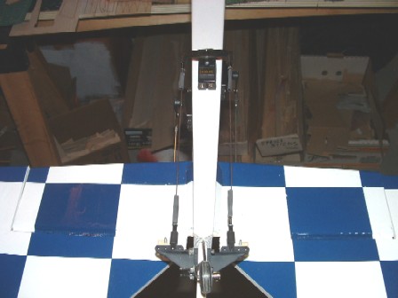

Does anyone know if you can have the servo off from the fuselage centerline on a pull/pull rudder set up. I bought an arf off ebay that is set up for a side by side servo install for the elevator and rudder servo, but came with pull/pull cables for the rudder.

UcanDo-46 works well.

Looks nice, but the kit is kind of a speed plane so I would like to keep everything out of the wind.

Crossing the cables would not have any odd effect when installing the servo off center line of the plane.

I've never seen a pull pull set up with the servo off of center...seems like one side would be real slack when the contol surface was moved to the longer cable side......

Its ok you cant push with a cable anyways as long as there both tight at center what the none pulling cable does when the other is under tension is of no importance.

It'll work fine. As long as the servo is mounted around the wing area and not directly ahead of the tail. If you do the math, you will see that there will be some difference in the amount of throw you get from left to right, but the difference will be so small that you won't notice it. Before you go and mount the horns, do a search on here for "Ackerman". It's important to know about when setting up a pull-pull system.

I have used fishing wires on many F3D pylonracers on both elevator and side rudder. Servo off set doesn't matter.

I have the servo off center on my float plane and the cables cross each other on the floats and it does'nt make any difference.
