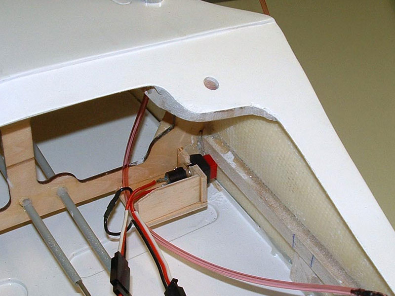

I have made my own by buying a push-on/push-off switch at Radio Shack.
Mount it inside the fuse near the side and drill a small hole that you can push a pin, Hex Wrench or small screwdriver through

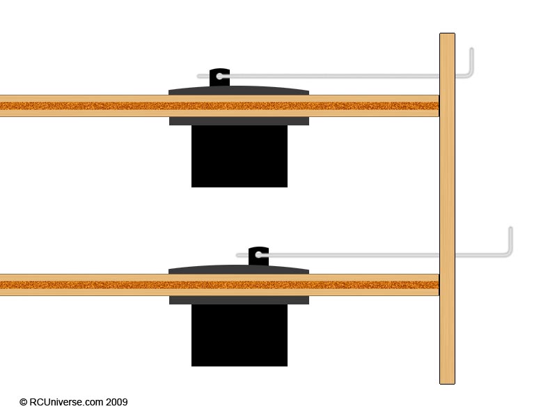

However, if that's what you want, you can just mount a regular switch inside, drill a hole through the lever and run a wire through it like the illustration below, or get one of these
