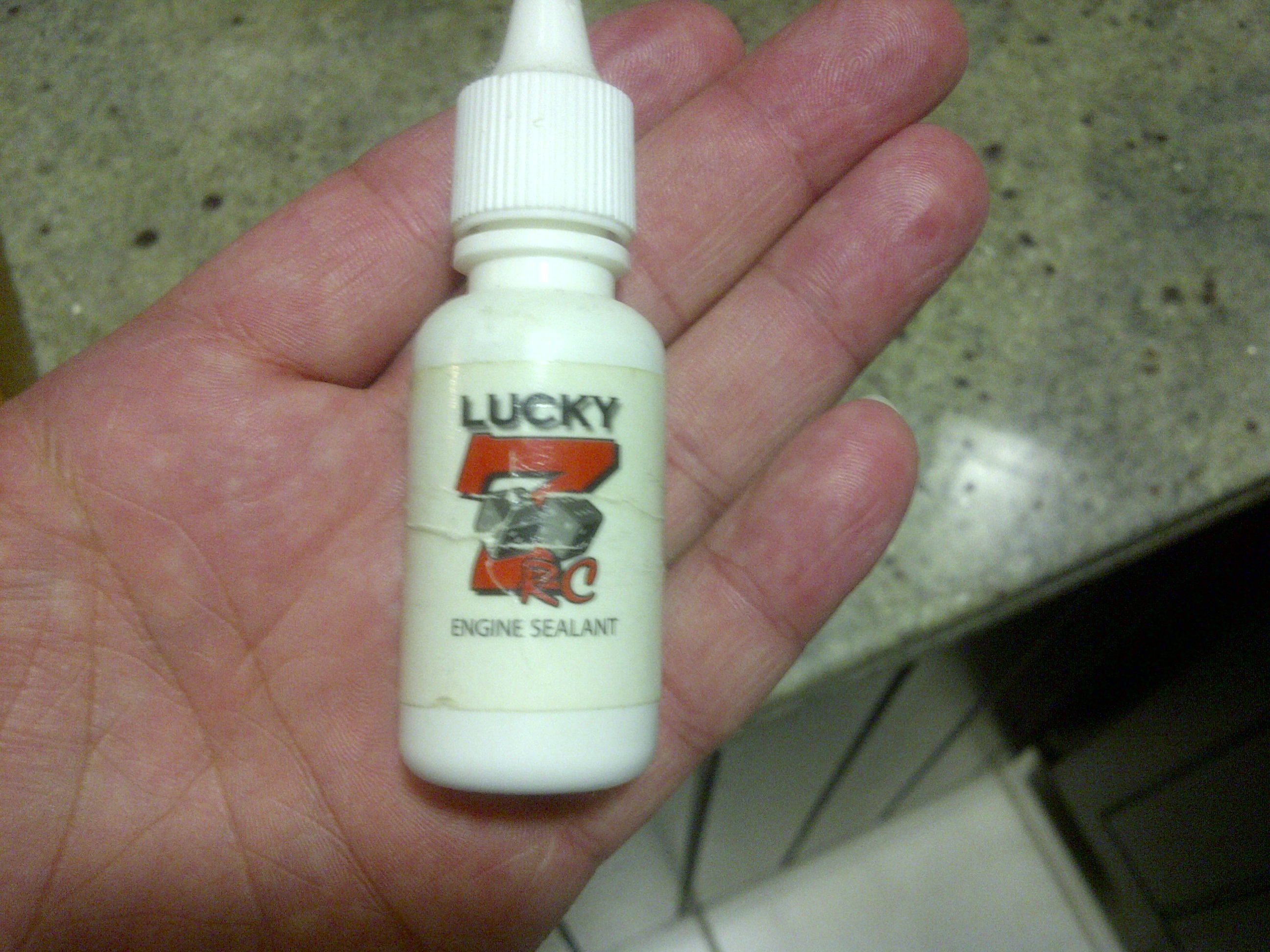

Hi Dealspeed.
Check this link to another thread here on RCU. About half way down the page you'll see a post with four pics of an engine that has been sealed up.
http://www.rcuniverse.com/forum/m_78...79/key_/tm.htm
I highly recommend Lucky 7. It's what a number of engine modders use...and that's good enough for me not to bother screwing around with anything else.
