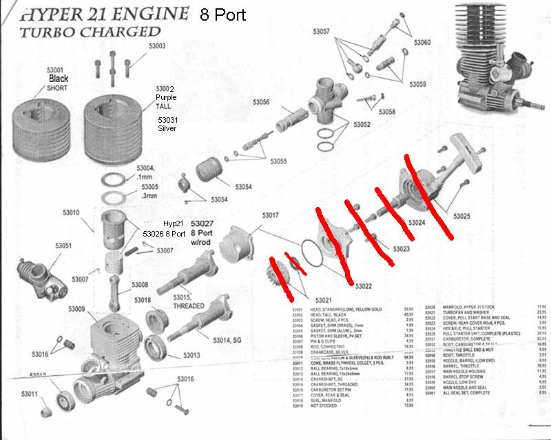

if you remove the pustart it will look like this
that shaft if lubracated by oil from the engine, if you run the engine with just the pull stat back plate like in this photo
The abvsence of that shaft in the oneway bearing will cause a major air leak
you want to leave it all on or take it all off and replace the back plate with a standard back plate part #53017

Here is what you have to remove in case you decide to go for a non pullstart backplate.I did the same to my buggy coz the pull start pissed me off.
