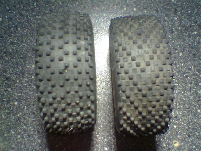

Yes, you will need the shock towers or you will loose negative suspension travel.
i might try the wd 40 thing or try and check what else would keep it of will do some reserch.
Space them out yourself:
