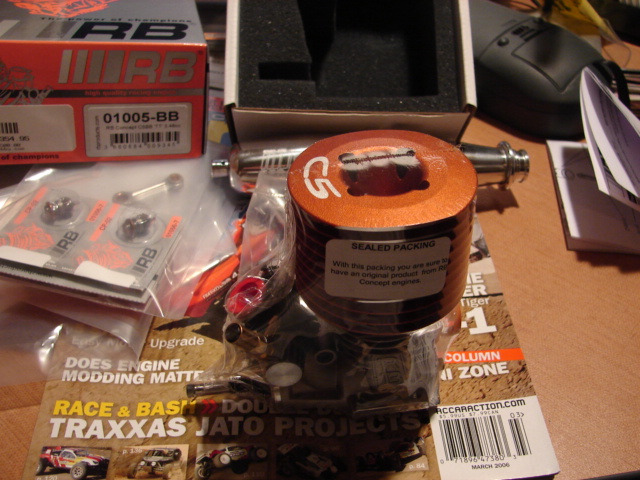

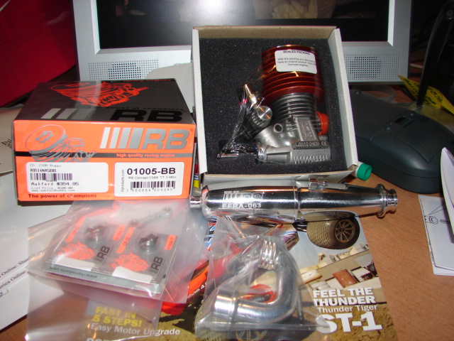

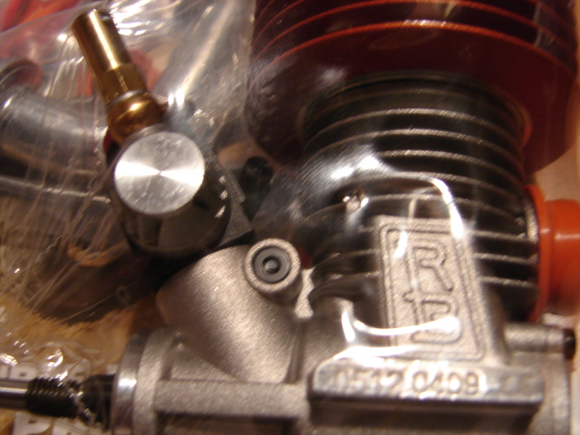

There is too much space for the top of rod on wrist pin. The true problem is that the sleeve and crank align. are off. If they were correct the rod would run-true(center) without grinding on the back-plate.-------------------check the pic's----I'm done with O.S.[:@]
ID:	390476   Click image for larger version
ID:	390477   Click image for larger version

YEA and I don't have to rebuild it and put new bearing's in it and watch the thing spit out metal and replace the Piston/sleeve and rod. As soon as I get info from O.S. I will post the results!!!

dooodd.
That looks like a monster. [8D]
