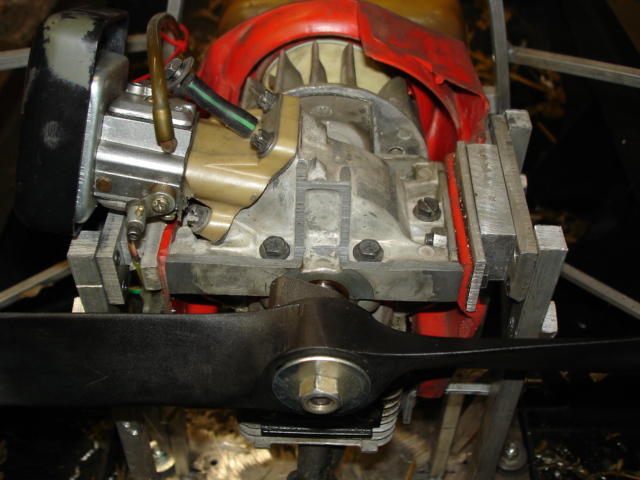

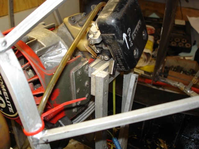

I went and bought some toys today. a new digital camera, a fish scale, and,..............a radar gun
. had to order radar gun online, but it was on sale with free shipping. $79.99
I also got the engine turned (pic 1) but it had a terrible glitch after doing so. had to sheild the throttle cable and ground it to the cage to get it to stop. (pic 2) *green wire* After I got the glitch solved, I went down to the water to test her out, I didn't take the camera along because it was raining. I hooked the fish scale to the stern and throttled up......anyone hazzard a guess on the pounds of thrust???
But it is with a heavy heart I say: "still won't turn right" [:@][:@][:@][:@][:'(][&o] *stomping feet-throwing things-having a general fit* soooooooooo I ran it in the hay field to make myself feel better. LOL
Maybe tomorow, weather permitting, I can shoot some video.

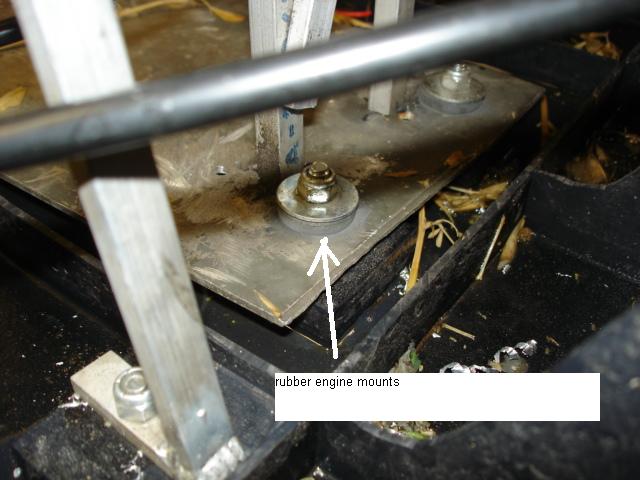

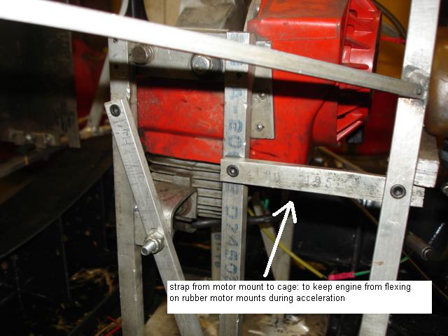

Is it possible teh rubber mounts allow the engiine to twist when powered up? If so this can change the orientation of the prop to the hull while under power. If the prop is parallel with the transom at low rpm's, then when powered the prop walks a bit causing the undesirable condition.
Try this. Keep the boat stationary, get on one side of the boat. Power the motor up and keep an eye on the prop. Notice if it moves in orientation.
