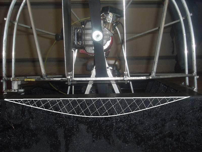

Well guys, here it is, the new boat. I WAS going to vacuum form the hull, I had everything made...molds, clamping devise and vacuum box. I did not have enough electricity coming into the house to make the heater hot enough to melt a piece of plastic 14" x 50" OH WELL!![&o] Anyway...the new boat has the same problem as the old boat...prop walk. The only difference is that the new one does it much WORSE[:@]. On the maiden voyage... everything was going and looking real good until I put her in the water, Got on plane real fast, and took a left turn with no help from me. I got her to go in a straight line by having the rudders turned all the way to the right. ( at full throttle ) ARGGGH !! WTH? I also tried a new prop, an 18 x 12 competition propeller. for some reason it has less thrust than the 18 x 10 prop. ????
Joined: Nov 2004
Posts: 1,791
From: onalaska,
WI
the engine is solid to the "a" frame but the connection between the hull and mounting plate are in rubber,
the engine does flex forward max 1/4 " under heavy throttle.
never mind the pointing finger in the right side of the pic....it's not pointing to anything

That a nice set up and looks good . You said it turned on its own ? MAYBE you have a metal to metal contact causing a radio glitch affecting just your rudder servo . You might not have enough rudder blade in the air flow making it not turn . MAYBE move the blades apart a couple or three inches and add a little to the height . Just some things you might look at .
Joined: Nov 2004
Posts: 1,791
From: onalaska,
WI
Thank you for the compliment. Picture this: I throttle up slowly, get her on plane,but still going slow. It will go straight at this point.
While moving slowly on plane...hammer the throttle and viola'.... left turn, all by itself. Glitching is non-existent, one of the first things I thought of. Mr.Cajun Gator: I will remove rubber mounts and see what that does. After going over the differences and similarities between the old hull and new hull, one thing stuck in my head.......could the problem stem from the prop swinging below the level of the gunnel? ( see pic ) That is the only thing that is constant between the two at the stern anyway. anybody have any thoughts on this?

i dont know much about air boats but looking at that pic,
the engine head is to the right behind the prop and that may be acting
like a rudder, becuase the wind cant get around it

a few things, first i always make sure that the engine is high enough that when the prop is as far down as it will go that it clears the back edge of the hull slightly that way no thrust is wasted and blowing into the hull and comming back forward(dont think its causeing the prop though) i doubt that the engine head being over makes a whole lot of difference either, is it strait with the hull, also you can turn it one way or another to counter prop walk, hows it point vertical wise, if its lifting the back to much it could be causing a spin id imagine. also higher pitch equals more prop walk, find something that the engine likes and go from there, this is also why you had less thrust it just didnt have the stuff to turn that bigger prop, i have a 16-8 on my boat but its smaller than your engine a little i believe maybe an 18-10 like you had or and 18-8 to help the walking. hope that helps a little, mine needs a bigger motor or smaller hull as its 40-20 and to much for a motor that swings a 16 incher, but it runs great on water(id like nore speed though) there are picks of it under a thread titled something like pics of my bigboat, i like it for water and snow though but it wil be upgraded when i get a chance(twaeking in my nitro vee at the moment)....
Banned
Joined: Apr 2005
Posts: 325
From: Santa Ana,
CA
My guess is that yes, the prop going below the gunwale is causing the problems. Look at it from the beam, with one tip hidden, (as like in a wheel well) it does not push sideways on the downstroke, while the other end does, while on the upstroke. I am pretty sure the high speed water screw boats that use 'surface drive' props...where only half of the prop is in the water... have to account for the one way prop walk. Can this be adjusted??
Sean
Sean
Makes sense to me, with the prop being that for below the gunnel. One way to check if this is the problem, get a small diameter prop, (I'm not saying to keep a small prop, just to test with).
I would not completely ruel out radio glitching, since the boat has a different harmonic, as the speed of the boat changes.
If you can install a water thight floor cut the transom down.

Here are some of the things I've tried {in order}(1). cut transom to allow full air flow,see pic. result: nada. (2) cut down an 18 x 10 prop to 16". result: not enough thrust to move boat on land, still walks on water. (3) mounted a 16 x 10 3 - blade prop, result: same as #2. (4) re-mounted cut down prop and turned engine on axis 12 deg. result: nada (5) remounted 3-blade prop and left engine turned on axis, result: snake eyes. (6) mounted the new 18 x 12 prop, returned engine to original position, played with the carb to gain some rpm, engine now runs up to full rpm with no bogging out, result: it goes really fast, but did not cure problem. (7) took out rubber engine mounts and made it solid, result: no change. I weighed her on a very accurate digital scale, she is 28.45 lbs. Is that too heavy? could the weight be an issue? It is a big hull, 48" long x 26" wide. It's heavy...ergo, I need a lot of thrust, lots of thrust leading to prop walk on water because of the torque needed to push such a monster?
Does ANYONE else have such a problem? Do you guys even have just a little bit of a problem with prop walk, or am I alone here?
Maybe a longer (not taller) rudder on the right??? I'm fishing here people, grasping at straws,, etc,etc,etc.

I agree with Hal... raising the prop would clear the gunwales, but would not keep the air from still being trapped there. clear the prop and cover the hull see what happens. Sean

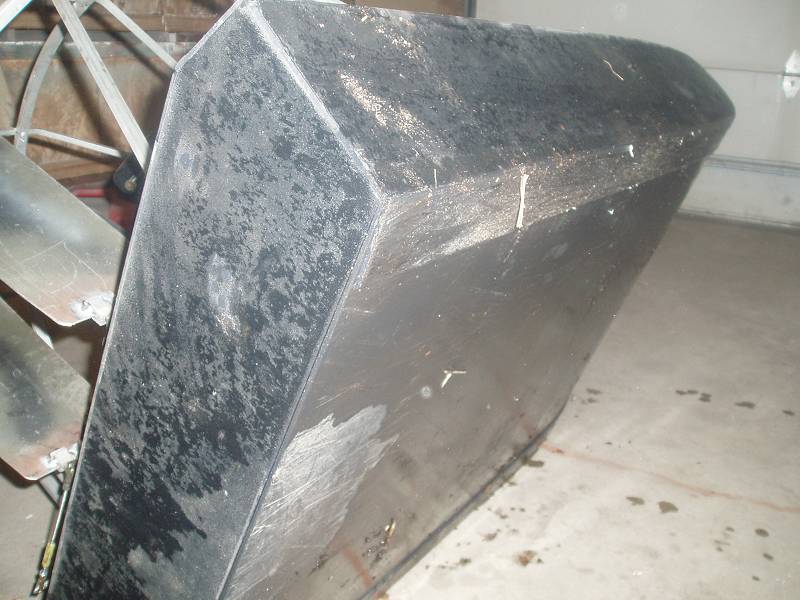

Thanks guys. I did extend the right rudder by 2" today, It had a profound effect on performance: It will now turn a little more than it did before...but it also makes the left side dig in more during the turn. I came across this pic on a website, I was thinking of trying to copy it. Although it doesn't look like it has the displacement to float.

On some of my hulls I use bottom runners, as long as they are true to the center line of the boat it will not give any problems. Bob Smith Inds. makes a good 2 part epoxy(the only brand I use).
Tip for building with plywood, make sure that your work bench is completly flat. If your work bench is twisted so will be your boat.
You have a pretty big boat. A lot of the boats around here are much smaller and lighter and a layer of fiberglass on the bottom is sufficient protection from abrasion when ground running.
You might try removing the wear strips. If that solves the handling problems on water, try adding temporary skid pads to the bottom for ground running. I did this a while back to run my coro boat in the street (no fiberglass on the bottom). I just duct taped a strip of coroplast to each side of the bottom of the hull. Worked great!
